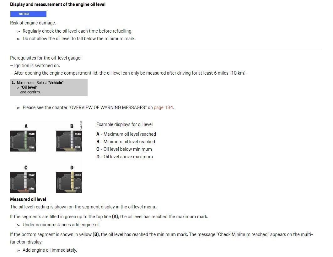

Checking oil level on Panamera (and similar gen Porsche cars):
You can see how much to add, and how much is in the car after driving at least 6 miles (if hood was opened for any reason). See pic below to tell where oil is.
Each segment is equivalent to ~250cc, or 1/4 of a quart, or 1 regular size glass 8oz.
Owner's Manual for reading: Page 108:

when you say computer, do you mean PIWIS2? The car itself has a computer, commonly called the ECU, and keeps track of levels.
The car itself shows you pictures like I attached above.
If the level shown after driving at least 6 miles is at the minimum (yellow, or pricture C from above), you would have to add at least 1 quart.
Each of the 4 divisions is about one glass or 250cc or 1/4 quart.
Once you add what you need to get to the top of upper most square, you close the hood, drive for at least 6 miles, then check in the car (even if car is moving).
Then, you will know how much more to add. If you overfill, it will let you know. Then you would have to open drain plug a bit to remove excess.

Porsche designed this display, so that owners can have proper level of oil in the pan, without having to go to the dealer to check it for them.
Otherwise they would have stated that to check oil one must go to dealer, and connect to PIWIS2, for a check. This automatically means nearly $100 to do at leader.
Maybe mechanic has some base to say so, but I would disagree with him saying disregard the display. It is designed specifically for owner to have proper level.
I think you should follow what owner manual says. Your car and $ though.
