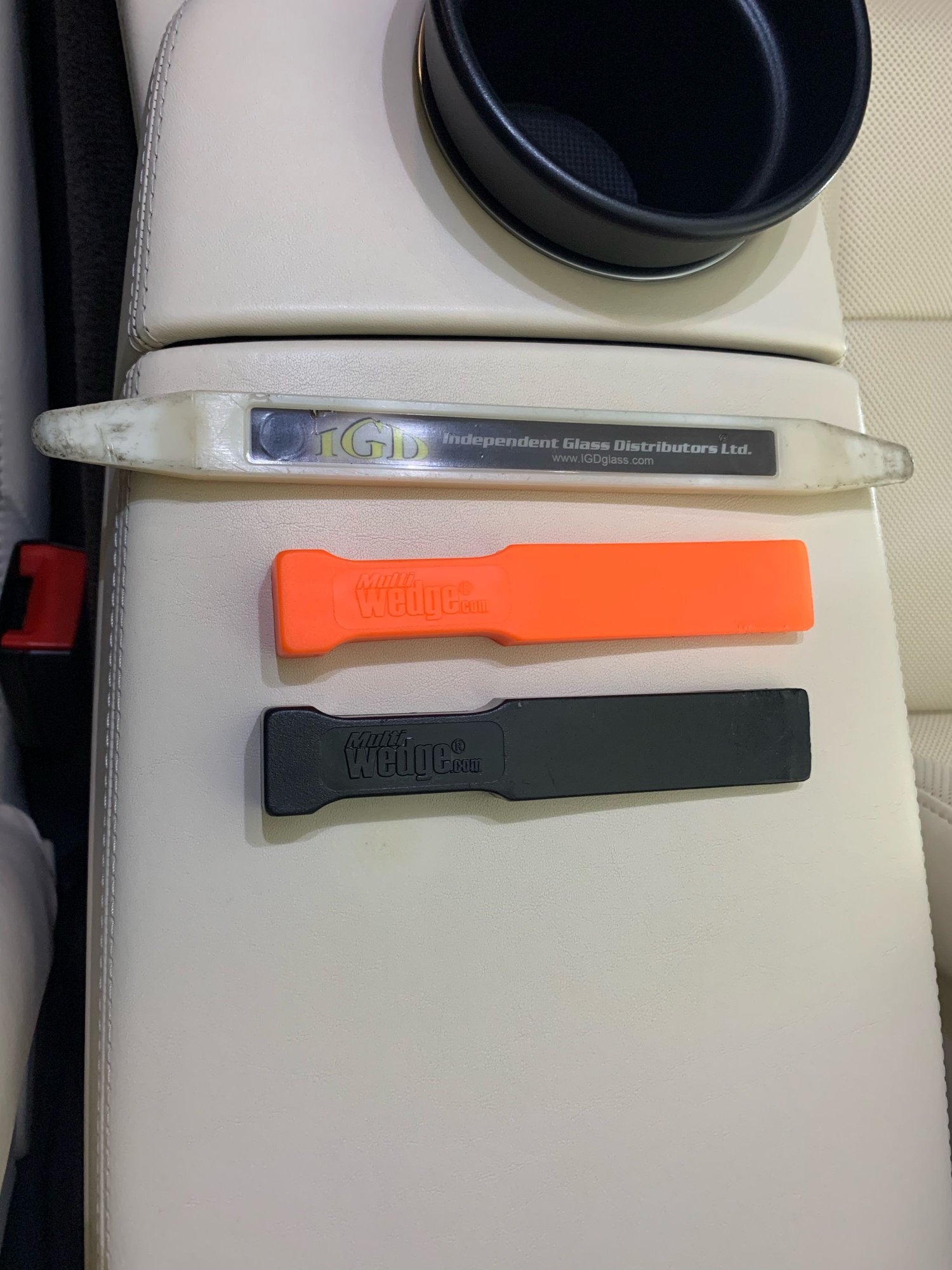

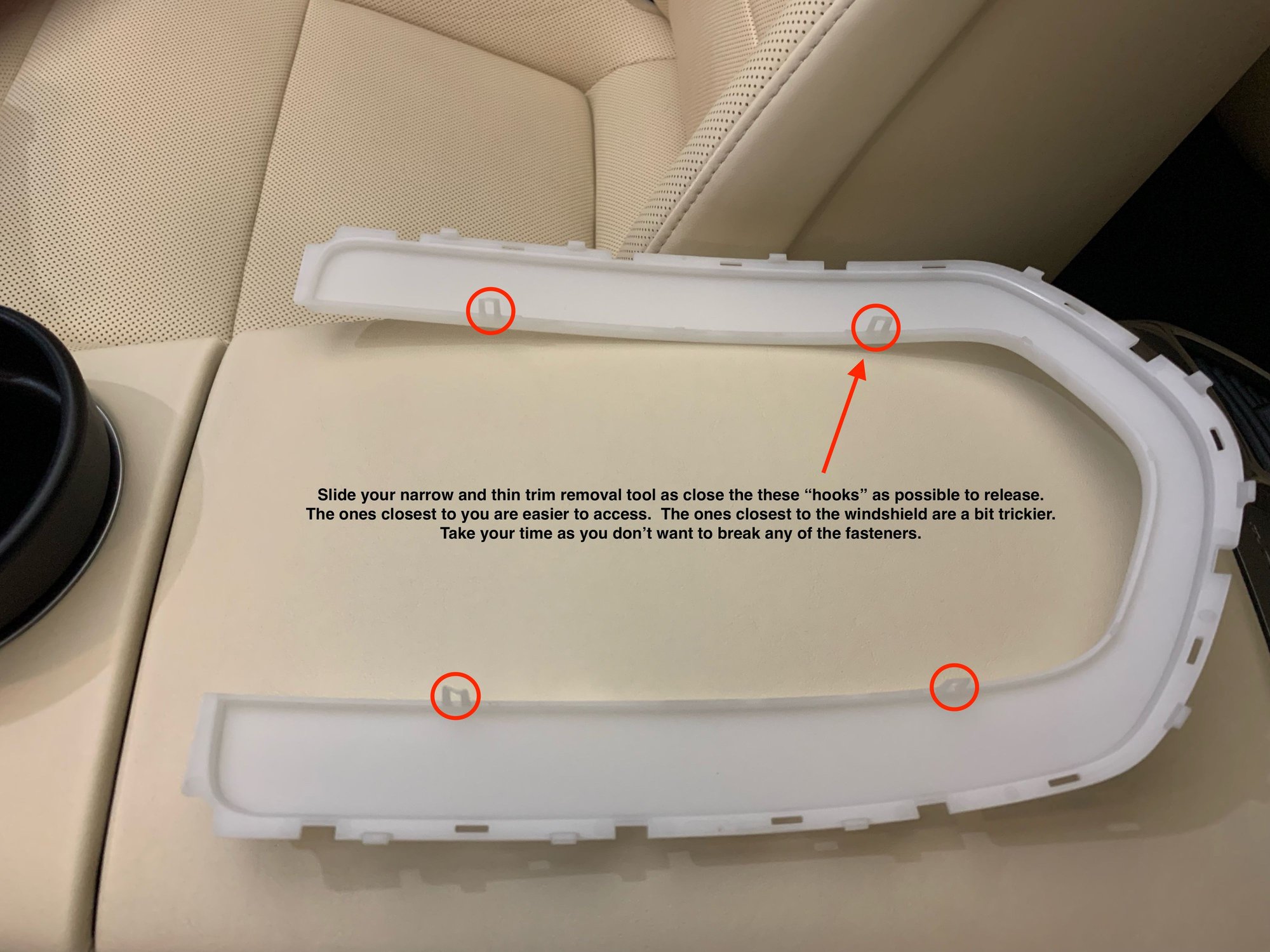

The dome light scared me the most (based on my forum post reading) and is the reason why I took so long to get around to doing this mod. In the end I figured out a way to do the dome light WITHOUT having to drop the entire unit! You MUST use a thin and narrow trim removal tool. I liked the white one in the pic below but I had a few on hand.
1. Remove the dome light trim. Start at the side closest to the windshield and work carefully and slowly towards you using the trim removal tool to gently pry the clips free. You don't want any of these clips to break.

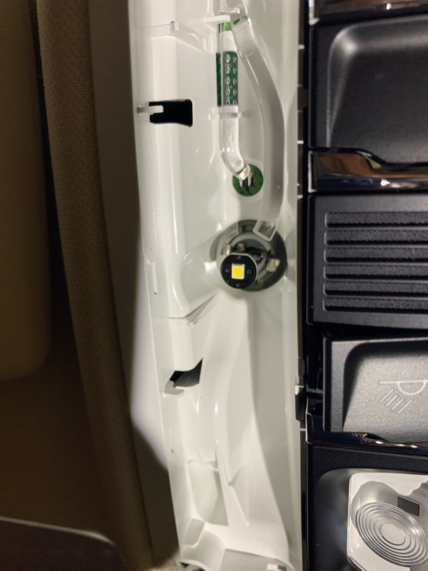

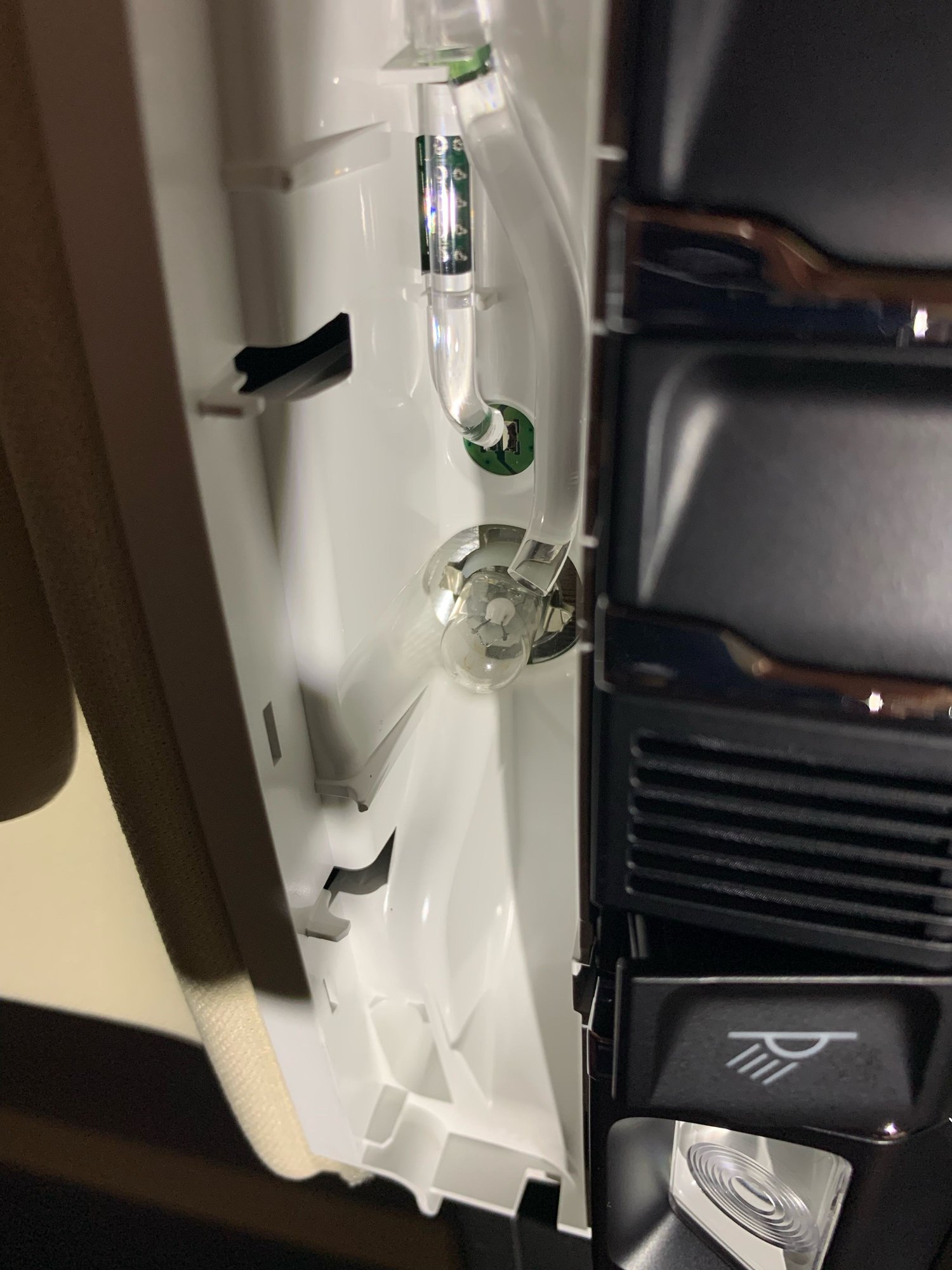

2. CAREFULLY remove the white plastic trim attached to the dome light. Look carefully at my pic for the location of the fasteners. Start closest to you using the trim tool. Work slowly and carefully. There are 4 clips along the "inner" side that you need to release. The 2 closest to you come out easy. The ones closer to the windshield are more difficult. Slide your trim tool as close the the point of fixation as possible before levering down. It took a fair amount of force for these to remove. Once this trim piece comes out you have direct front-side access the bulbs without needing to remove the whole dome light to get the bulbs from behind!

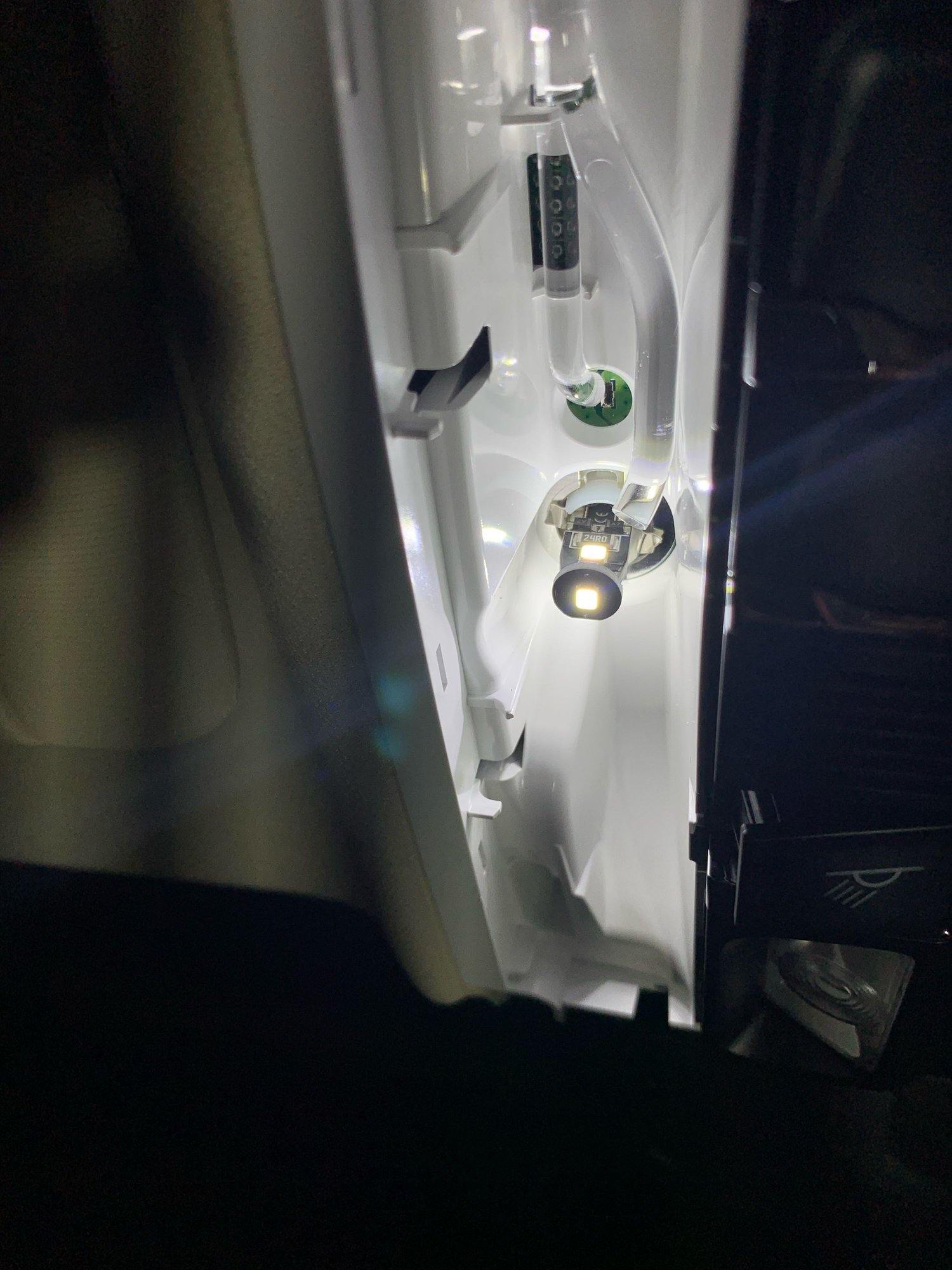

3. Pop our the incandescent bulbs and replace with LED. Assembly is the reverse but work slowly and use your trim tool to gently pry the clips (especially for the white trim piece) back into place (don't just try to push and force them back).

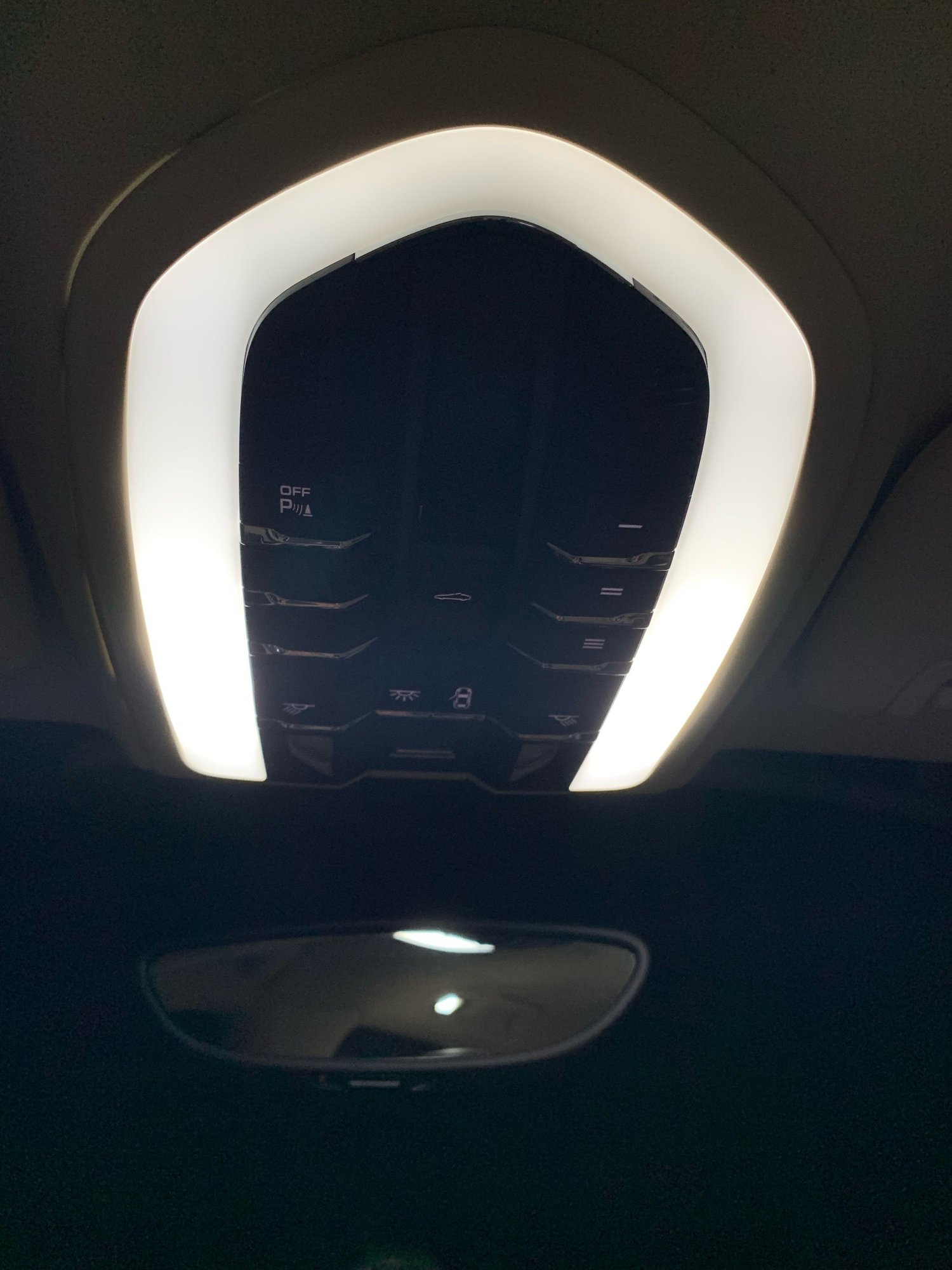

Here's are pics of the incandescent bulb vs.the LED when illuminated:
Overall, I took my time to do this mod. The dome light was ALOT less scary than I had imaged and you do NOT need to drop the whole dome to get to the bulbs. Hope this helps others!

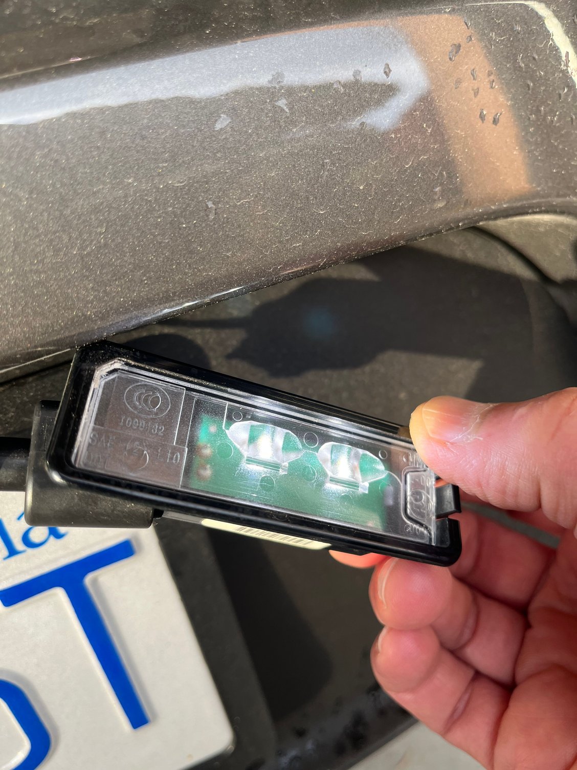

Another follow-up. License plate bulbs between 970.1 and 970.2 are different. People have posted about upgrading 970.1 license plate bulbs from incandescent to 36mm LED festoon. My license plate bulbs are an LED unit so nothing to upgrade. Part number is 1K8943021C. Glad I checked before ordering bulbs!
Here are pics from my 2014 4S.
Still trying to figure out how to get more reversing light…thinking that supplemental LED bulbs from Oznium are the way to go as posted by @970gts .
