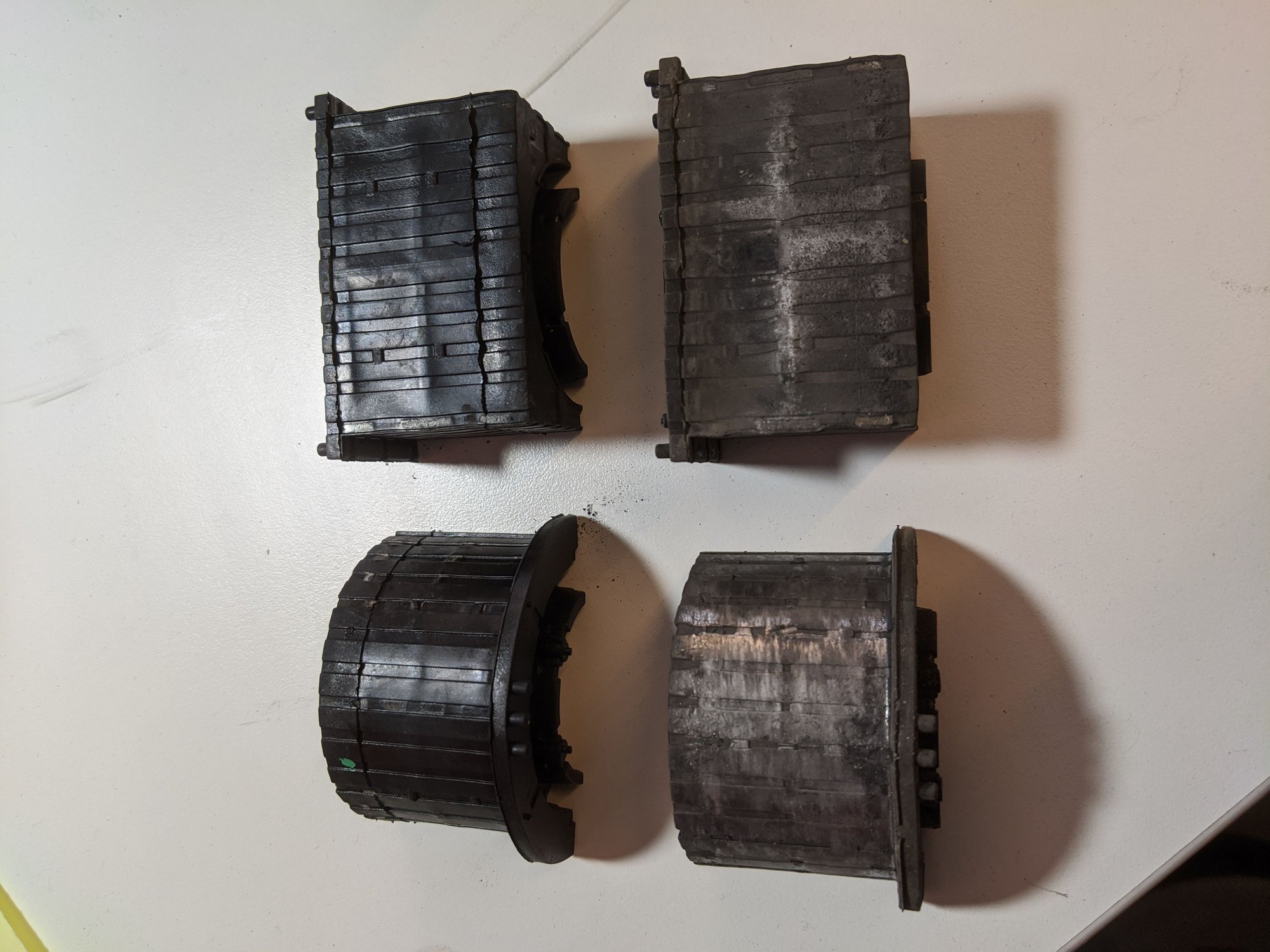

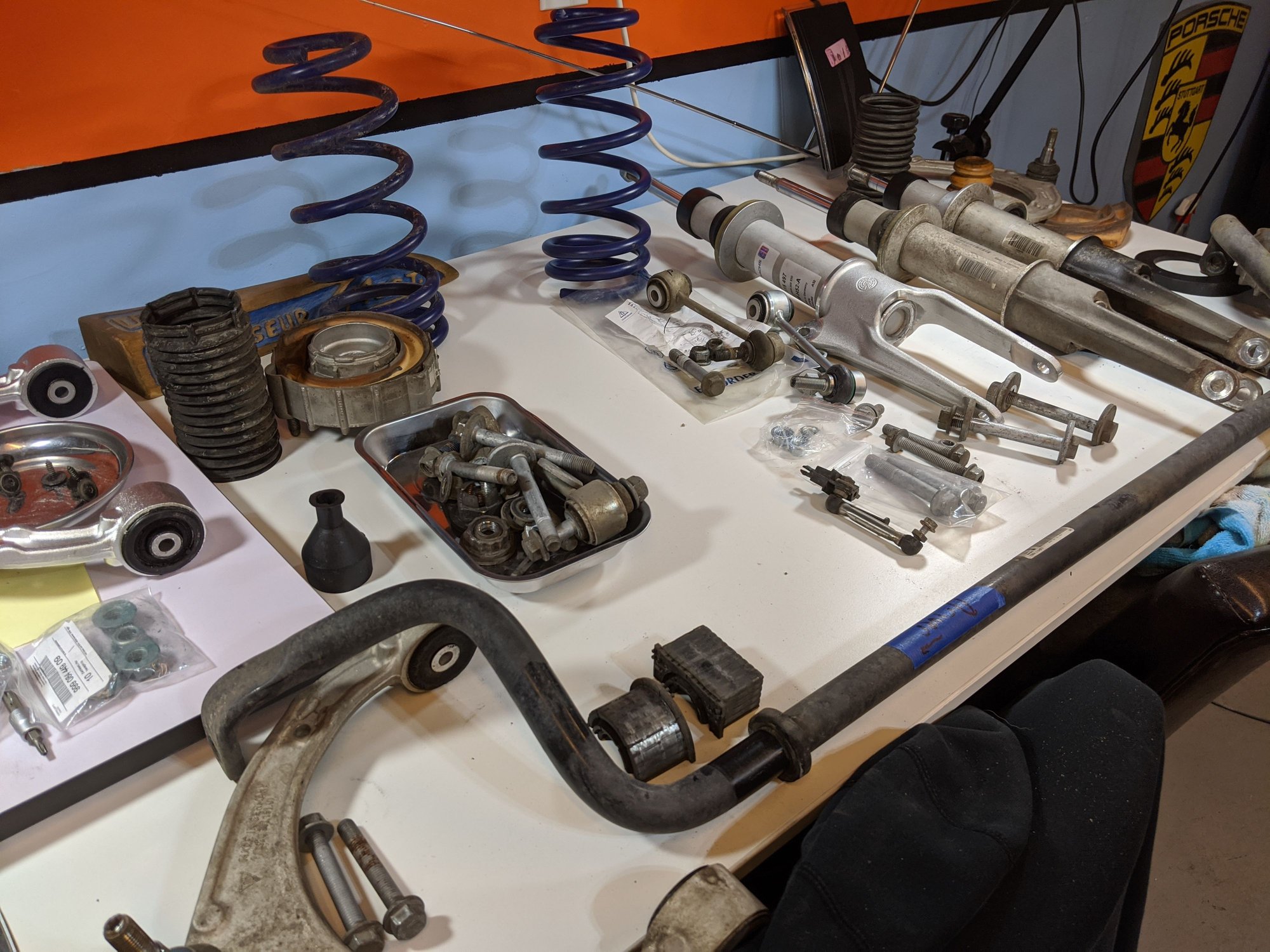

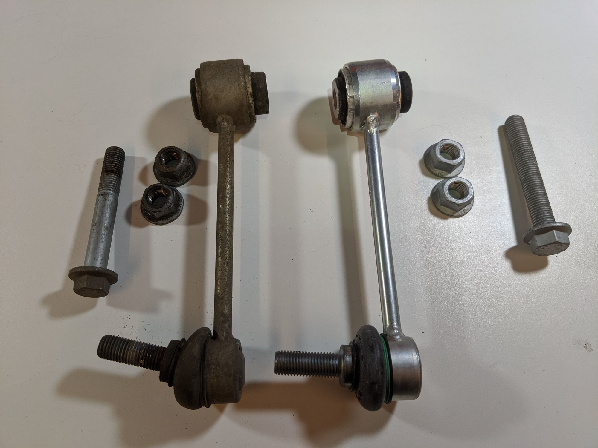

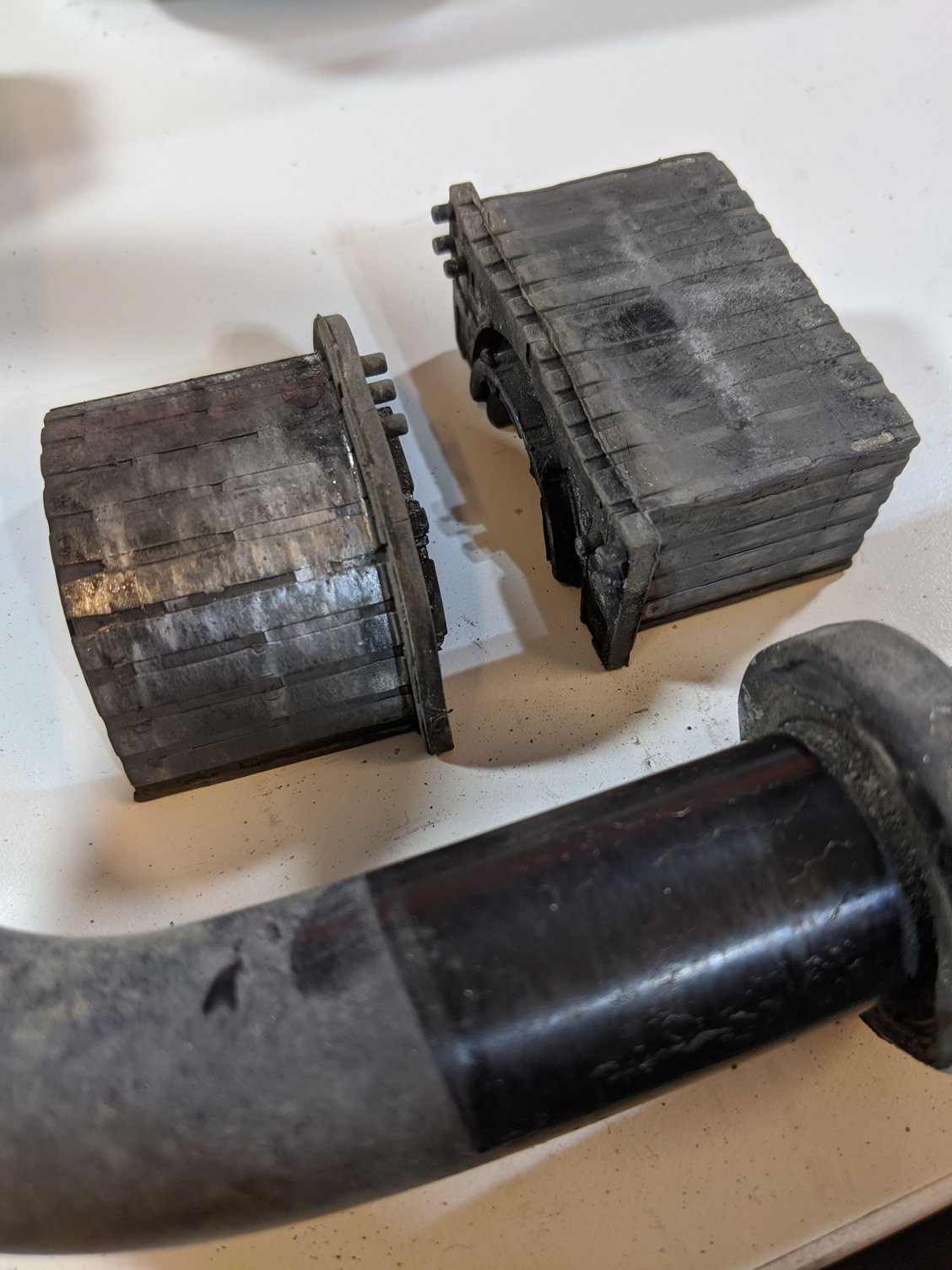

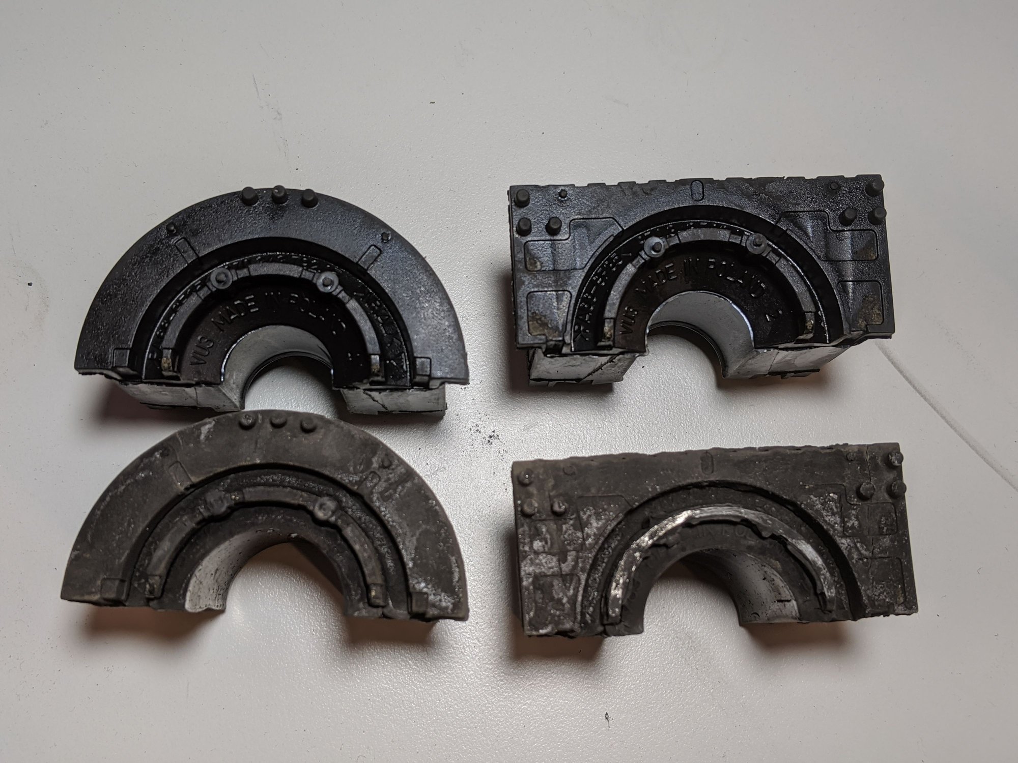

Just got the front suspension off our 2012 Pana4. Had a squeak and a leak. Knew the strut was bad, but decided (thanks to this tread) to replace it all while I was under there. Not only were the struts bad, but the upper control arms had a torn boot, the lower front bushings were torn, and the sway bar bushings look really bad.
New struts, drop links, bushings, upper and lower arms, strut mounts, and a few nut and bolts ended up around $1700. Will post more pics when done, but wanted to thank all you talented folks on this board.
Bill
Old stuff out...
Had to pay $125 to have the 2 new bushings pressed in...!
Passenger side strut was blown.
New drop links.
Upper control arm was damaged.
Swaybar bushings look bad, but I am not an expert. New ones going in anyway.

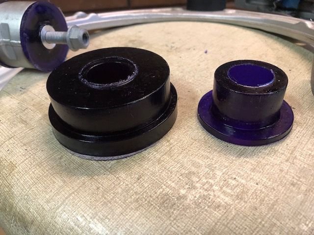

Creating some polyurethane bushings for mine, upper arms and both lower bushings, thinking about doing the third bushing as well

Just got the last items in, and the sway bar bushings are a different size. They are the correct part number though. Wondering if I am supposed to squish them down enough, or do they need trimming??
Thanks in advance!
Old Mar 23, 2020 | 03:13 PM
DogWood's Avatar
5 Year Member
Joined: Apr 2018
Posts: 935
From: Bend, Oregon
Rep Power: 47
DogWood is infamous around these partsDogWood is infamous around these parts
my understanding is that you'll just squish them down when you install them - I purchased the same ones I believe

Yes new ones are very tight.
I put red rubber grease on mine too (as that’s what the OPC recommended using).
