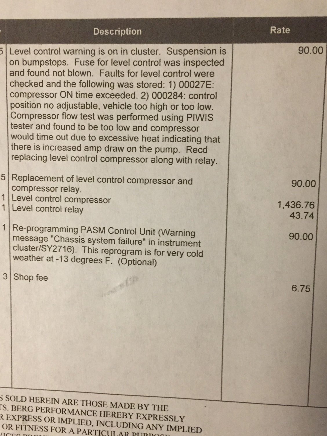

when I replaced my compressor last winter after extremely cold conditions (it was original) I had an option to make it work at -35 degrees for like $300 extra so a no brainer. Is this an option for you? I figured it’s worth peace of mind as I’ll be driving it to Canada this winter for a heli-ski trip and don’t want to be stranded in the boonies.

My Indy told me there was a software option for the compressor (rev G?) that protected it to extremely cold temperatures so I went for it since I was spending $2k already for the replacement. Check with your mechanic he should be able to track this down for you. Good luck Lou!

It seems that Porsche has gone thru at least 7 design iterations trying to make this system more reliable. Mine was replaced in January of this year so maybe the latest is beyond rev G? I sure drove in plenty cold weather conditions since the replacement and so far so good!
Traveling overseas currently so no access to my paperwork but if further details are needed I’ll post upon my return.

I checked my paperwork and the option I chose was to reprogram the PASM for a $90 fee which offers protection down to -13 degrees F. I don't see the details of the part revision but I remember my mechanic telling me it was the original compressor w/ P/N "A" and the new unit was version "G". Here's the info for those interested:

Relay (small black square in trunk) is what turns on compressor after ECU tells it to turn on.
New relays were made to change voltage.
Your car showed compressor overheating.
I do not see how changing program makes it good for lower temp. Other than making it work for shorter time. Shorter on time reduces heat, preserves compressor parts, not protecting to lower temp.
Hard to tell since no explanation.
