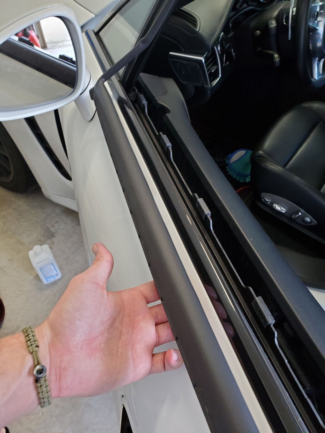

Shortly after skiracer13 posted I went ahead and took the door panels off and installed the moleskin. Overall it's a pretty easy job, just gotta be careful and I've gotta hand it to Porsche because the door panels are crazy simple to remove; -5 points for not having felt/moleskin on the rubber in the first place, but +10 points for how easy it is to remove the door panels.
Some pics:

Welp tintprotector.com is where I got it and it comes with very detailed instructions. I went to YouTube for door panel removal vids and the 2top vids are perfect (1 for front door, other for rear door). If you've ever taken the center console out of any car, you can do this job. Be sure to use those polymer trim removal tools and you're set.
