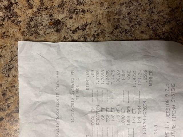

Originally Posted by Mod2Fame
Yes Mike you are right DA plays a major part in that time. It was really low but what was your MPH at 11.4?
124. This was with a bad 60’ my usual 60’ at the track is low 1.6 even 1.5, my car has been acting up I’m going to try some things out with it like normalfellow suggested and I’m adding trofeo R tire and a GT3 throttle body.
