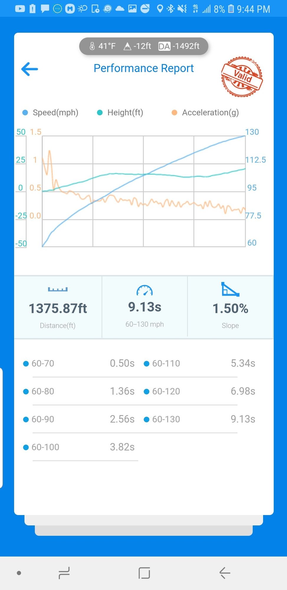

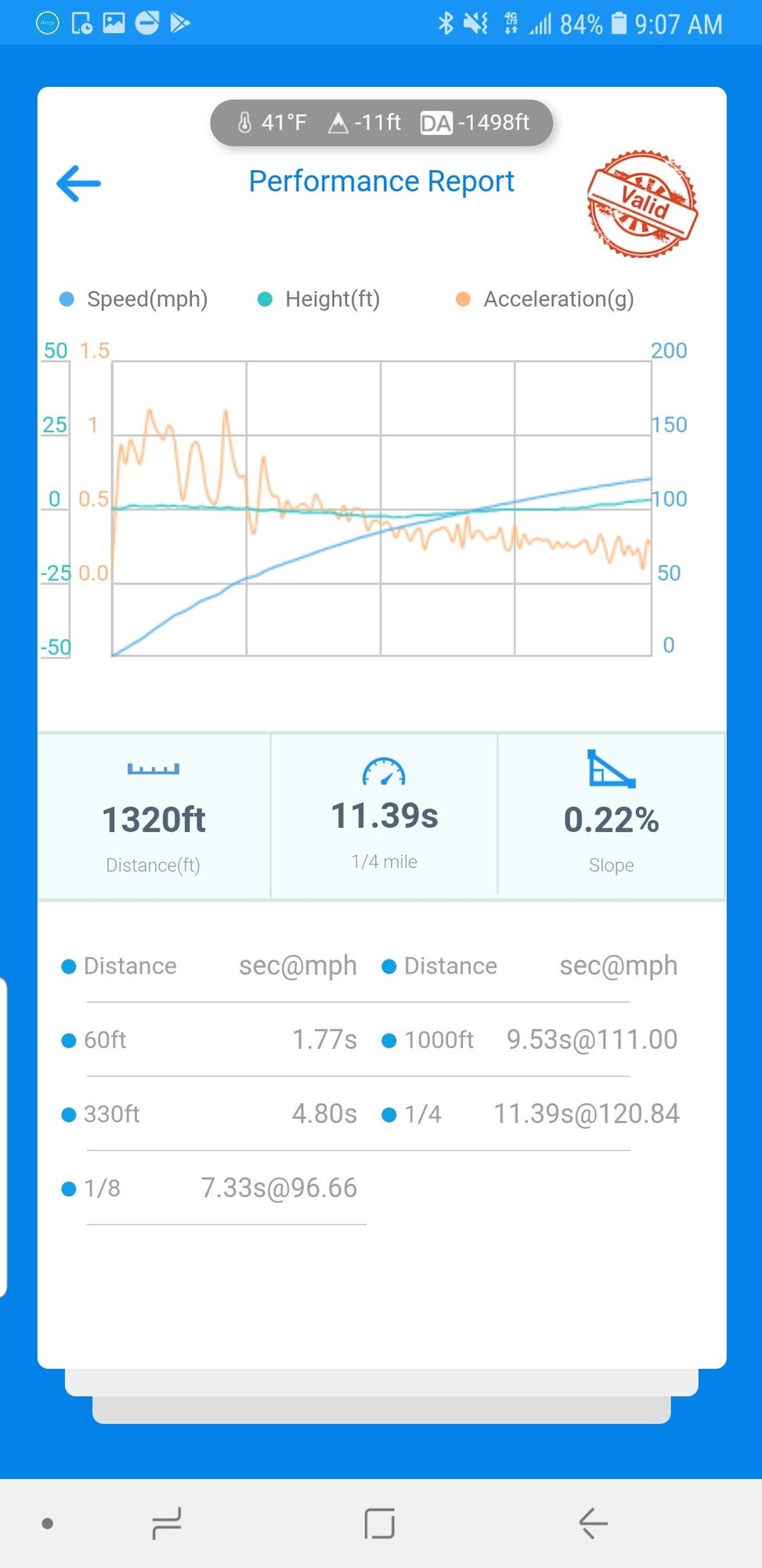

Attached are my best Performance data metrics so far which show the additional power added:
0-60 = 3.4 sec
1/4 Mile = 11.3 secs @ 121mph
60 - 130 = 9.1 secs
These are numbers on the street which is a non-prepped surface. I suspect that when I visit the drag strip we will see a 0-60 in 3.2 sec and a 1/4 mile in 11.2 secs with nothing but a piggy back, catless downpipes, and a BMC filter 😳. I'm going to the drag strip tomorrow if open.

My times after tire change but before chip install so down pipes and filter only:
0-60 : 3.7
1/4 Mile : 11.8
So you are right I shaved time with the wheel change but the piggy back pushed it that much further. I was impressed to say the least
