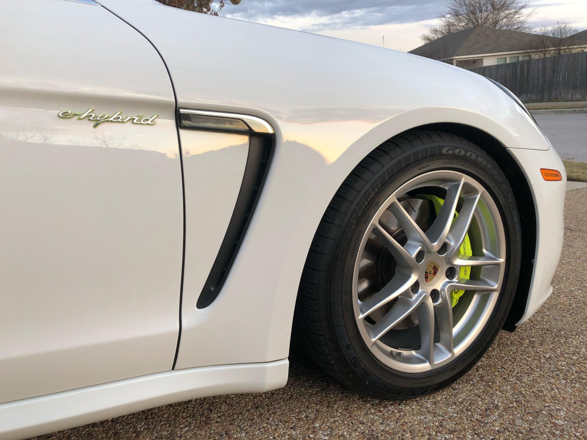

How is the blinker/marker light on the fender behind the wheel removed? I’d like to remove the plastic vent piece too. I’m wrapping the car soon and the removal of these two things will make things much easier.

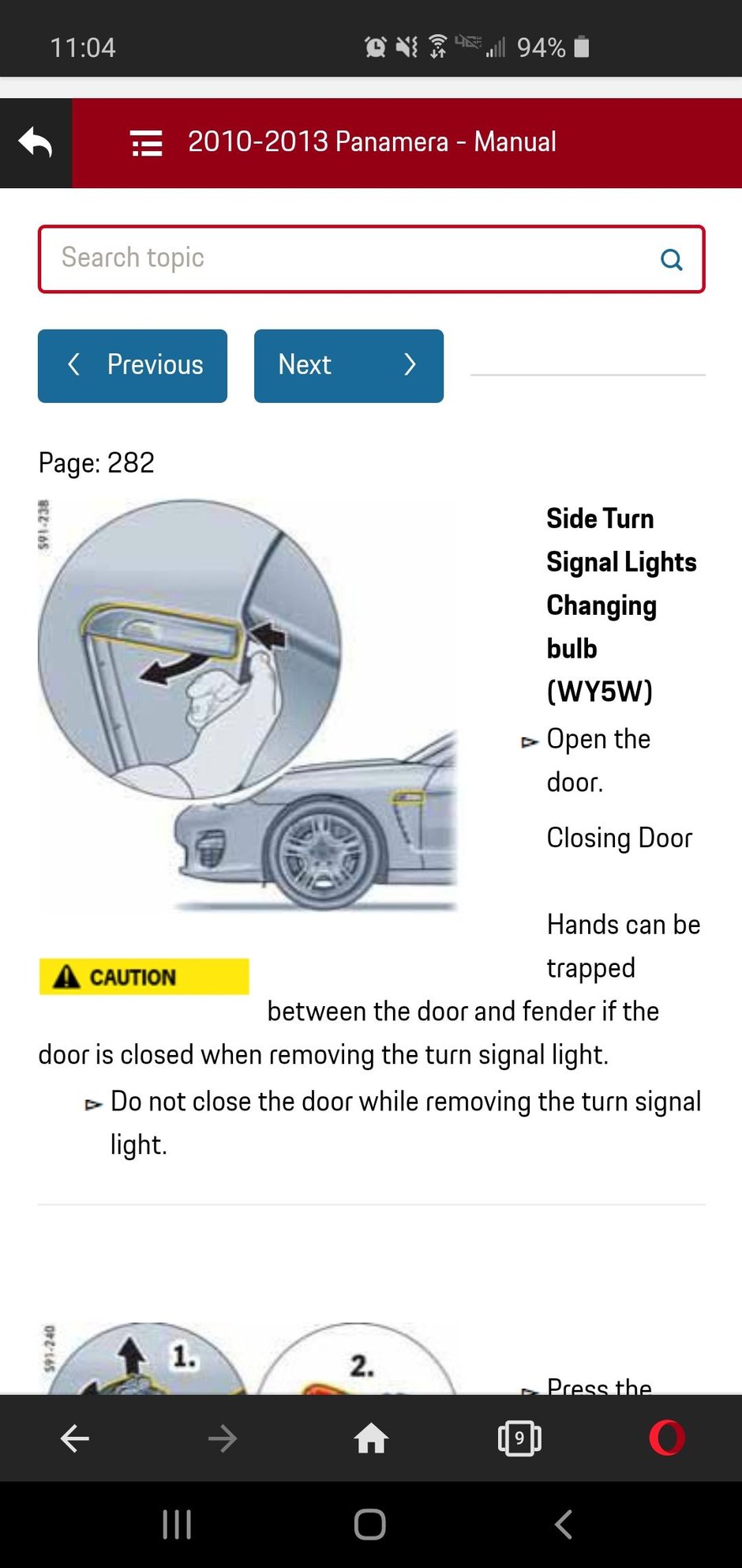

Not sure how to remove the vent part, but if you open the door and look in the gap between the fender and door, there's a place to apply pressure on a tab that secures the actual light in place ...
http://www.porscheownersmanuals.com/...ging-bulb-WY5W
