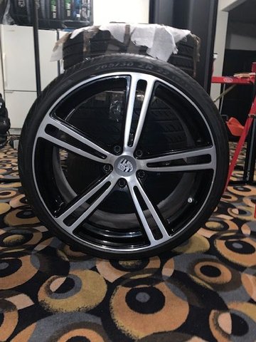

Good morning ciaka! I picked up a set of custom Modulare B35 wheels a few months ago. A guy from your neck of the woods (Dallas) had them made for his P-car. He then up moved onto a 911 Turbo so no longer needed the wheels. I've yet to install them and they are sitting in my garage for summer time!
I just checked...unfortunately the rims aren't stamped with size, width, or offset as they were custom. The tires are Pirelli PZero Nero GT:
FRONT: 265/30/ZR22 97Y
REAR: 315/25/ZR22 101Y

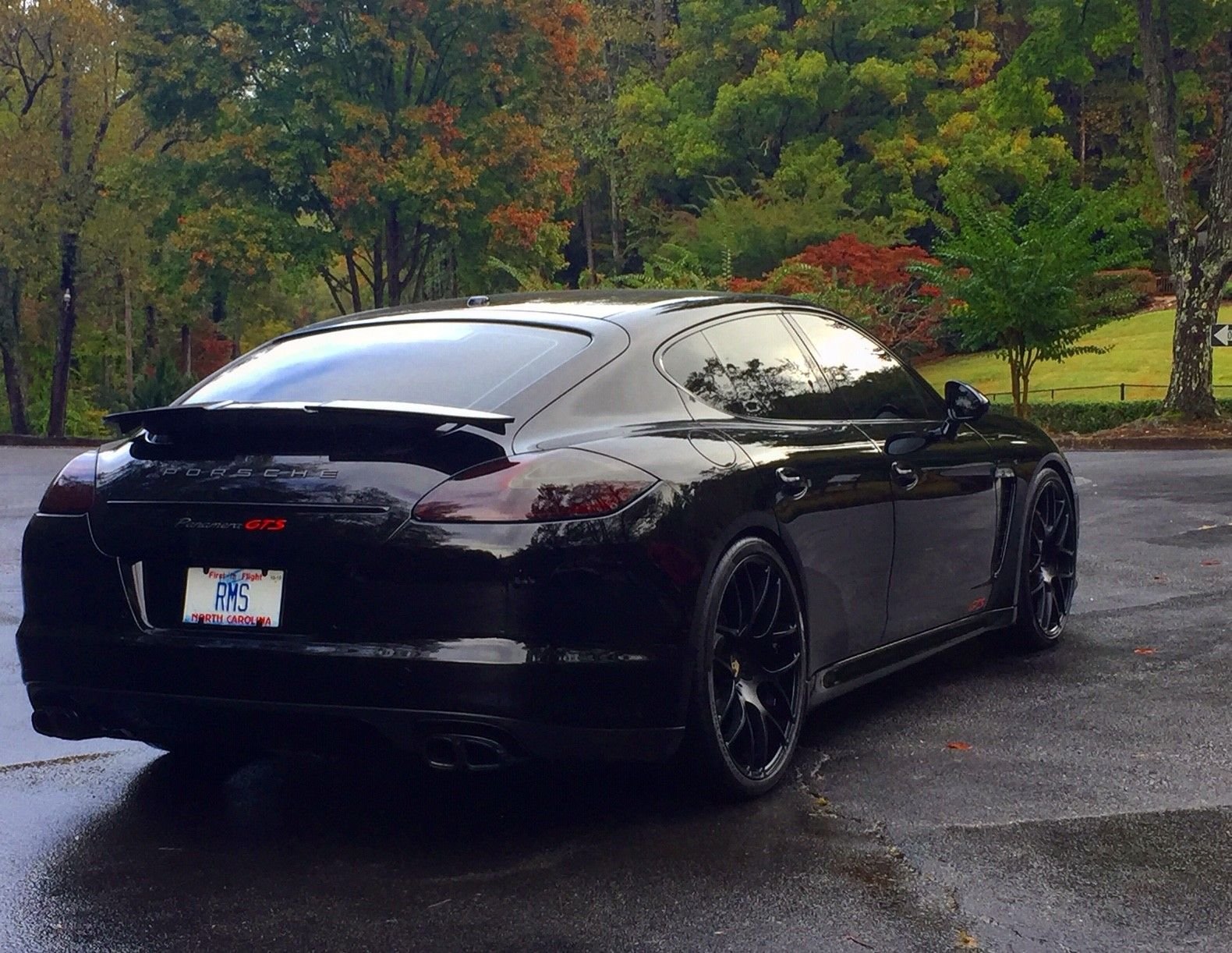

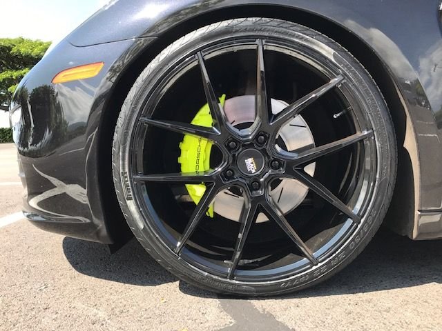

So I'm running 22" Savini Di Forza wheels on my GTS and here's the set up:
22x9 Front, +40 offset
22x10.5 Rear +45 offset
Tires:
Pirelli P Zero Nero GT's
265/30/22 F
315/25/22 R
No rubbing - ever. And the GTS is a bit lower than Turbo's so you shouldn't have any issues if staying within or around these specs. Hope this helps.

That car looks great, love the color. The rims fill the well perfectly too. Probably why I am starting to wonder.
