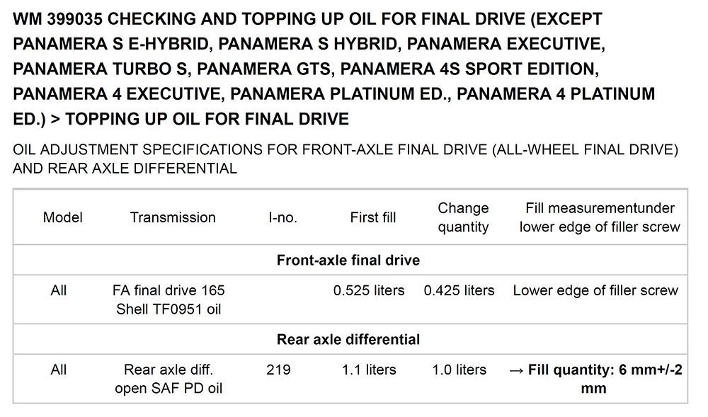

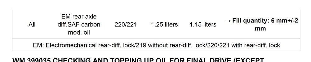

So did a little more research. According to the Porsche Service manual
I also found a @ciaka posted on another site confirming the part number:
was just able to confirm that Porsche Cayenne Turbo 2003-2006 uses same part number for gear oil.
Porsche PN for Cayenne Turbo differential oil: 000 043 205 30 - 75W90
Porsche PN for Panamera Turbo differential oil: 000 043 205 30 - 75W90
I also looked at Red Line (ran it in my EVO and loved it) and they appear to support that specific part number + the specific SAF Carbon Mod and SAF-PD the diffs need. I think this is the one I'm going to go with unless I find something more compelling.
https://stmtuned.com/products/57904-...-gl-5-gear-oil
Here is the official red line site: https://www.redlineoil.com/75w90-gl-5-gear-oil - click on OEM comparability.
Not 100% sure if that is what everyone says by "Porsche Spec" but seems pretty accurate. Looks like Castrol and a few others have SAF CArbon Mod/SAF-PD complaint 75W-90 GL5+.
