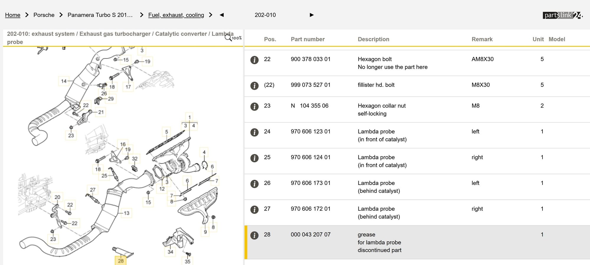

Hello Everyone -
About to replace an O2 sensor before attempting 80k service w/ Plugs, Coils, Filter & PDK fluid - I thought I would get this done first as durametric shows Bank 1 Sensor 1 is problematic.
I ordered Part 970-606-124-01-M14 - can anyone help confirm this is bank 1 sensor 1 and also, confirm which O2 sensor this is (drivers/passengers - front/rear)? I ask as I have found conflicting info online and parts specialist seemed to be confused as well - I hurried order through in advance of being 100% sure so I can get this done ASAP and am hoping it wont be an issue.... Also - is this something that a standard mechanic can be trusted to do? Specialty Indy + Stealership have quoted absurd prices and I dont think I am capable of doing this myself - please help!

That is the pre-cat, right side, so it's for bank 1. Go ahead and get the sensor for bank 2, and do them both. 970-606-123-01. Sensors should always be replaced in pairs, and they lose their sensitivity over time. I replace them all around 50k.
Any shop can do this work. Heck, anyone that can fog a mirror can do the work if you have an O2 wrench, which you can rent for free from Autozone. Edit: If you yourself are going to do the plugs, and PDK filter/fluid, you can definitely handle the O2 sensors.

oh no! - does anyone have part numbers for all 4 sensors?

P.S> O2 sensors parts numbers, just in case (for 970 with Engine Code 4870)
