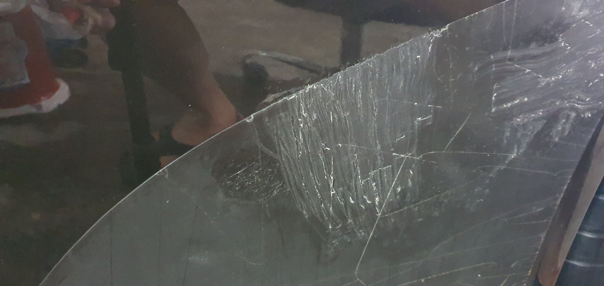

Hi guys, I didn't want to start a new thread but I searched around and couldn't find something which really tackles this issue I have with the Pan 970 stoneguard. I searched YT videos and Pelican Parts DIY's on this. When you read about it or watch it on YT, removing the stoneguard is like a walk in the park. So, enthusiastically and confidently, I purchased an eraser wheel and started working on removing the old stoneguard on my Pan. TI've realized that it's not that easy when your stickers and as well as your car is 10 years old!
Is there any EASIER way to remove the old cracked stoneguard? Oh by the way, I ordered the replacement stoneguard stickers off ebay from a guy in Lithuania. They seem to be better than the original ones. Going back to my issue; do I apply some chemicals first before I work on it with the eraser wheel? Heat gun probably? GooGone? WD40? Im worried that if I use heat gun, it would melt my paint off. Any advise from you guys who have probably done this would be greatly appreciated. I've attached a picture of where I decided to stop doing this PITA job for the moment until I get some suggestions from someone who as actually done this job. TIA!
Im at 10% and decided to stop this PITA endeavour!
done this. TIA!

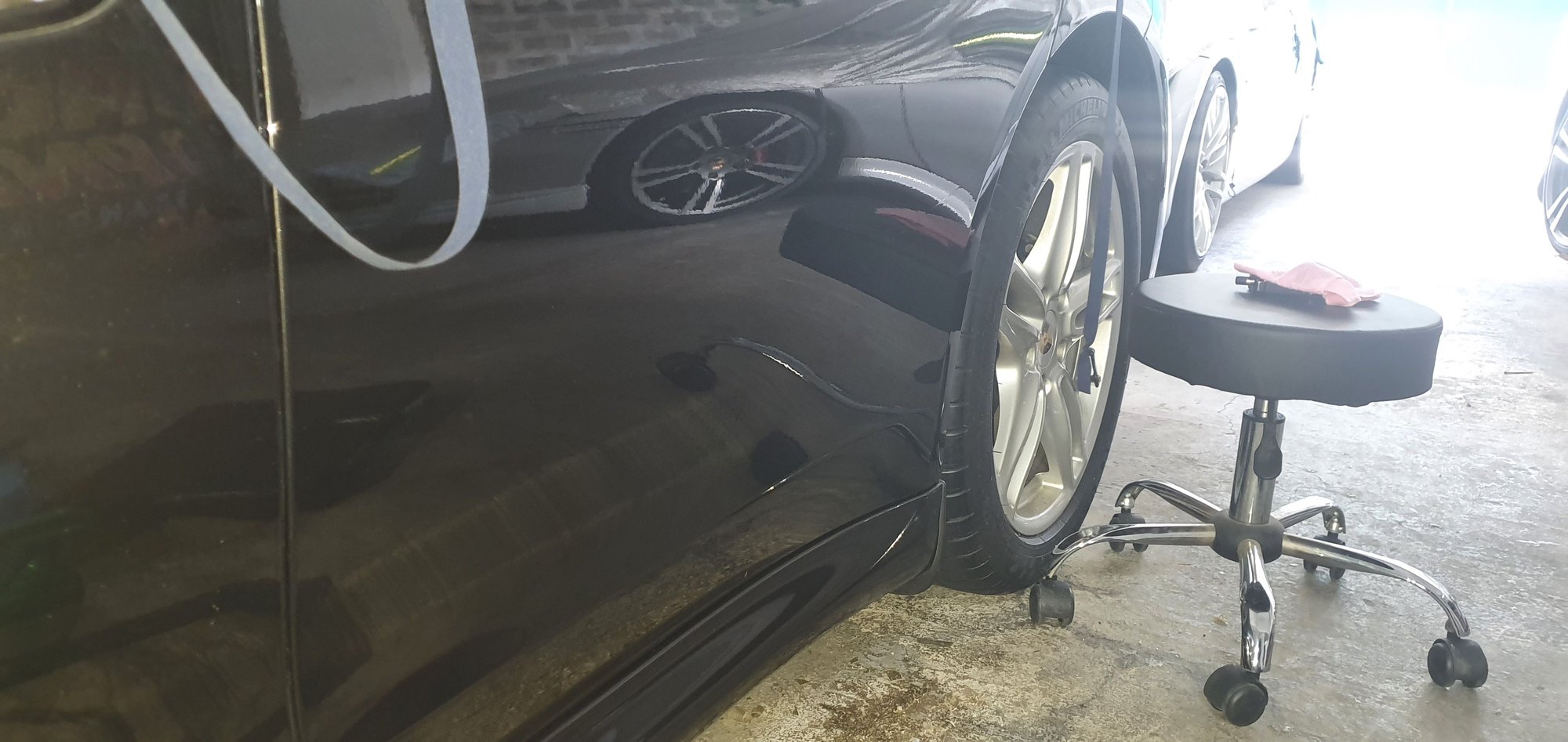

REMOVAL OF 12 YEAR OLD STONE GUARD and INSTALLATION OF NEW AFTERMARKET STICKERS (NON-RUBBERY TYPE)
1st of all it’s been nearly 2 months ago when I started this thread. Just wanted to tell everyone that I’ve finally finished this project. It’ took some time to finish it because I had to..1) wait for the tools I ordered online, 2) I did the work by piecemeal on this and 3) lastly, because I really took my sweet time. I’ll tell you more why later on.
OK! So I’m gonna share my complete DIY experience on this now. Please remember that some of you might NOT have this kind level of difficulty and problem with the removal of your stoneguard stickers since some of you can just peel it off easily. However, mine are 12 year old hardened stickers due to extreme weather (heat probably) and time. You wont be able to peel off this sticker easily! There are going to be 2 layers to deal with: 1 is the rubbery like layer or the outer film and then you get to the hardened gooey adhesive stuff underneath. They won’t come off together believe me even if you heat this up with a steam gun.
STEP 1 is to prepare your tools. Here are the tools I used… For the removal: Steam gun, Plastic Razor Blades, Hand Drill (preferably the cordless ones), 3M Rubber Eraser Wheel, Turtle Wax Bug & Tar remover spray. For the install: Your new stoneguard stickers (ofcourse), plastic squeegee, flannel cloth, lint free cloth, spray bottle, Johnson’s Baby Shampoo, masking tape. you have to prepare A LOT OF patience for this job otherwise…you’ll scratch your paint.
I divided the work for each sticker/side by 4 parts so that I can go down to the garage and work on them during my break times since I’m working from home. When I get a few hours break from work…I go down to the garage and work on 1 portion at a time without having any target of when I’ll finish them all. In that way, I don’t need to rush the job and inadvertently scratching the paint.
Divide the work by 4 to pace yourself.

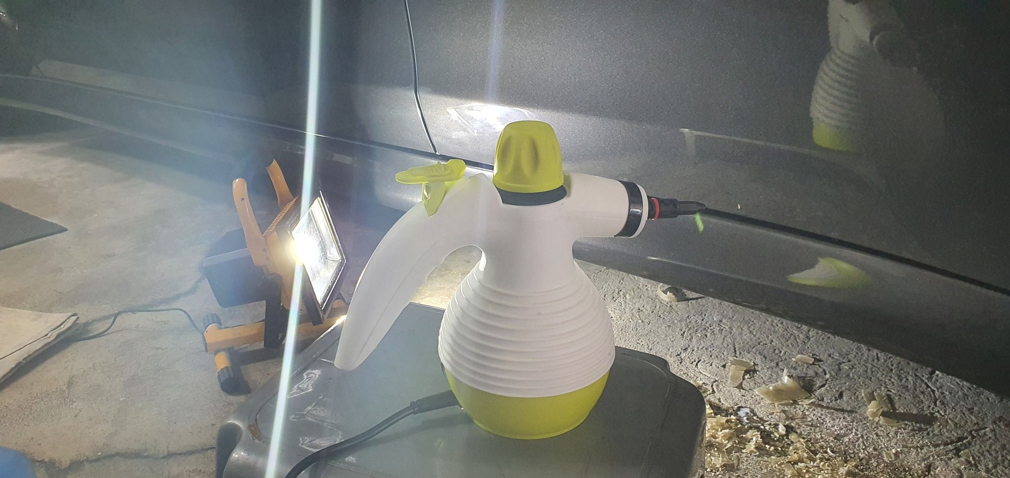

Start off with using your steam gun to soften the 12 year old sticker one portion at a time. Concentrate on the edges first then going to the center part of the 1 portion. At this point…remember to take a picture of your old stoneguard’s corners, it’s exact positioning and spacings so that you can use the pictures as reference later on when you install the new stoneguard stickers.
Steam gun.
When it feels soft enough, scrape the outer rubbery part firmly but slowly. DONT attempt to get the gooey part underneath…you will scratch the paint! One layer at a time won’t hurt guys. Patience is the key :-)

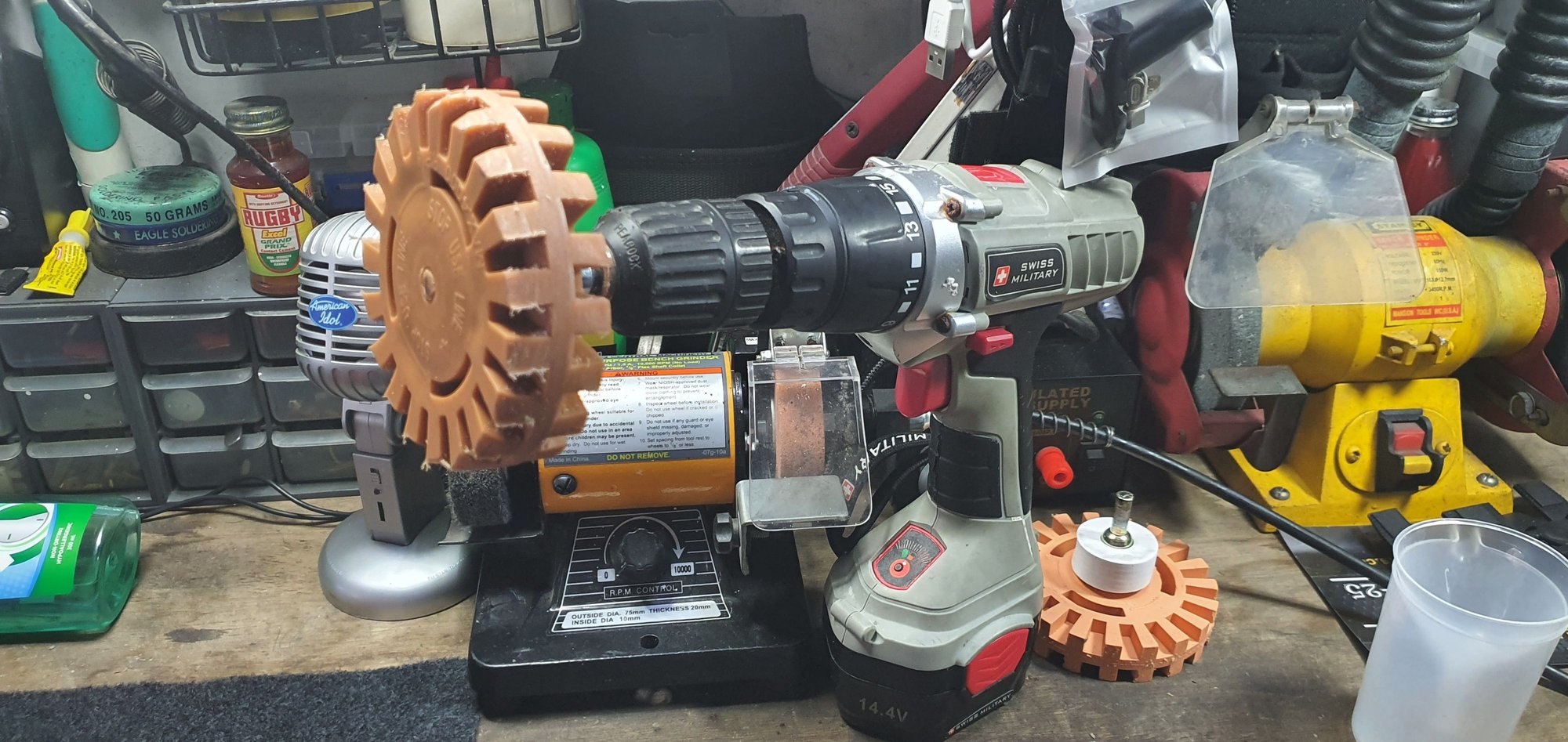

STEP 3 After about 15 mins. It’s now time to use your cordless drill with a 3M eraser wheel attached. Here’s a link on how to use it……
A hand cordless drill is preferred for control and ease of use. Low Drill RPM is also considered!
By using the eraser wheel, the softened adhesive gets effortlessly lifted off the paint without any scratches and you can just peel off the accumulated goo with your hand.
The accumulated goo you get from using the 3M eraser wheel can be rubbed off with your fingers.
One portion at a time or...it really depends on you. As long as you're CAREFUL.

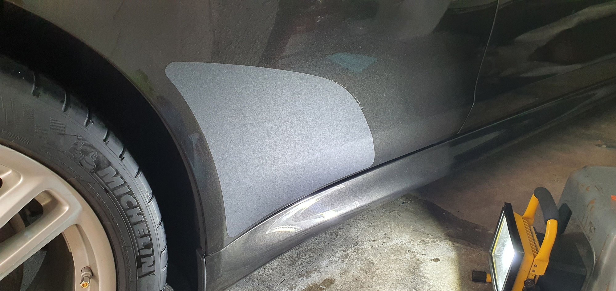

After all these…it will look as clean as this and you might even decide not to put on a new stoneguard anymore since it looks pretty anyway :-)
Clean and not scratches! :-)

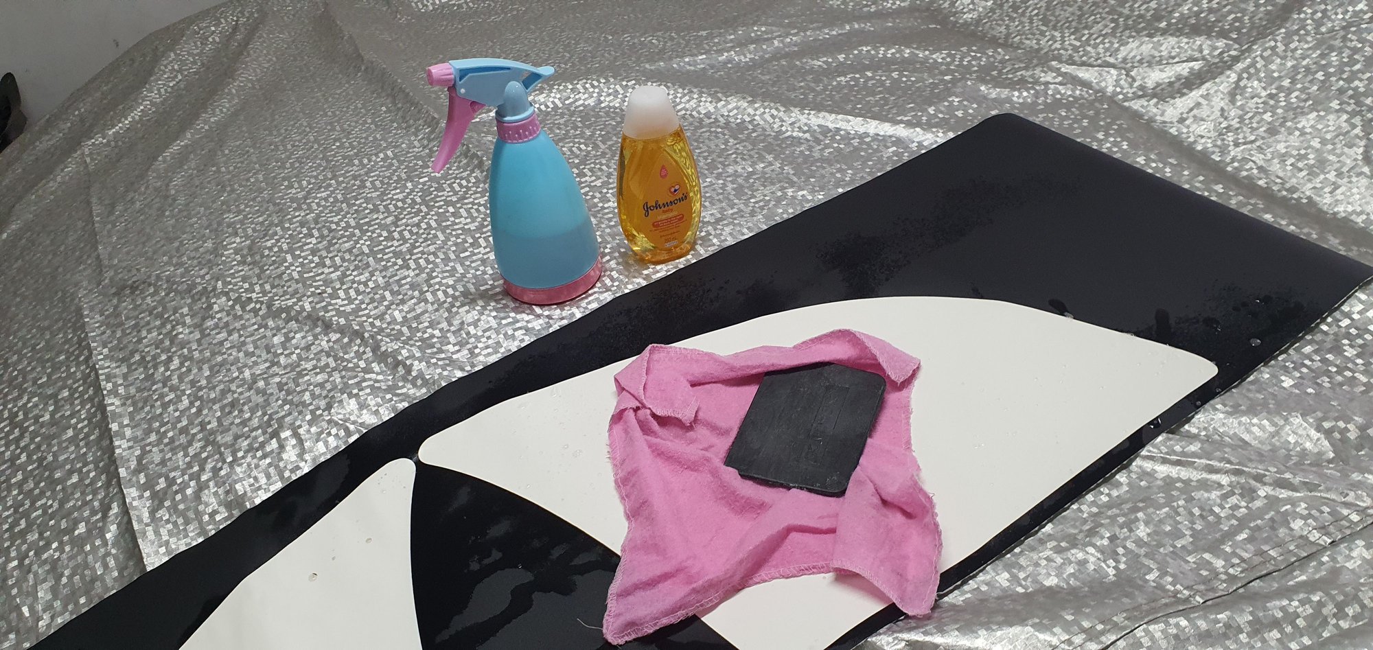

STEP 5 will be the reinstallation of your new stoneguards. Remember to clean with dishwashing soap and water the whole rear door so that you remove the remaining bug & tar remover residue. I heard that you can also use alcohol isopropyl alcohol BUT I did not do this because again... I fear damaging my paint. So I used dishwashing liquid instead - the one that cuts grease and grime. Rinse and towel dry the door/portion.
STEP 6 Installation of the stoneguard stickers. Put water into your spray bottle and drop around 6-7 J&J Baby Shampoo and shake the spray bottle well. This will be used as anti-stick for your stickers so that you can install and freely move it around into the right position.
Spray some of the anti-stick solution you made on your hands first then peel off the stickers spraying on the the solution on the adhesive side of the sticker while peeling it off from the sticker paper. Spray some of the solution also to your door.
Get ready for sticker install with these...
STEP 7 At this point, you are like applying tint film on your car windows. It’s exactly the same procedure as applying car window tint. Slap the film on your car door and do the necessary alignment based on the photos you took before you uninstalled the original stoneguards.
STEP 8 Finally, use your plastic squeegy wrapped in your flannel cloth so that you don’t scratch the new sticker starting from the center going towards the edges to squeeze the anti-stick solution out. Look for any bubbles you might’ve missed.
