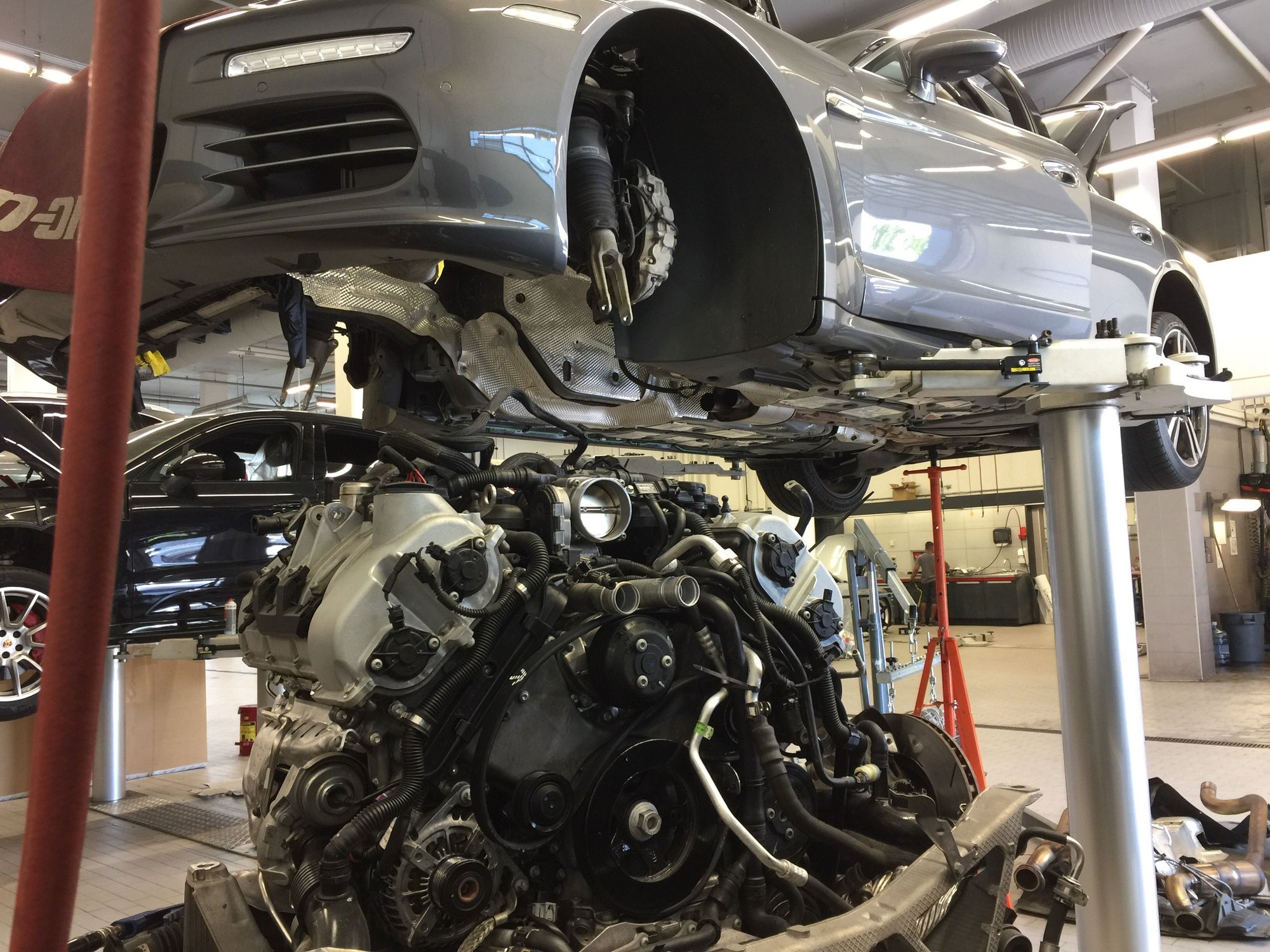

The aluminum bolts for the timing chain cover and cam covers are known failure points for the V6 engine (and possibly the V8). Surprisingly very little written on the Panamera forums about this issue. This engine is shared with the Mayan V6 and the Cayenne V6 and you will find much more information on these forums about this issue.
I think this is a much more common issue than reported. I suspect most Panamera owners never know they are leaking oil because most are not wrenching themselves and the underbelly engine tray catches the oil so that it never stains the ground.
I’m attaching the Porsche bulletin about this known issue below. As you will read, Porsche’s “fix” is an engine out reseal. Ask me how I know…

The V8's are known to have this issue as well. In typical Porsche fashion, they choose the most complex process possible to repair these things. Sure, pulling the engine and completely re-sealing the cover is the most surefire way to fix it. But I'd wager that a crafty grease monkey with a set of EZ outs and some time to kill could also stop the leak just by finding the broken bolts and replacing them. With the engine still in the car.
