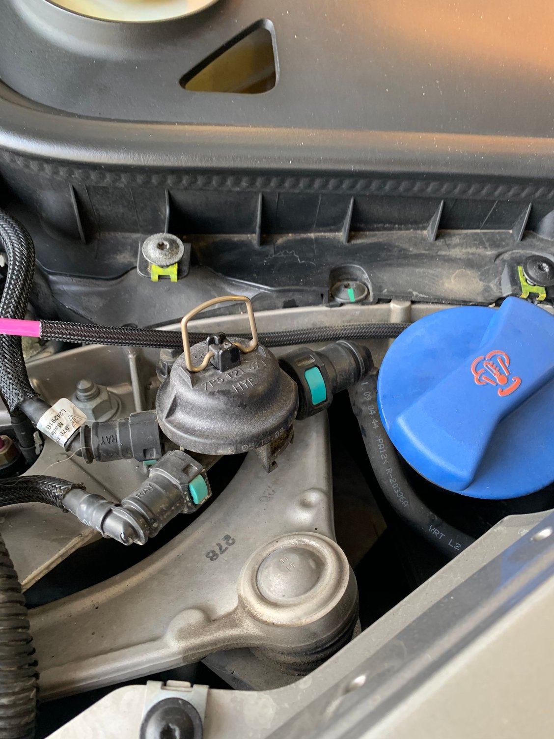

By the way, have you burp the system correctly?

Lift the clip up. Go on a short 10-15 minutes drive. Check coolant level when it has cooled so you won't get hurt. Do this for 3-4 driving cycles. That's it.

Mine actually does not stay up goes from one side to the other is that ok?
i guess afterwards switch it back and place back plastic cover?
to understand what is the function of that?
thx much for your help.

Actually the loop did stay up like your picture.
After the first ride with the loop up when I checked collant level was much higher than before almost spilling so I emptied a bit with a seringue.

You can leave it up and drive it for a few days. Add fluid if necessary. After a few days, the fluid level should stabilize. Assuming there are no leaks. Move the clip back to horizontal

This is the instructions I have for bleeding that I posted before. Instructions assume you’ve just done a drain and refill, that the engine is cold. So raise that bleeder valve in the morning when engine is cold. Check the level the next morning. Is that a V8 or V6? I’ve looked at some Cayennes recently and GTS is a V6 so I’m confused....

What are these 3 connectors for ?
And 'thingy' with the flip is it sensor or what ?
Thank You in advance.

I believe that is the coolant bypass/bleeder valve. It seems to be the highest point in the cooling system.
