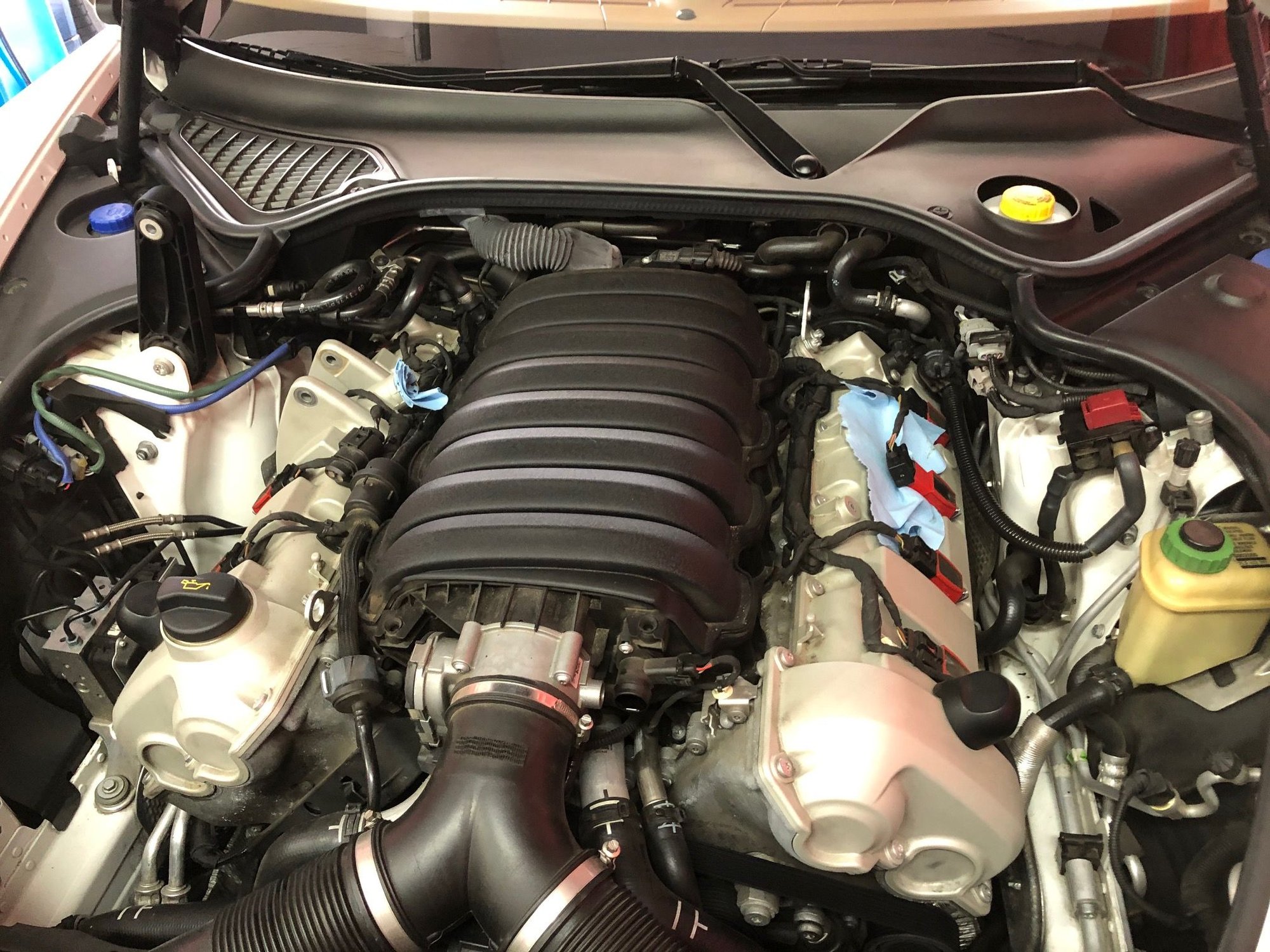

You want pictures of engine without trim? HERE, go knock yourself out...this is the plugs/coils replace DIY, you can refer to it to not break some plastic that otherwise you may.
Hope this helps.
Originally Posted by Sling Shot
I didn't move the coils since I figured I'd wait until the new ones show up so if they are bad I can just swap them then. Any where to find a pic of the motor without the engine trim on it by chance anywhere?

NA V8? I left the covers off. I can change the coils and plugs directly. It's dirty but I can take a picture of it maybe tomorrow morning. My wife took it to work...
Yes thank you!

This looks like a connector that is part of the wiring harness, on the driver side of the engine, along the fuel rails....I dont have good picture of this, hope someone else has better image or can jump out to take a pic....I am en route out of country now.
But this looks like a connector that is intended to be wired to two wires, above the valve cover before the engine dampener. This image came out of my DIY for starter replacement. If anyone has more detailed pic it would help. There is a 2 wire cable going up to that....look around the area for loose ends.

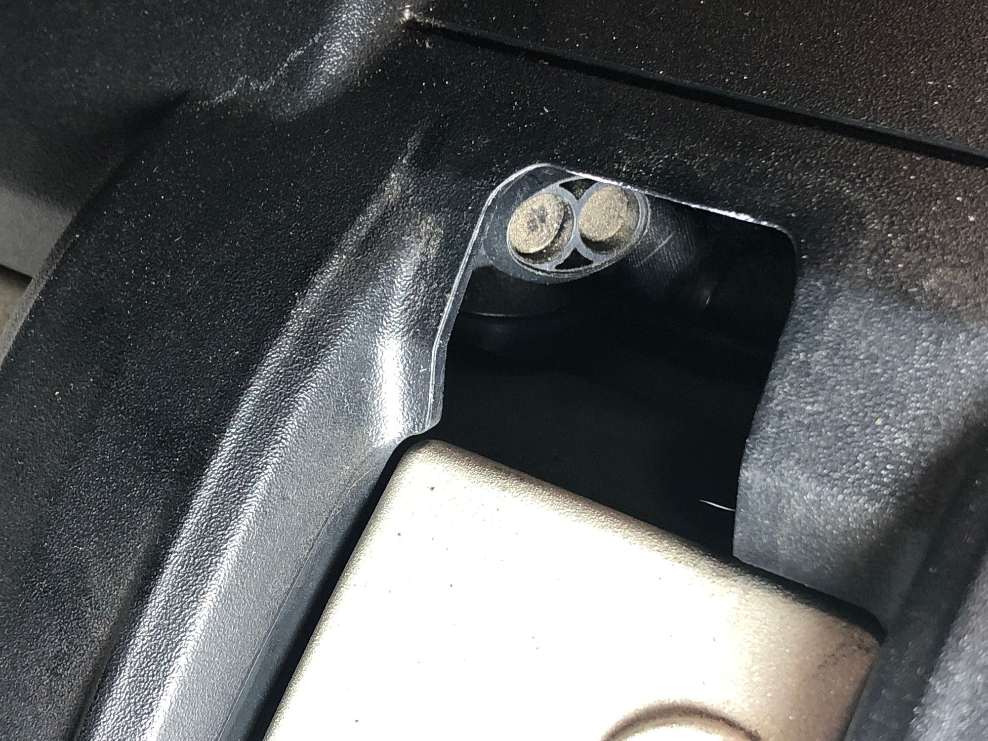

Totally flaked on this honestly. I was troubleshooting a home networking speed issue and completely forgot. Got to leave in less than two hours for a 5k at Dodger's Stadium, and popped into my mind. It doesn't connect to anything and looks like there's a little plastic mount you're missing at the bottom.
Old Mar 18, 2023 | 05:51 AM
jzchen's Avatar
5 Year Member
Joined: Jul 2019
Posts: 829
From: Arcadia, CA. USA
Rep Power: 40
jzchen is infamous around these parts
I was limited to one pic due to size. Gonna try one more here top view hopefully it allows... (My iPhone is charging and I forgot how to set the resolution on my prior Android). It doesn't allow trying Google Drive link.
Top View Dummy Connector

This is what it looks like with the trim covers on and the rubber plug removed. Connected to nothing.

from when I did my thermostat housing - seems to connect to nothing

Sling shot, you've got your answer. If connects to nothing, then it's mounted to a metal bracket in that area. Take a look.
