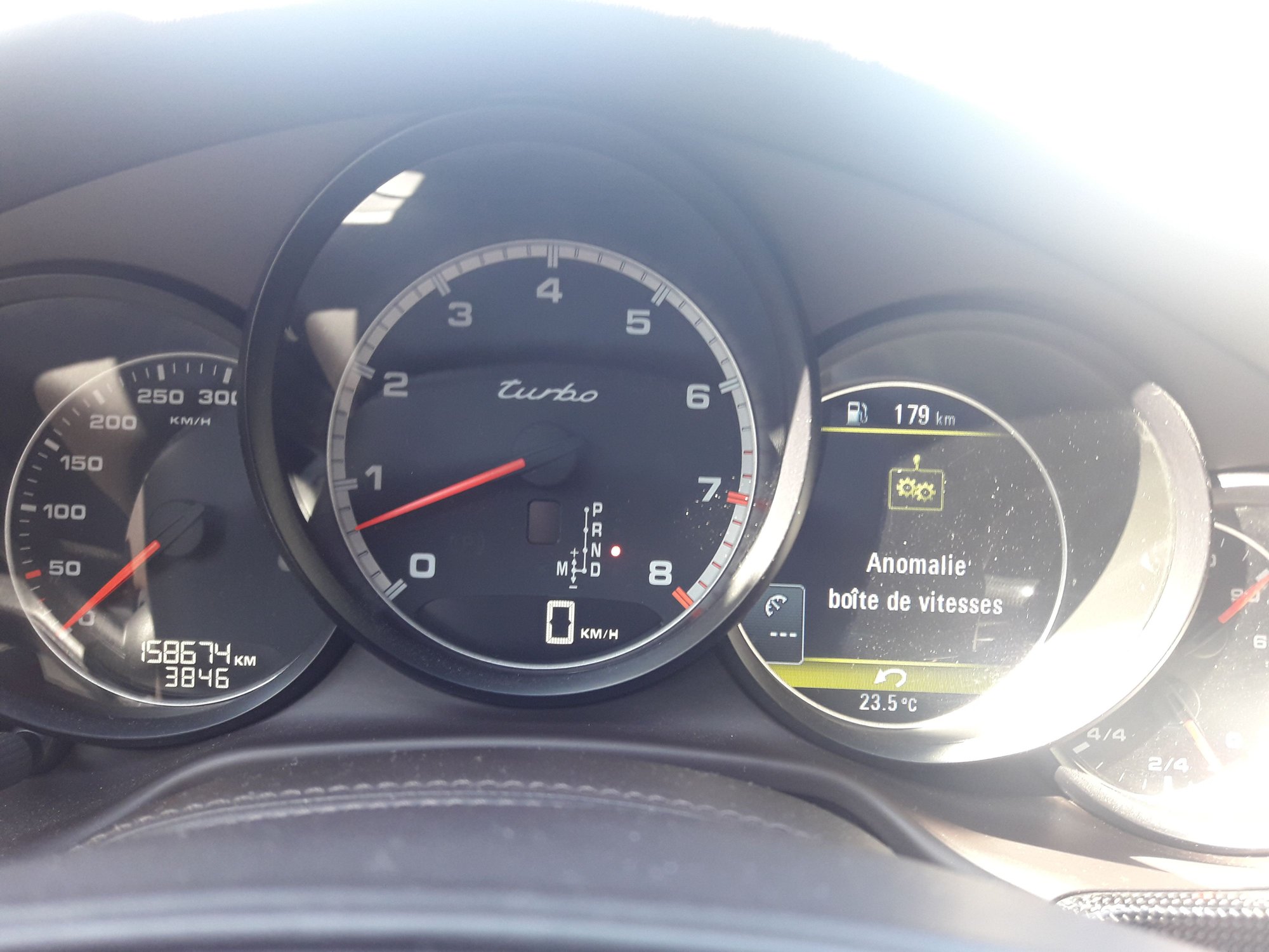

Replace your battery first. Without a fault code it will be complicated to carry out a diagnosis. I had the problem with the gearbox sensors and there was no shaking. I drove and an audible alarm sounded as well as a message with the 2 small gearbox gears in the dial, and no speeds indicated in the square at the bottom of the speedometer. At this stage the car was driving , I called the Porsche garage, they asked me to turn off and restart the engine and the car went into safety mode, at that moment it was impossible to move forward or backward. The next step is towing at a Porsche dealership.
