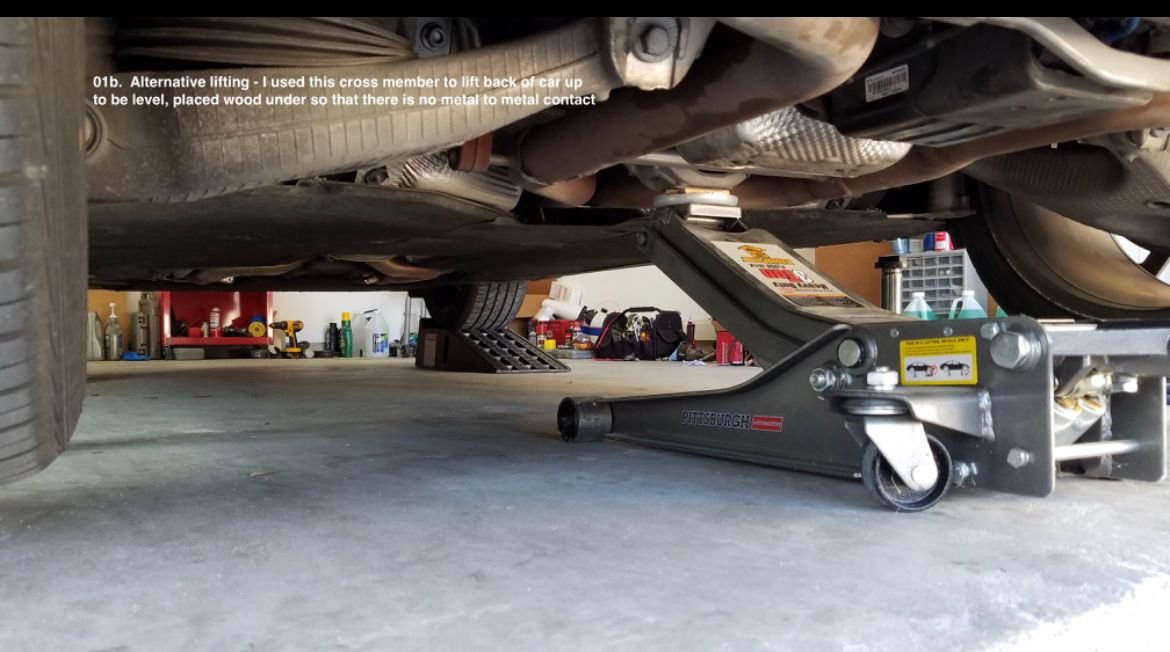

I’ve seen @ciaka’s technique of ramps for the front and then lifting the rear at the cross member next to the rear diff. Trying to figure out how to get more clearance under the car than ramps can provide. Getting too old to work flat on my back with my hands right next to my face 😂.
ciaka’s technique to lift the rear.

l’ll probably keep it simple and drive up on Rhino Ramps to raise the front. All then use @ciaka’s technique of lifting the rear through the cross member with my floor jack. I’ll slide another set of Rhino Ramps under the rear wheels. This way the car will be level for the PDK service. One day I may invest in a QuickJack…

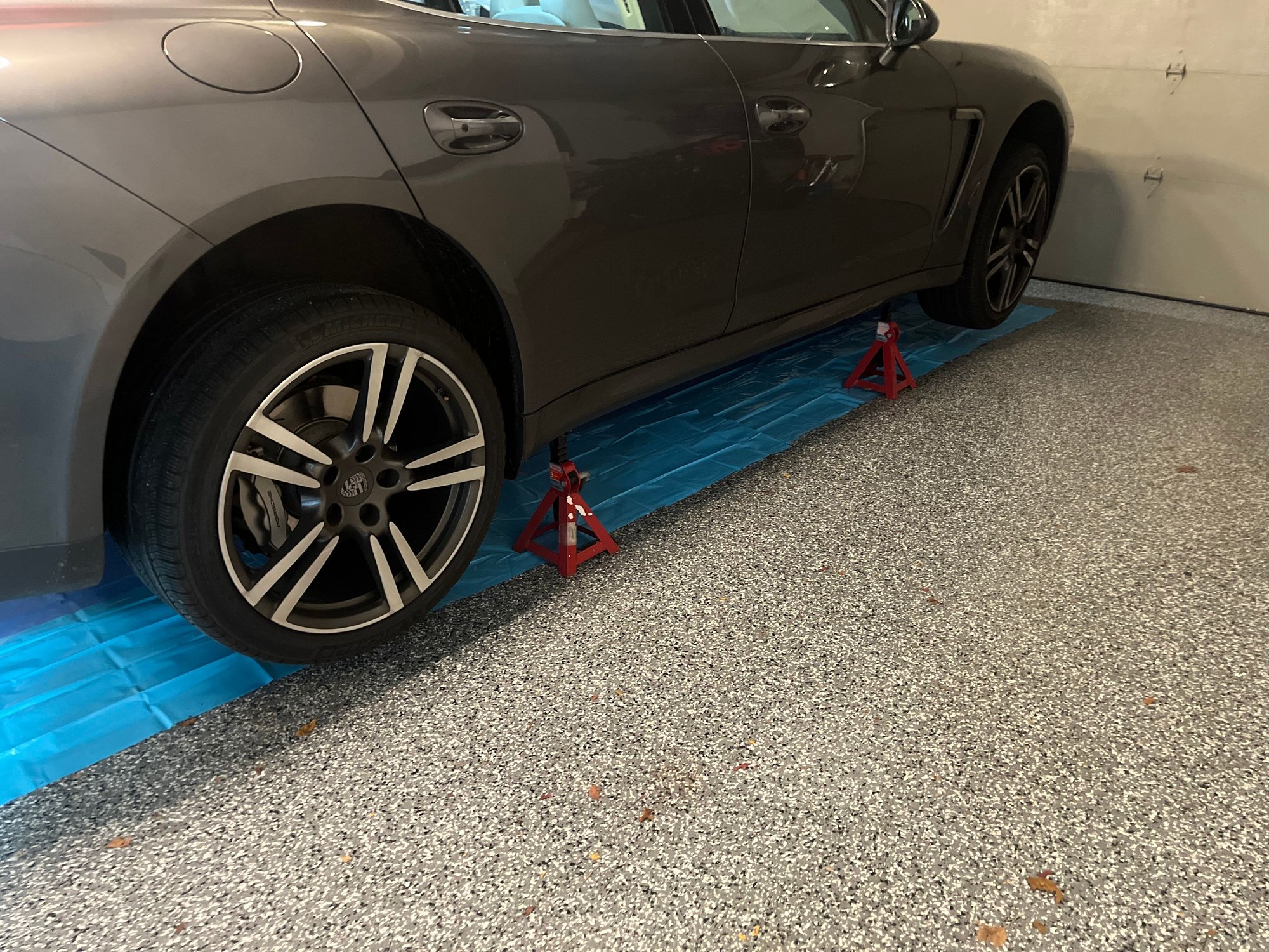

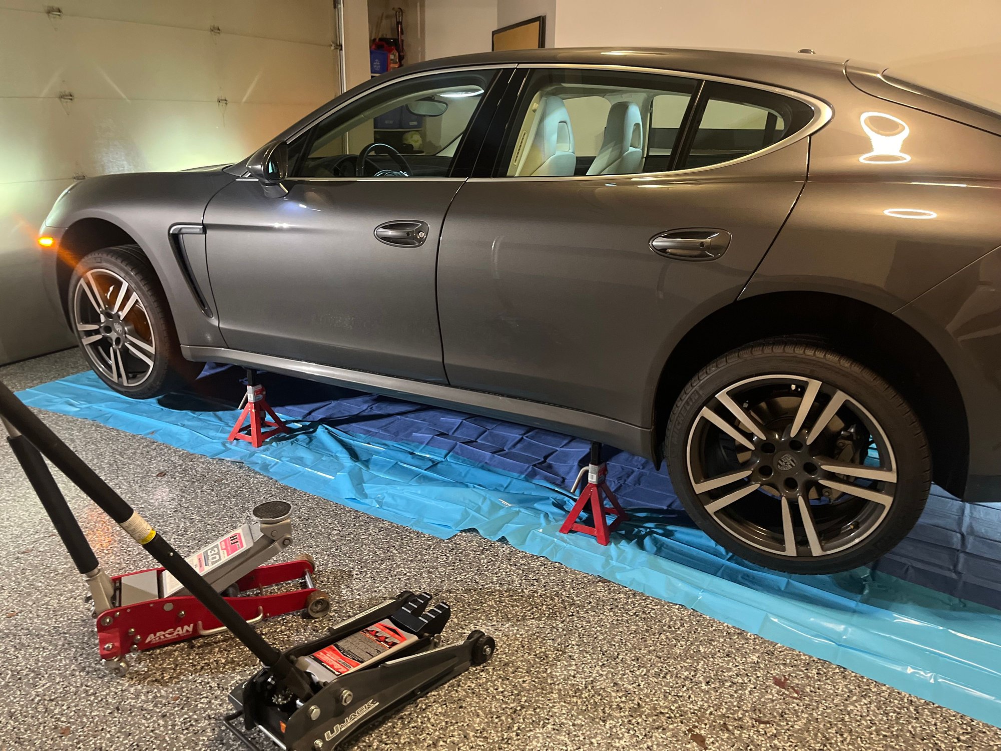

Closing the loop on this for anyone that might be interested. I picked up a PowerBuilt UJack to complete my big 80, 000km service. I can confirm it works as advertised. Can lift each corner at the jack point and then slide a jack stand onto the same jack point. Go slow when letting it down (onto the jack stand or back on the ground) as the hydraulic mechanism is pretty touchy and it can go too fast. Best to practice a bit to get a feel for the jack.
You can only get a 3 ton jack stand to fit in the opening on the jack but this is plenty on all 4 corners. The car is perfectly level as long as you use the same brand of jack stand on all 4 corners.
