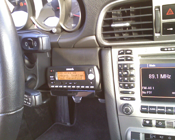

Here's the basic concept. The Stratus 4 radio is known as an RF modulator. It sends a wireless signal to an empty channel on the PCM (stereo). The Stratus 4 radio can be placed on top of the dash, face, center console or wherever. For purposes of hiding the wires I placed mine to the left of the PCM. It's within reach and out of the way.

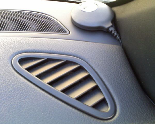

To get the Stratus 4 running within 15 minutes, you are going to attach the cigarette lighter and circular antenna. Place the antenna next to the windshield so it has a line of sight view to the sky through the window.

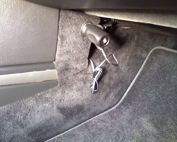

A) Plug cigarette lighter into available outlet.
B) Plug circular antenna into Stratus (there is another wire one, not needed) and place next to the glass.
C) Program the Stratus 4 radio "transmitter" to an empty fm frequency (89.1, 90.1 or in my case 106.5 MHZ). For some reason, there was a cleaner signal at the upper end of the band. Select the same "receiving" frequency on the PCM.

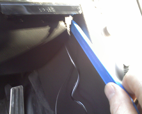

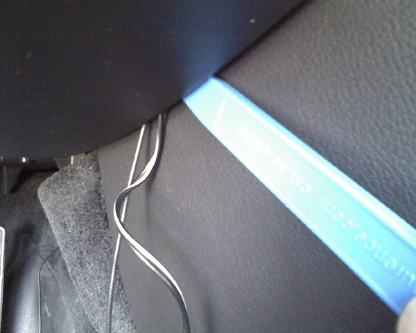

Run the two wires from the Stratus to their desired locations. The is a lot of room behind the PCM, so run your wires. This is wear the "trim tool" comes in. All you are going to do is tuck the wires into the cracks by pushing them in gently. Avoid screwdrivers! If you need to take a shortcut, a popsicle stick is safer.
