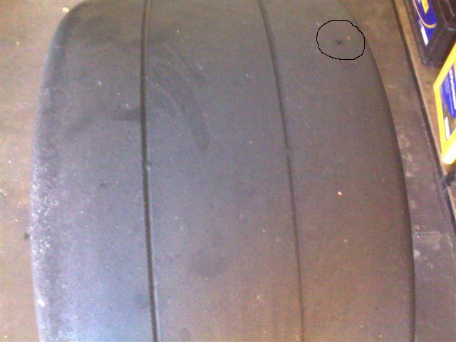

Id like to ask how anyone with experience has found hoosier r6's perform as they wear.
i have a set that are on the tread bar but still have 2-3mm in them if you measure the small holes on the LHS and RHS of the tire.
how low can these go before the tire stops performing really well?

We have measured in terms of heat cycles.
While driving DE events we could get 14 heat cycles per set, when racing that would drop to 9 due to the way the tires were being driven harder.
They always still looked good, but you could definately feel them letting go in tight turns.
Ps, we always take new tires out for a couple of easy laps on the first run then bring them up to temp for a lap or two then let them sit for at least 48 hours tp let the rubber cure before we start counting a heat cycle.
Hope this helps

i am doing 15 minute sprints
tyres heat up to approx 175 degrees F or 80 degrees C
then they cool for 30 minutes (not fully cool obviously)
6 runs in a day.
that would obviously count as 6 heat cycles?

Yes that is 6 heat cycles. You will know when they are done, you will notice a considerable more amout of slide.
Be sure to do the first heat cycle and 48 to 72 hr cool down. It really adds to the length of the tire.
We have three sets of tires, wheels that we are always cycling through so that you have a fresh set that has been heat cycled ready to go.
I have tried to buy the set from Tire Rack pre heated and they did not seem to last as long as when I did them myself.
Also, if you can use nitrogen, the tire pressure fluctuation is not as great cold vs hot as oxygen.
Have fun and drive hard!

I bought mine from tire rack pre heat cycled
interesting that after 10 heat cycles, the tyre was sliding much more as you suggest. i managed it by using them for short 5 minute sprints and they where at 85% of original grip v when they got really hot and it felt like 70% of original grip.
the grip was surreal when the tires where fresh.
i am on the tread bar now or close to it but there is 2mm to 3mm of tyre left when measuring the holes on the sides of the tire.
i will try cycling them at the track next time - thanks
