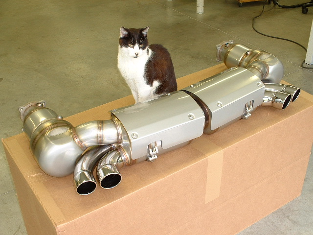

So you guys don't have to go back through the thread ......... here are some pics of the Europipe muffler that was built for Killer Angel.
Like sharkster said ........ there is no exhaust that sounds as sweet as Europipe. We had this exhaust on the car back in 2004. The sound is intoxicating. Back in 2004, before we bent all six rods I use to have people pull up at stop lights and comment on how good the car sounded. It had a sound all it's own.
I really can't wait to hear it on the new motor. When the car finally sets it own mark the whole world will know the exhaust is Europipe.

Well we focused on the backpressure reduction first. Measuring the maximum backpressure is easy and gives you a fix number while using a rolling road dyno leaves you with a lot of variables. Just connect a pressure gauge with the aid of a long air line that goes all the way inside the cabin and go for a full boost WOT run in 4th gear and you'll read the maximum backpressure. And if the cops are behind you , you'll get even more backpressure !

Thank you Mike. Those are nice pictures. Been a long time ago , I hardly recognise my old cat.
As far as I remember your exhaust had 1 x 60mm and 1 x 70mm pipes while Chad's version was 2 x 60mm. Different tone but surprisingly the same backpressure though.
