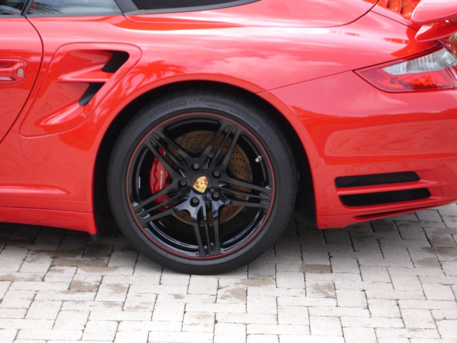

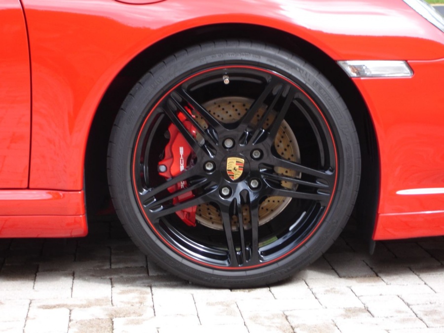

I painted my OEM wheels from silver to powdercoat black (my car is black), the result was great, I was recommended to go with a semi gloss finish (not full gloss), actually I think the painter was rigth!!, the final result was great!!. the only setback is that after a few track days the finish is not the same, the wheels are losing the nice gloss and depth of color. Maybe the brake dust has stained the wheels during the heat cycle on the track, I think this has not hapenned to original OEM black wheels. I have to poit out that in my case I have been always very careful with my car and always have keed the wheels clean.

Thanks guys. Gus, do you have any pics?
