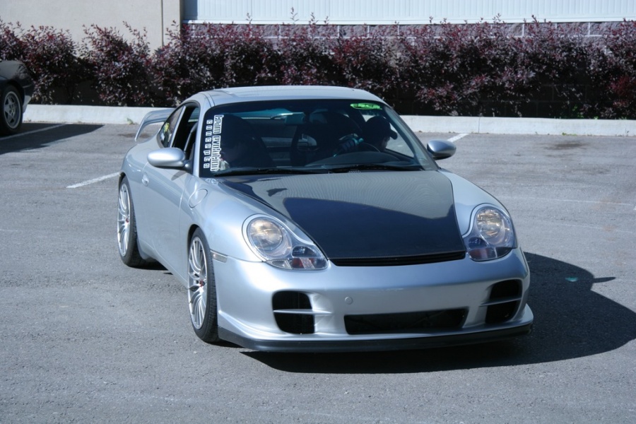

Alan, I have a 6GT3 with stock wheels (18 x 8.5, 40mm and 18 x 11, 63mm). I wanted to push out both the front and rear just a bit more with the 7mm spacers (I don't feel that 5mm is noticeable enough). I know that my standard offsets are already good, but I ran across these two cars with the ATS/9ff set-up (18 x 9, 35mm and 18 x 11, 55mm). So, my question is: would you advise for or against using the 7mm for my street application?
Thx!

jmla- Running spacers will not affect anything, it is more for looks to "fill out" the wheelwells. The only issue you can encounter is if you space the wheels out too far and rub fender.
Going by my previous 996 and current 997, you can space the rears out another 18mm without issue. On my 996 I ran 15mm spacers on all four corners with stock 18" rims and there was still plenty of clearance. On the 997 I had 15mm spacers rear and 7mm front. I would probably recommend one of these setups for yours, since the above recommended spacer sizes were passed on to me from other members here.
Make sure you pick up the correct size longer wheel bolts along with the spacers, I'm sure Alan can help you with that as well.
