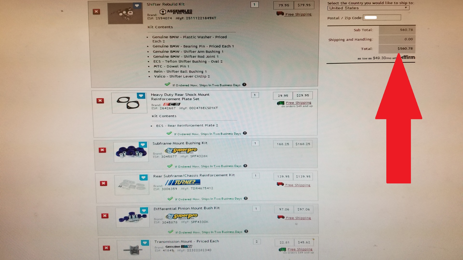

Since I will be taking this car on track and drifting it, the chassis needs to be able to cope with the abuse. To that end, I ordered a ton of parts for the car through ECStuning. To address the E46 chassis’ notorious subframe issue, I bought a reinforcement kit. Since I determined that the rear differential bushing was causing my clunking sound, I ordered a full polyurethane diff bushing kit. Seeing as how I have to drop the subframe to address these issues, I also picked up a complete set of polyurethane subframe bushings.
Additionally, I mentioned how floppy and vague the shifter was. There were instances where I found 5th gear instead of 3rd, or, more troubling, 3rd instead of 5th. Which, in case you’re curious, is not a fun surprise on the freeway. To that end, I ordered a full shifter rebuild kit, with of the bushings and pieces needed to have the shifter assembly working correctly. Oh yeah, and for the time being, I ordered some cheap knock-off E46 M3 transmission mounts, as it’s one of those “while you’re in there things” that’s worth replacing.

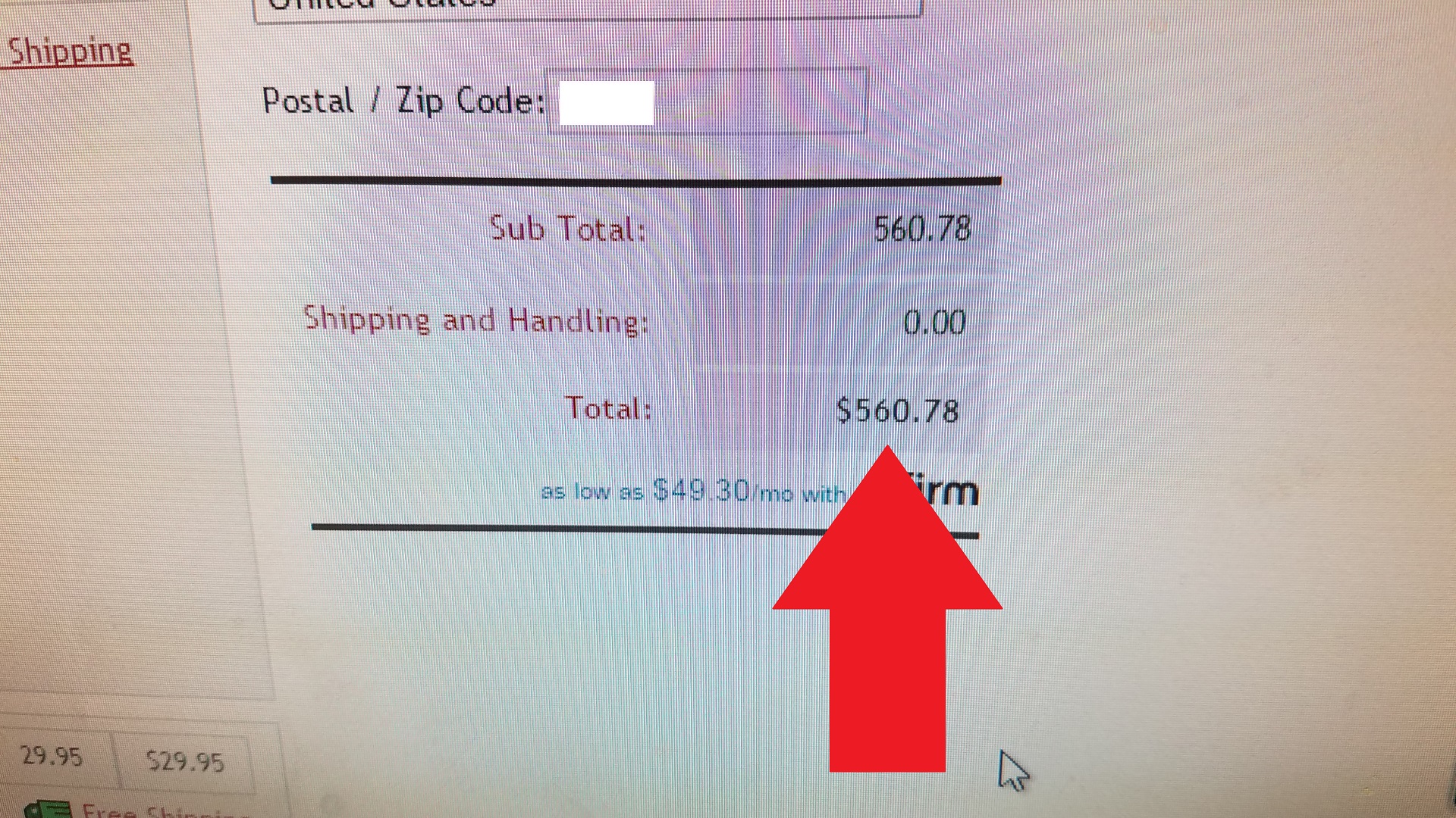

Taking on some rear shock mount reinforcements, another trouble-causer, this brought my grand total up to $560.78. For those keeping track, that’s over 37% of what I paid for the entire car. I have a feeling this won’t be the end, either.
