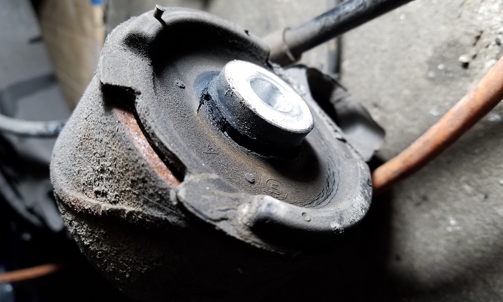

A quick visual inspection shows that the RTABs on my E46 are shot. These stock rubber bushings allow for the proper multi-axis suspension movement. The trade-off is that, eventually, the rubber fatigues from the constant movement, and tears. If left alone and untended for long enough, the bushing can tear all the way through. Then the trailing arm falls out of the car and everyone has a bad time.
So, this all leads me into the solution: Hardened rubber bushings.
A tougher rubber bushing will still allow for that primo multi-axis movement we’re after, but better hold up to the abuse of drifting. To that end, I sourced Meyle HD bushings, which utilize a stiffer durometer rubber. But that’s not all. Even with these stiffer bushings, it’s possible for the trailing arm to go too far in its movement. This leads to sloppy handling, and, you guessed it, increased bushing fatigue. To that end, the aftermarket has developed trailing arm bushing limiters. These solid pieces of polyurethane, delrin, or metal slot in between either end of the bushing, and the bushing mount and physical limit the bushing movement to a normal range, prohibiting excessive movement, or deflection. Perfect!
