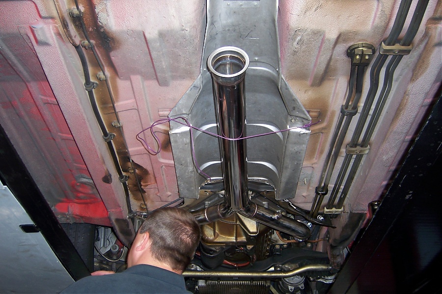

Y-pipe going on (9 pounds total):

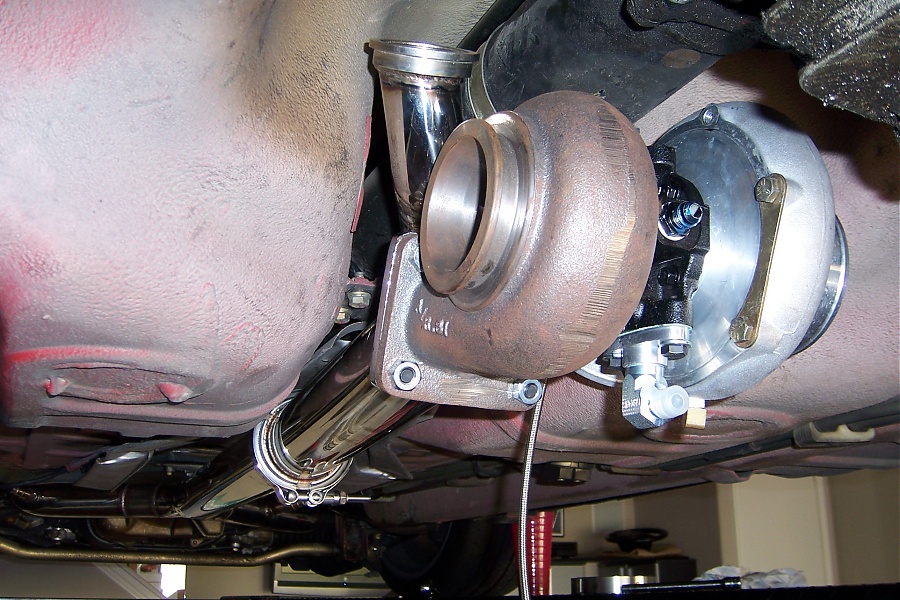

Hanging the water-cooled T67 P-trim Dual Ballbearing turbocharger with oil line attached:

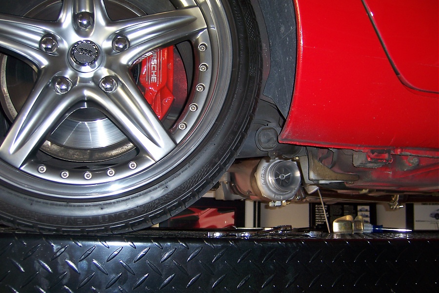

Hanging turbocharger: still has ~5" clearance from ground on 2" lowered 928S

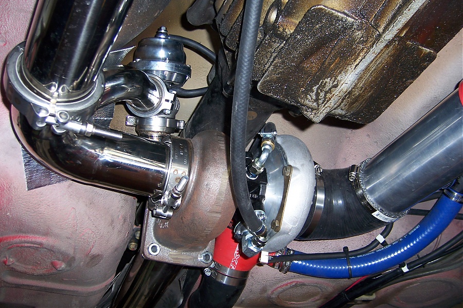

Hooking up the Tial 44mm wastegate to the Stainless downpipe (v-bands)
showing the mostly-installed set-up, with oil scavenge lines, water lines, catalytic test-pipe (you can run a proper emissions compliant cat w/air pump too).

Did you put any kind of skid plate over that thing?
I'd hate to hit all that fine craftsmanship on a speed bump or have a stray stick rip out the vacuum hoses...
Opposite of heat issues: it runs cooler, so did my last turbo 928. I'm putting down about 440rwhp currently at 6.5psi.
My car is very low, I've bumped the system one time (small scrape), but other wise it's fine. All the wiring & vacuum & oil/water lines are routed up high.
