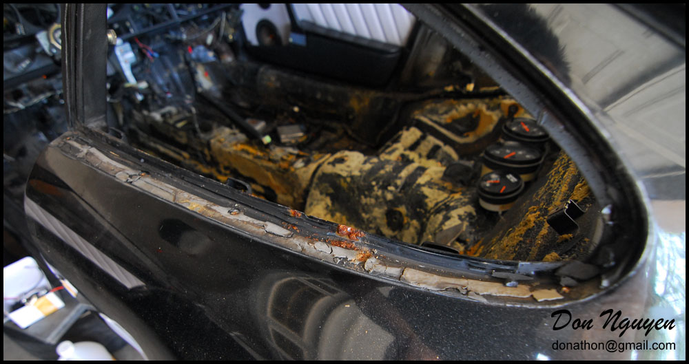

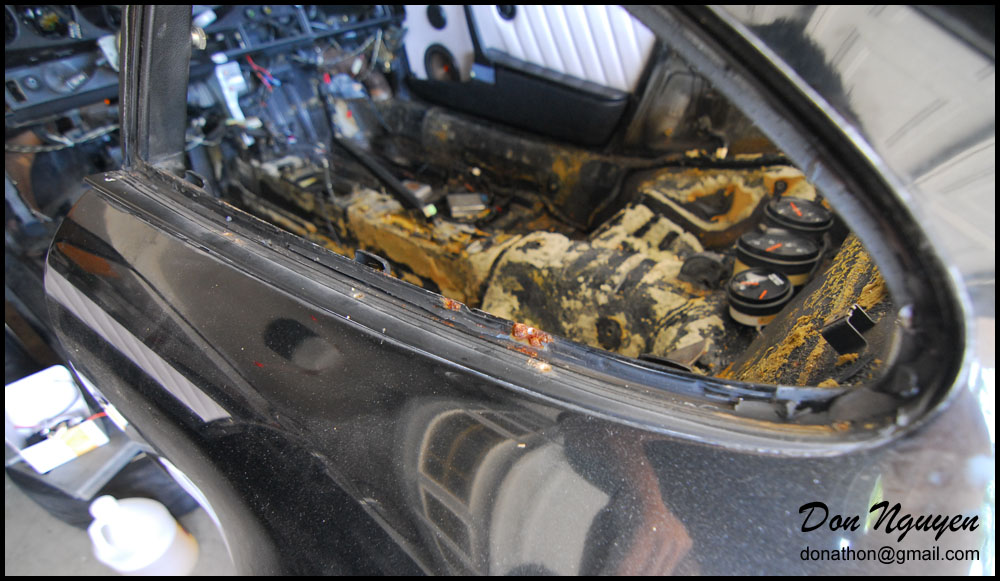

One of the other reasons why I wanted to go through the whole car, which was to find any rust spots that would be developing such as what I found here around the rear quarter windows.

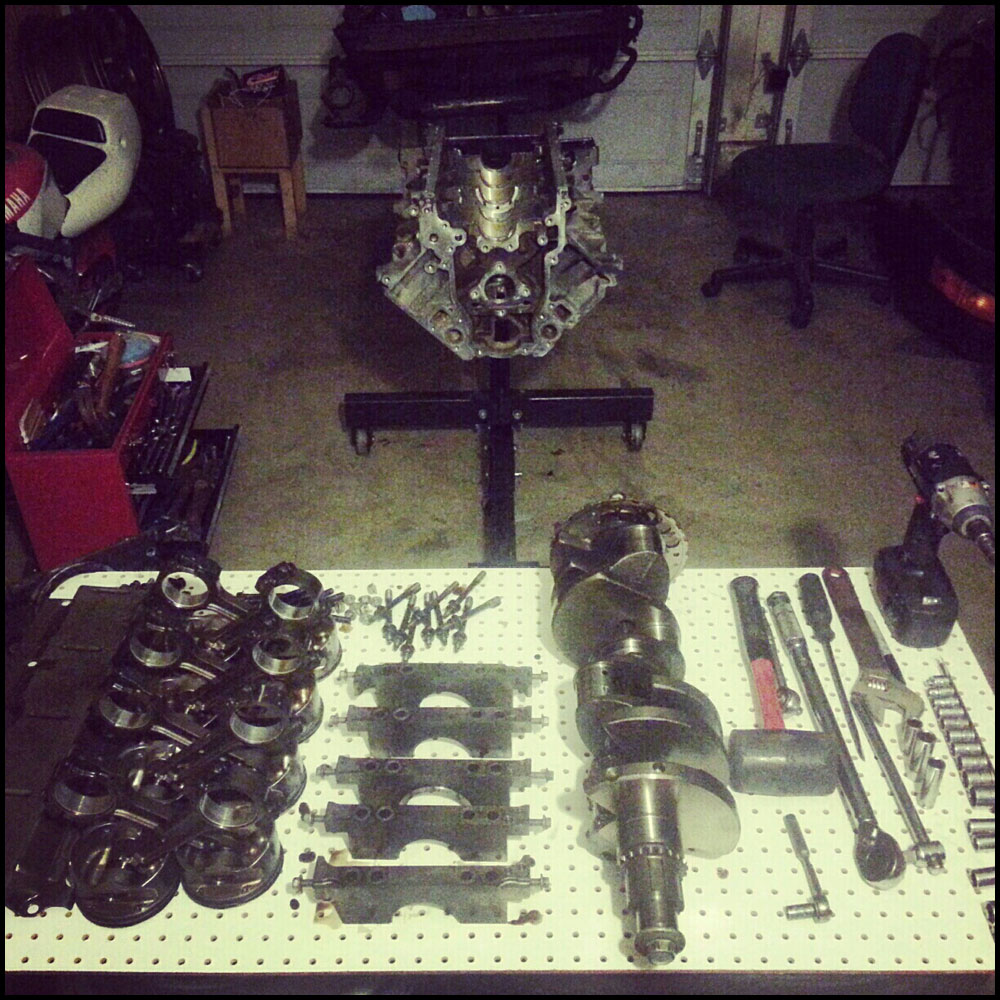

Bought a used short block, so naturally I had to take it all apart to check and make sure everything was ok. I am going to go ahead and get the cylinders bored out slightly bigger, oversized forged pistons to match the new bore of the block/cylinder once it gets machine, get the crank cleaned up and get new bearings (con rod, cam, and mains).

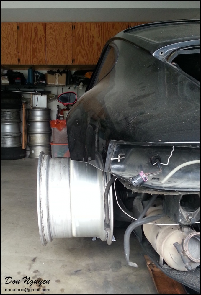

That's not to say I don't have any pictures of my Porsche that I can't share with you guys though. Nothing special, but at least it gives you something to look at.
This picture is from at least 4 years ago when I was first test fitting wheels on my widebody E36 M3 and for fun I put the wheel next to my Porsche to see what it would look like.
Here's a more recent picture of a different, but similarly sized wheel on my Porsche, to gauge roughly how far out my flares are going to have to be.
