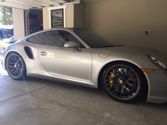

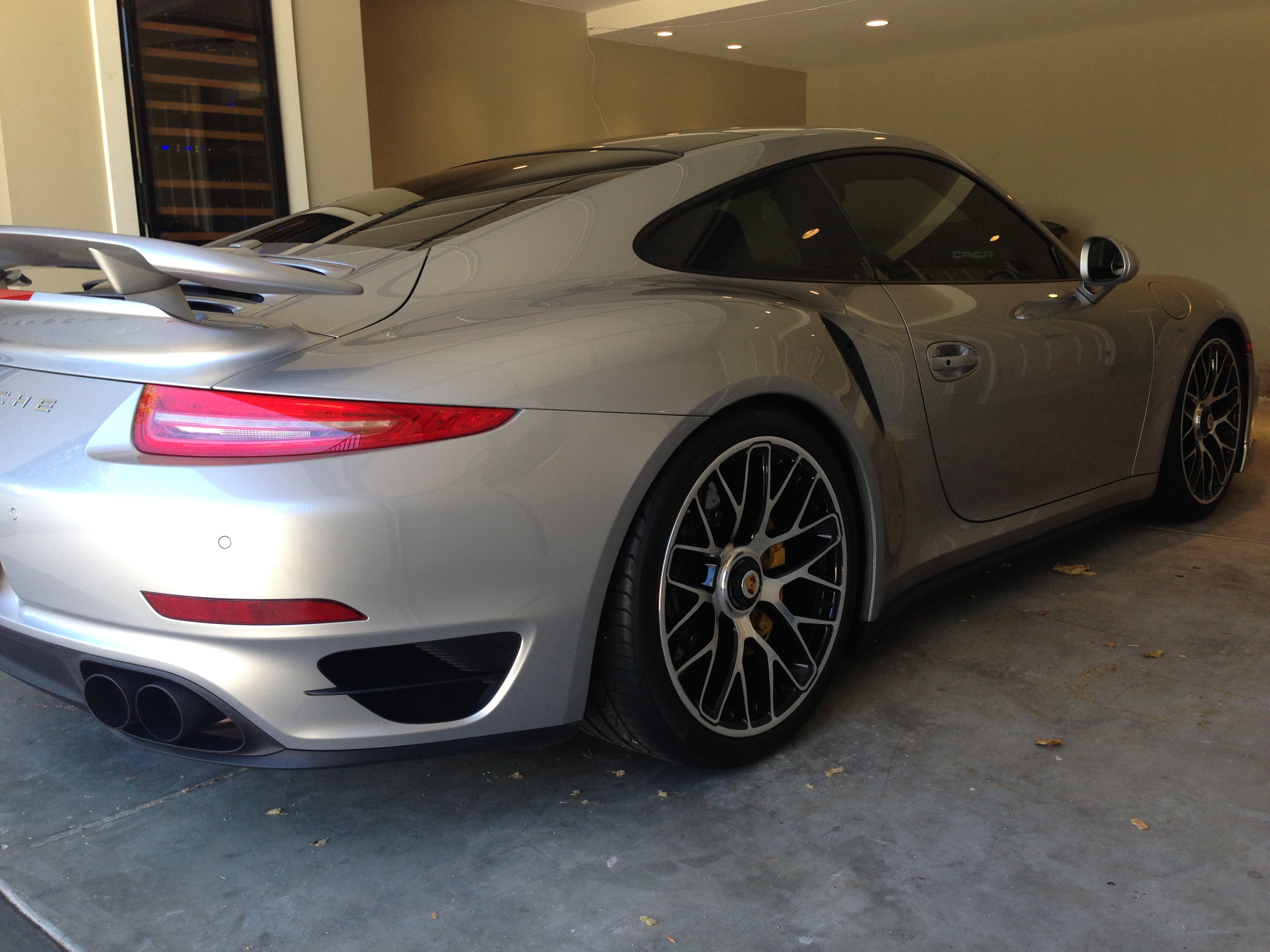

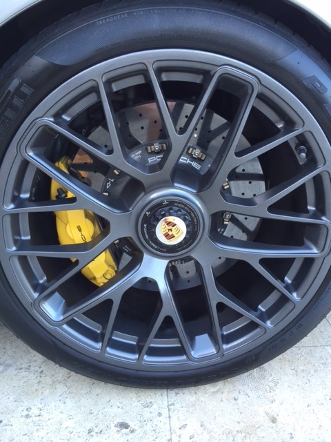

Just read the post on GTS wheels. I saw the GTS a couple months ago, and knew I had to change up the look of our stock Turbo wheels. I considered buying new wheels ($10,000+), powdercoating ($1,000+), but, after watching a dozen or so Youtube videos, decided to do a DIY PlastiDip project. I have no affiliation with Plasti, but I am stunned at the quality and finish of the results. I went with four coats of the Antracite, covered with two coats of their clear Glossifier. Thought about the matte black like the GTS, but thought this would look good with my GT Silver. Attached are some before and after pics. Best part is it cost $75, took just a few hours, and I can peel it off if I get tired of it!

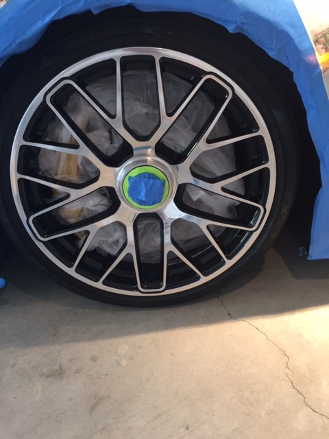

You sprayed these on the car? How do the barrels look. I was considering doing this while I decide what aftermarket wheels I want

Yes, that's the great part! Wheels stay on. Masked off the rotors/calipers with plastic bags, and masked off the center hub with a round piece of paper i cut and some tape.

Looks great!!! Haven't watched any of the You Tube videos...just wondering how is overspray on the tires removed or is inside edge of the tire masked off as well? Thanks, PJ

No masking needed. Just rub a little Armor All on tire, purposely overspray a bit, let it all dry, and then it easily peels/lifts off.
