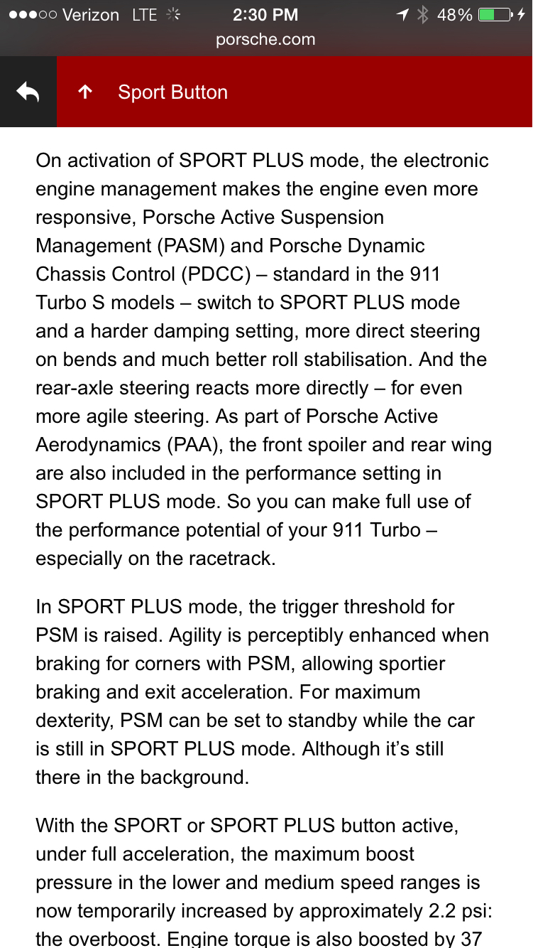

Thanks. Have tried to hear everything I can about the car and how to make it go faster
ID:	424349   Click image for larger version
