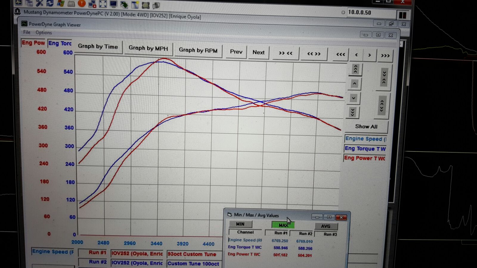

Hi Guys!! Tonight i did some testing on Enriques (webcarconnection) 991 Turbo. Only change made to the car was installing By Design Billet 4.5 Intercoolers.
I did a Dynorun using the Stage 0 MAP (Stock),A Stage 2 93oct and some custom tune for power. The car gained power on all runs compared to the Stock IC runs. On the custom 93oct MAP i got away with power similar of my previous tune with the stock IC and 100oct GAS!! Also theres a Datalog screenshot comparing stock IC vs New IC Intake air temps. The Dyno bay was at 92 degrees and 62 humidity. Car performed flawlessly. Cant wait to put some race fuel on it and see how much power we can make.

This is the interesting part, Custom Tune with 100oct gas vs Custom Tune with 93oct gas and ByDesign IC's

With this whp I did 7.2 sec 60-130mph... Can wait to tune with 100oct and try again the Vbox

Wow really nice Omar! This is consistent with what we have been seeing. Even got close to a 91/meth car running 93 and the iC's! It was within a few hp. Congrats to you and Enrique. Very interested to see what you do on 100 bud. Everything will move further left and up I bet! More goodies to come and we will have fun quantifying and tuning as we go!
