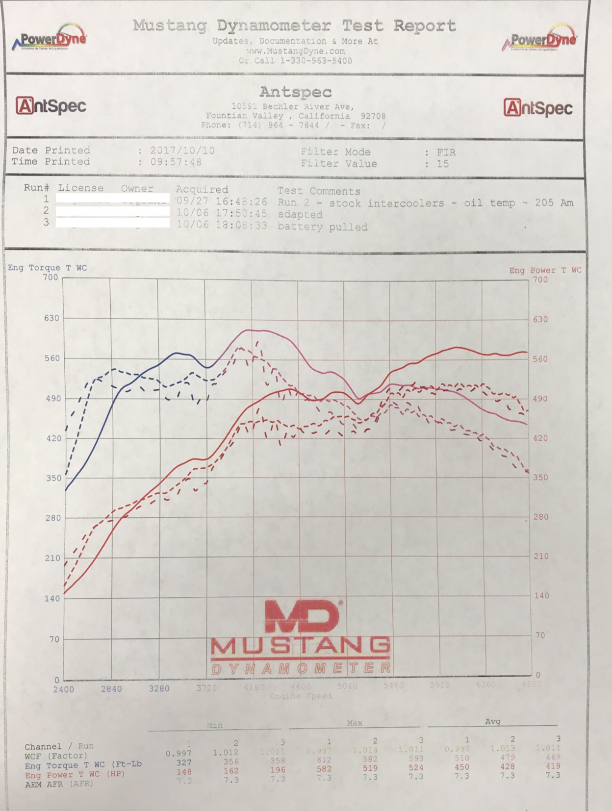

I was mostly happy with the tune, car felt definitely faster my only gripe was the power delivery seemed to be more on/off or spikey and not as smooth or progressive as stock.
After this I bought the Bydesign intercoolers. Got them installed and asked if a special tune was available for the IC's but was told there is no special tune for the IC's and running the same tune was recommended. I ran it on the Dyno before and after and showed that I lost a bit of power:

I was disappointed and went back to stock IC's and my plan was to sell the aftermarket IC's. Talked to Sam and he told me he would be willing to sell them for me but also told me that if I hold on to them a tune would be out soon and felt 100 percent confident it would make more power and less turbo lag with a custom tune.

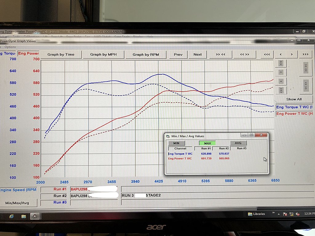

I trust Sam so I waited. Contacted him again when I saw his IG post of some successful tuning on the 991.2. I sent my car to him on a flat bed in Torrance, CA and he installed the ByDesign coolers and checked what my car made on my current tune then switched to his custom tune. The results were spectacular:

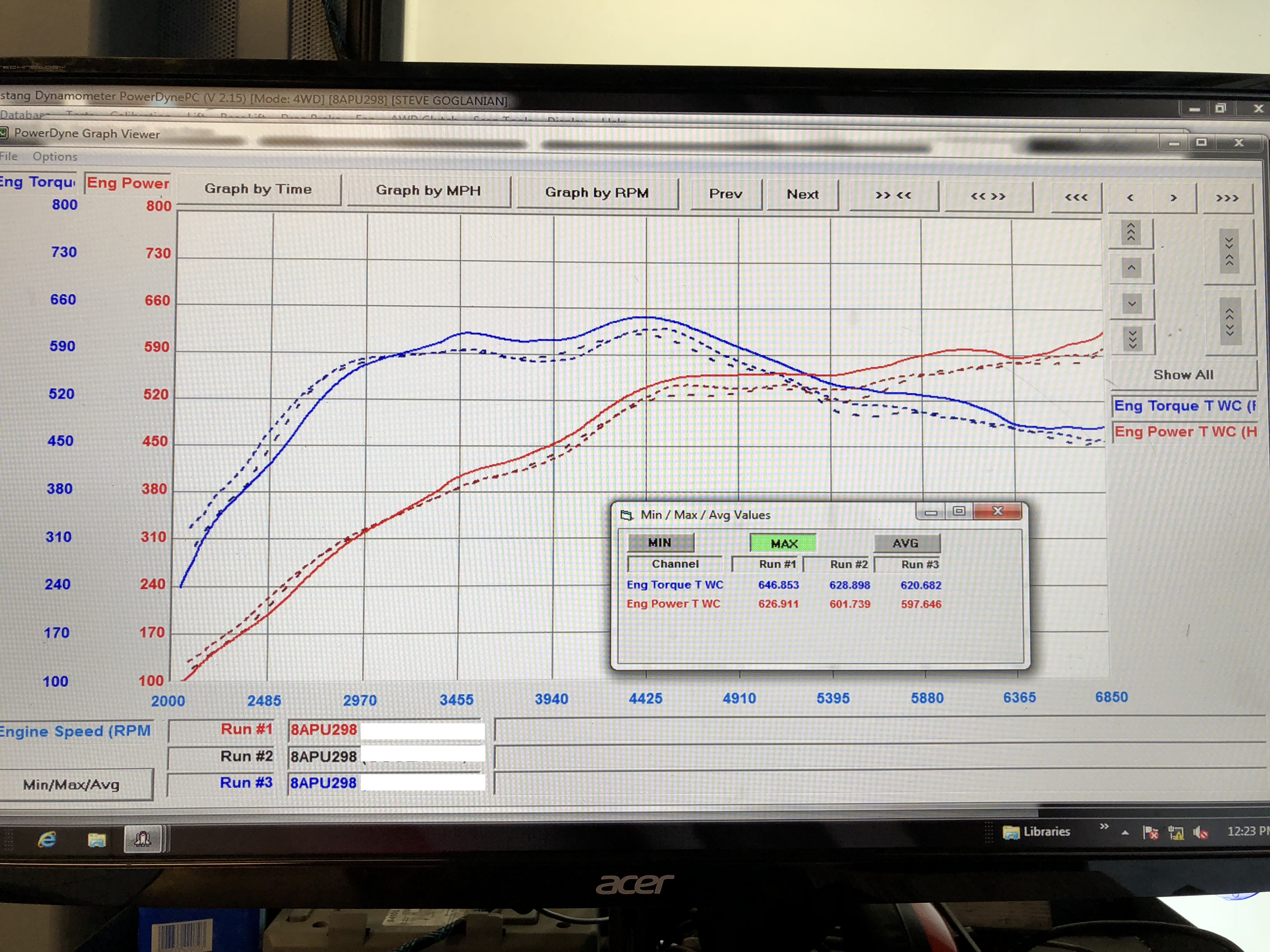

Another thing I like doing to test turbo lag is having the car in third gear at 3K rpm. Then I pull up the turbo gauge PSI, after hitting pedal to the floor I time how long it takes to hit max boost (19psi) I run it about 5 times and and with the stock intercoolers I get between 1.91-1.98 seconds on all my runs
With the Bydesign IC's I am getting between 1.68-1.75 seconds!!! This may seem like not a lot but it is a HUGE difference in felt turbo lag. The response is so much more immediate.
Here is three runs with ByDesign tune and ByDesign IC's:

At the same time the power delivery feels way smoother than my previous tune which is what I love the most. The car feels like the torque never tapers off and stays so flat. Everything is easy to modulate. I can't recommend enough Stage 3 with Sam and his custom tuning abilities.
*Note all my runs are done with 91 octane. *
