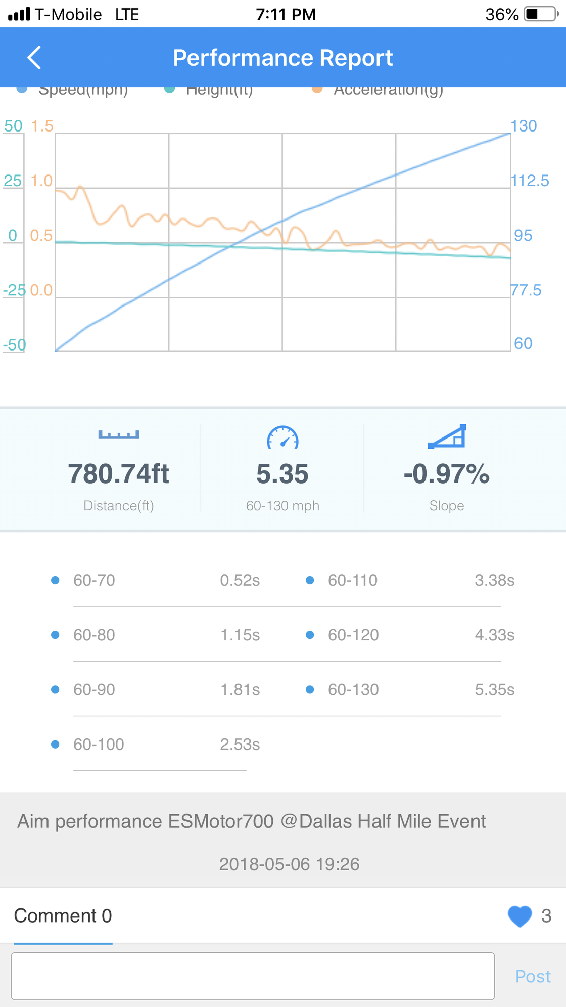

I've checked all the dragy posts of around that 60to130 nunber... And none of them exceeded 960ft in distance to do the time of 6.XX to 7s
I believe you need to do a re run bro.

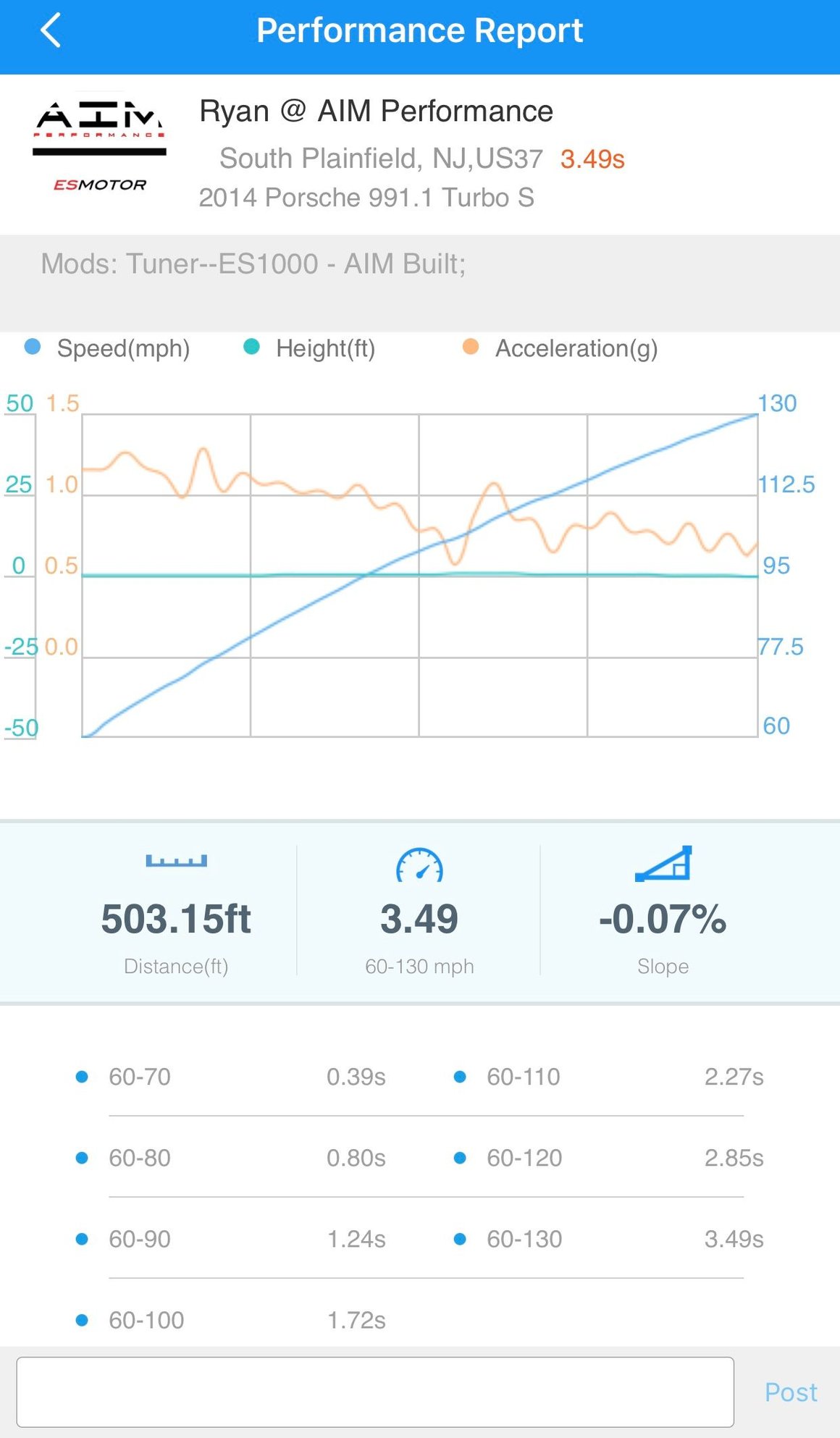

As I have informed you on dragy, your 60-130 of 6.72 is not genuine, as the numbers that lead to that time are beyond skewed. Even with that aside a tune only 93 pump gas 991.1 with a passenger is never going to run a 6.72 if the mods listed are true.
Thats your full dragy graph, you stated that the G's might be off because the dragy "might" have moved but the timing will still be accurate. Thats incorrect, and as I've stated on dragy I will show why.
Thats dave's 60-130, a car that makes double what your car makes at minimum, look at the differences in G's first, then look at the numbers after.
There is no question that is skewed, as your car is accelerating faster than a 1000whp from 60-80 but then like a 525whp from 100-130 while being a 525whp is impossible.
My car making 750whp vs yours , your car is faster than mine from 60-100 but slower 100-130. Skewed would be a compliment, impossible is the word.
Lastly compare the distance it takes both cars to do the same thing. Impossible to have such a difference.
Even your quarter mile time is skewed as the it pulls crazy G's in the beginning, which its definitely not doing stock with a 93 tune and on the horrible stock Pirellis.
