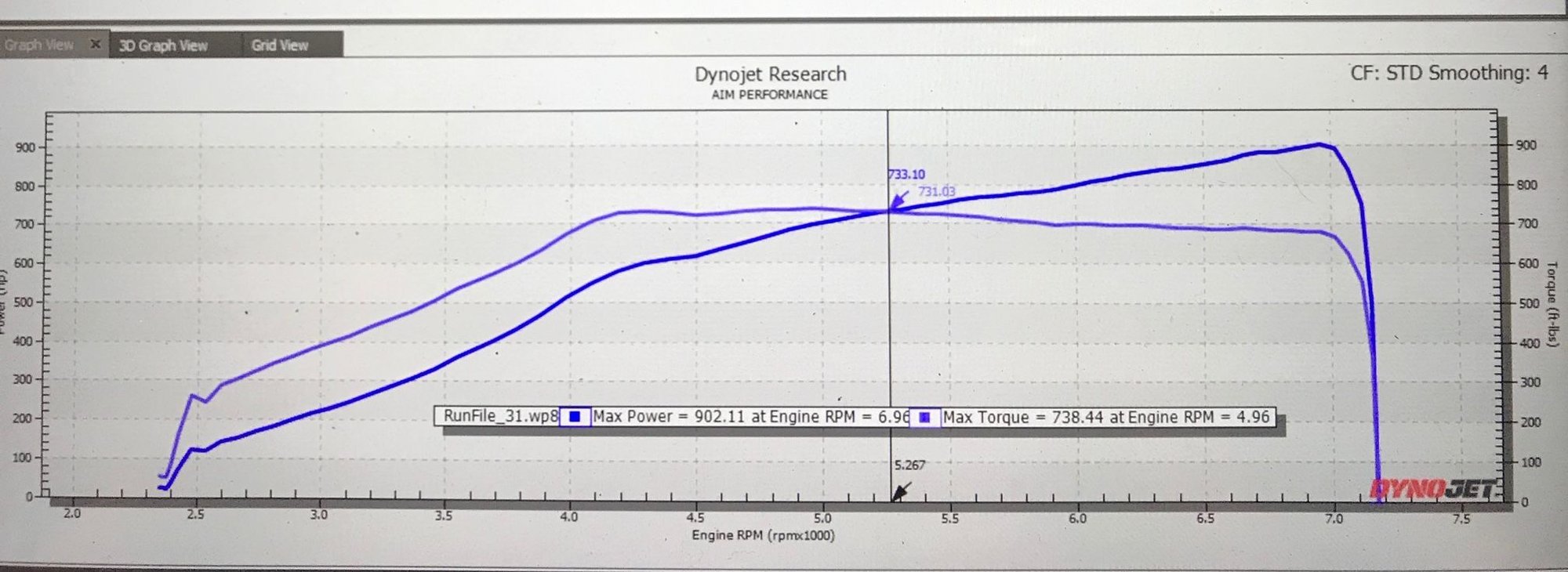

8s STOCK MOTOR!
2 weeks ago we picked a bone stock high mileage silver 991 Turbo for shop/development car purposes. With the tremendous success of the bolt on ES850 kits we decided to get our own car to push it further than ever before and crush the stock motor 1/4 Mile record of 9.35 held by one of our customers ( Igor K) white ES850 package car. With that in mind the ES850R was born. Addition of Syvecs S7+ ECU, Dodson clutches and extra 1.5psi max power setting differentiates the ES850R from a standard ES850.
Couple days later we had the AIM-ESMOTOR 850 kit installed and took the car for some shakedown passes to Indiana ShiftS3ctor where it won the German Car class in ES850 trim with 185.5MPH 1/2 Mile, making it the second fastest stock motor 991s in the 1/2 Mile after our customer emaspeed 186.6MPH yellow ES850 package car.
We did some fine tuning and weight reduction in the past couple days.
Last night we took the car to Atco with a plan to dial in the 60ft first and then go for a full pass, since we could only make one full pass before getting kicked out. First hit was a 1.45 60ft and we were shooting for 1.40 to hit 8s, let out. Atco was so packed that the second run didn't come until 11pm and it had to be a full send. Car went 1.43 60ft and 9.04 ET on the Atco clocks and 9.06 on the Dragy with a 156MPH trap.
Other notable specs and info include:
0-60 MPH 1.96 Seconds (1ft Roll Out - this method is used by car magazines))
0-60 MPH 2.25 Seconds (No Roll Out)
60-130MPH 4.22 Seconds
100-150MPH 4.26 Seconds
DA +767ft
MS109 Fuel
Mickey Thompson Rear tires
900WHP tuned on Syvecs by Emre @ ESMotor
Regular Tuesday night Test & Tune session, no special prep etc...
STOCK MOTOR
This car is the fastest stock motor Porsche in the world on the 1/4 Mile, 60-130MPH, 100-150MPH
We would like to especially thank Emre@Esmotor for the support on this project along with do88Hy and Dodson Motorsport
Check out our Instagram for video of the pass! #AIM2WIN

Forgot to post a major update on the silver 991 shop car build from a couple weeks ago.
8s STOCK MOTOR!
#TeamAIM
