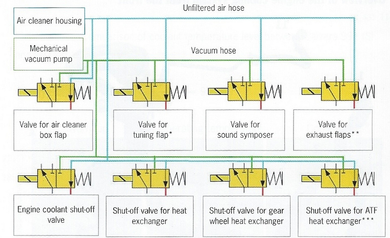

Change Over Valves failure - part 2 I found the following schematic about the vacuum system in the 991 Service Information book (you can buy it from Suncoast BTW): It confirms my fear that more critical items can go wrong due to failed solenoids: I.e. shut off valves for engine coolant or ATF (= automatic transmission fluid for PDK). The Porsche document nevertheless mentions that "electric solenoid valves in the vacuum system are fully diagnosable (short circuit/open circuit); electrical faults result in an entry in the DME control unit and the PDK unit". I nevertheless did not get any alert for my failed solenoids and will definitely get the other ones checked ASAP.
WOW, that is scary. Very interesting that they use a mechanical vacuum pump, apparently the vacuum source from the intake isn't consistent enough. Seems like a lot that can go wrong since all of those things could be taken out by a single hose dying. I wonder what the airbox flap does. (the tuning flap is likely the intake manifold, and the others are self explanatory)

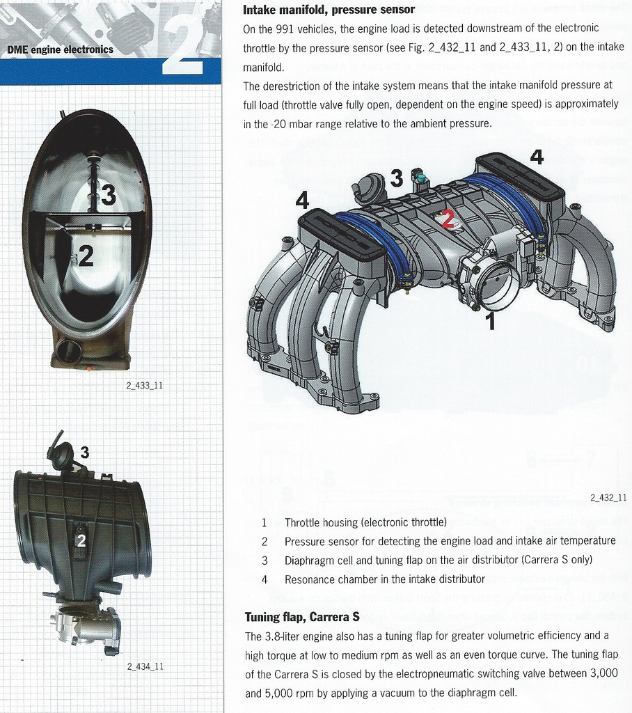

The airbox flap is no big deal in fact. There is a silencer (resonator) located in the air cleaner housing that is activated by a flap (controlled by one of our infamous solenoids). The resonator is closed for the most part and is open between 4,500 and 6,000 rpm.
The valve for the tuning flap (on the 991S only) is more interesting. The tuning flap is closed between 3,000 and 5,000 rpm and increases torque.
Everything is explained in detail in the attached schematic:
Despite the failure of the solenoids, the attention to details and technological refinement of OEM parts make me seriously question the relevance of some aftermarket mods, Take the plenum for instance, the Porsche part may be made of plastic, but is is equipped with a pressure sensor and tuning flap. Stuttgart engineers have spent hours making this optimum and I often struggle understand why a basic mechanic would be so much smarter by fitting something different.

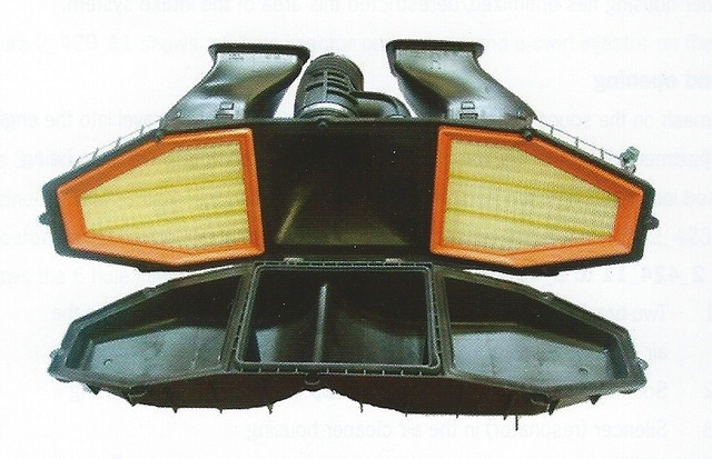

The same applies to the airbox on the 991 IMHO:
if you look at how it is designed, it gets air where it is the coldest (outside of the car), the section is large and the filters are big, it is made of plastic which insulates better, has a low thermal mass and has a smooth finish and is shaped to minimize drag. Except for maybe installing high flow oiled filters (I did), I do not see how to perfect it.

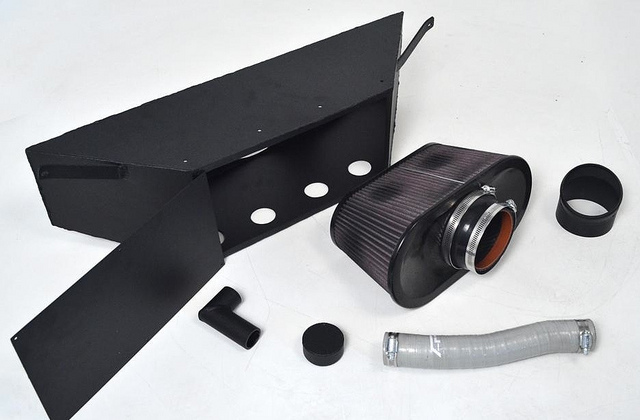

But then, you have geniuses in a garage who put together 6 plates of metal, a big conical filter and a few bits of silicon hoses, name it a high performance cold air intake box and call it a day:
You can of course count on them to come up with dyno curves showing how much better they are that the complex Porsche design that was probably aimed at limiting the power of the car
I am not picking on aftermarket mods here. I like them a lot (and have done of lot of them too), but we should not underestimate the quality of the OEM design. There is a reason why P-cars are expensive and it is not only because of deviated stitching. Let's just exercise good judgement, keep a critical eye on things and discuss with vendors/tuners the true merit of their products first.

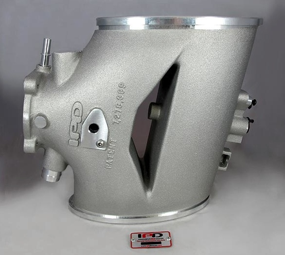

I just installed IPD for 991, IPD do have the same flap as OEM. You simply need to remove both actuator and pressure sensor from the plastic OEM plenum and re-install into IPD plenum. It is pretty straight forward job, so IPD is design to work with the latest gadgets from Porsche.
One good thing about 991 is the infamous solenoid which controls the tuning flap is not located at the back of the plenum as it was in 997 so it is much easier to replace it on 991.
Thanks for the info about the new IPD plenum. Pics on their website indeed show that the OEM gizmo's can indeed be simple transferred!.
There may be a thread about it already, but what are your impressions about the new plenum when you are behind the wheel?

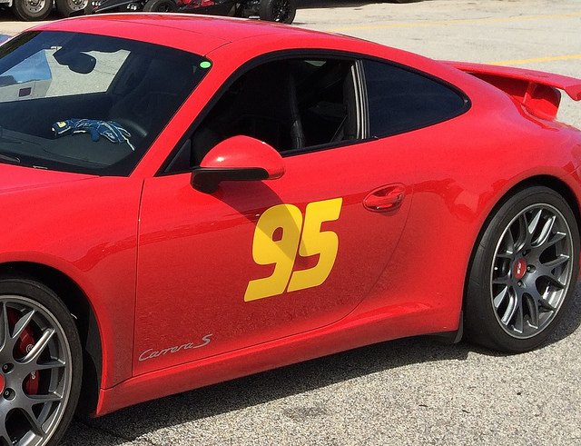

To make things worse, I went for Lightning McQueen-ish numbers on the car this time. Huge success with Petrolhead jr !

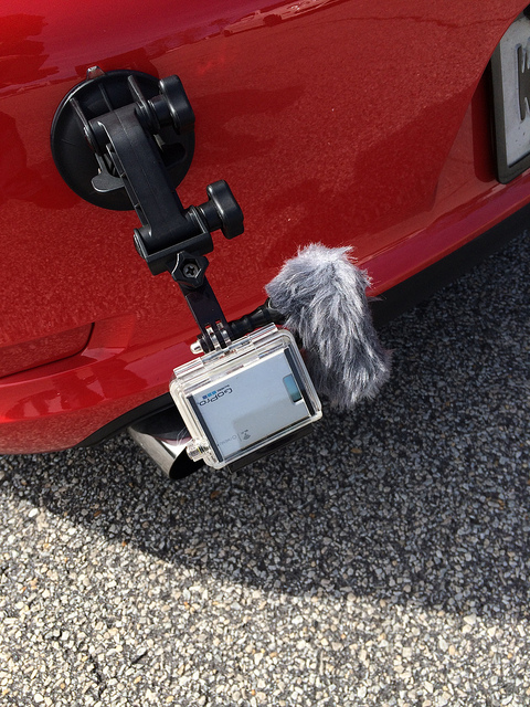

I also took the opportunity to record a longer sound/video clip of the AWE switch path exhaust. It sounded great and got me a lot of compliments from other drivers
Here's the GoPro ready to shoot:
and the video clip:
