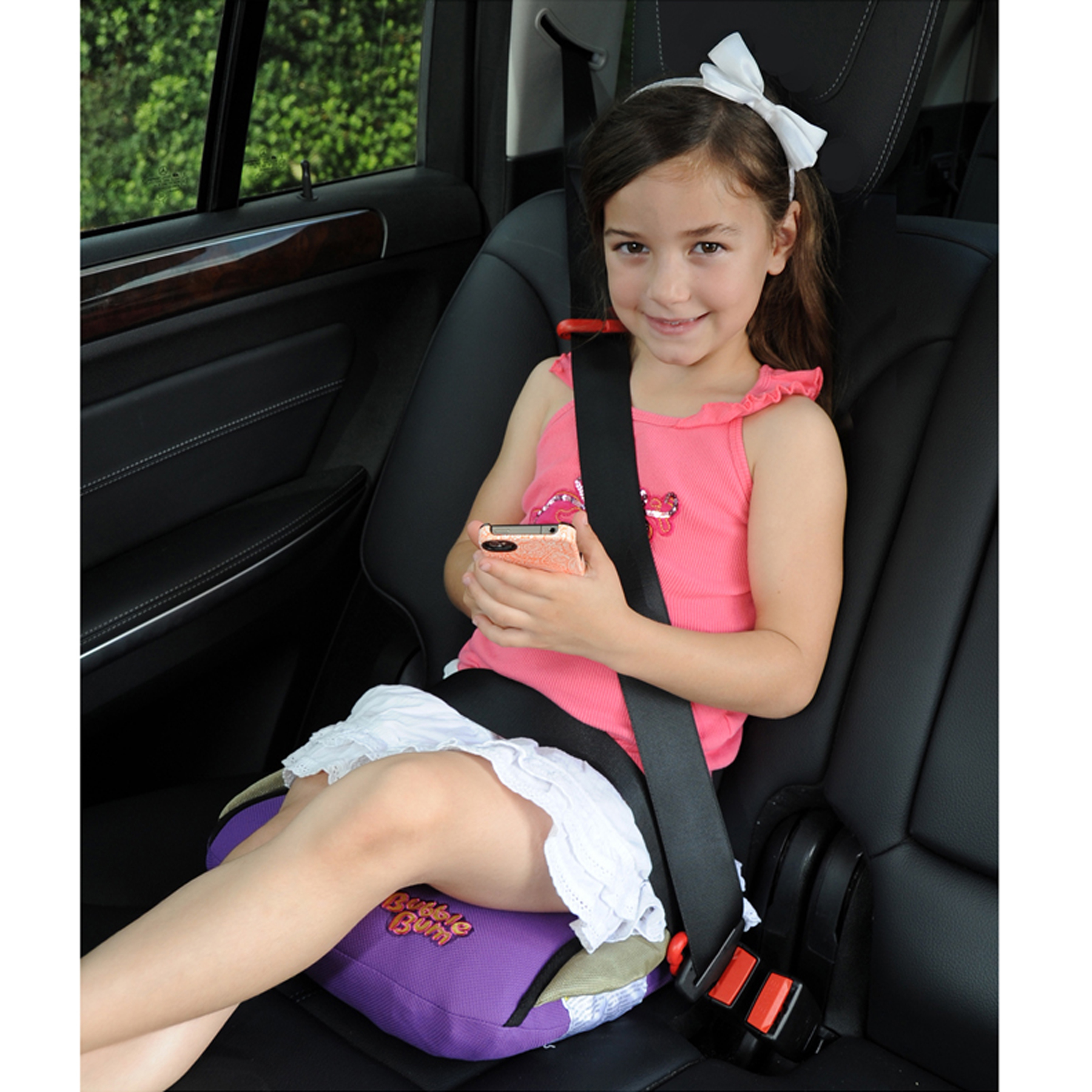

The Bubble Bum has two loops around the hips and a strap behind the child's back that, if adjusted properly, keeps the belt correctly across the child's shoulder. If you google "bubble bum" images, you'll see what I mean. Here is an example. Look for the red loop above the shoulder. That's the strap I'm talking about and that's all that's needed:
Whether your kids' head is going to hit the roof and/or is above the backrest of the seat itself is a different matter. Mine are pretty tall too and their head is not fully above the backrest and certainly far from hitting the roof. Of course, the 991 backseats don't have a head rest. If that's a concern, you may be able to slot a padded board or something similar with a cushion protruding forward at head height in the deep vertical space that's behind the backrests and the rear stowage perhaps. I don't do that.
Edit: In the photo above, I'd say the back strap isn't tight enough. It should pull the belt lower. See the instruction PDF.
