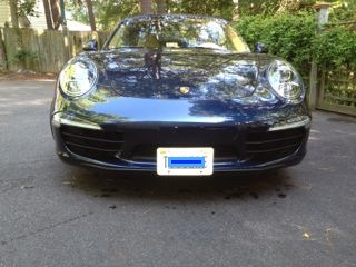

Well, it happened again. Another "No front license display" ticket. Less than a month after purchase and while still carrying the temporary 30 day tag (in my trunk). So I went ahead and bit the bullet.
No drilling on painted surfaces.
Here are the parts I used:
2 each angle brackets
2 each bolts with nuts/washers
2 each plate screws

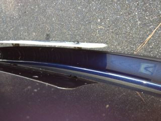

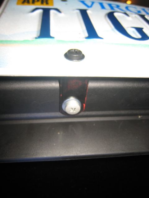

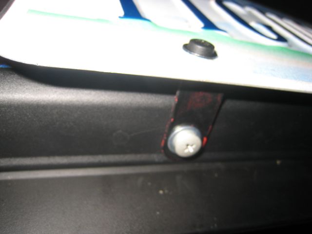

I attached the angles to a plastic piece that protects the bumper. This is an unpainted black plastic "lip". This black plastic "lip" appears to be solid plastic. I initially intended to use an insert and a screw but ended up not using the insert at all and just used the screw.
Disclaimer: No painted surfaces were abused, damaged or touched!

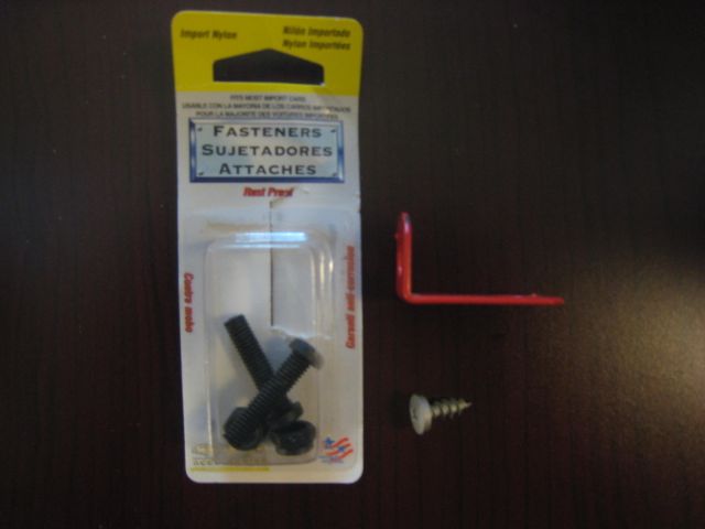

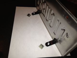

The angle bracket (also known as "corner brace") is an "L" shaped angle 2 inches x 1 inch. I found it laying around in my toolbox. It was red so I painted it black to make it less noticeable. You should be able to find these types of braces at Lowes. Here is a link to a similar item from Amazon: http://www.amazon.com/Ace-01-3404-248-Corner-Brace-2-1/dp/B000OON7T8
The bolt with screw are made of nylon. They are typically sold to secure license plates. I had a few bolts/screws laying around but they were too long so once I tightened the nut, I cut the bolt to allow me to position the plate as close to the bumper as possible. A picture is attached. I can't recall where I bought these but it was either Lowes or Pep Boys. Here is a link to Amazon for something similar:
http://www.amazon.com/Cruiser-Accessories-80150-Fasteners-Import-Nylon/dp/B00032K50U
The self-threading screws came with the license plate holder provided by the dealer.
I hope this helps. If you click on the pictures you can see them better.
