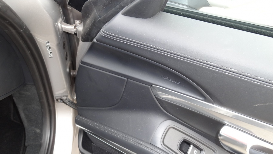

First of all, jmmk, great explanation on the quality of leathers and the process require for automobile use. To the OP's specific point in his post above, I agree with him that the 991 standard 'black' leather appears to the eye a little more 'charcoal' than the old standard 'black' found on the previous 997 model. First photo attached shows a door panel of a 991 in 'black'. The second photo shows a door panel of a .1 997 in standard 'black'. Perhaps you can see the slight difference we are seeing!

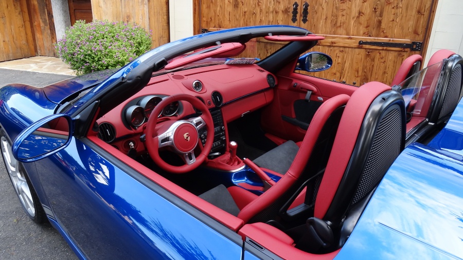

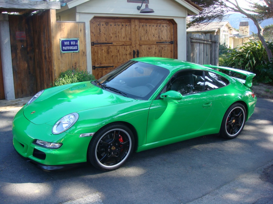

I am going to delve in this subject at some length in my upcoming thread on 'Porsche Exclusive'. I first became acquainted with the world of 'special order' when I started pursuing my current 'Crystal Blue' 1970 911E Targa (see Avatar) back in 1980, which I eventually got in 2008. Since then I have learned quite a bit on the subject of customizing exteriors and interiors at Porsche. Most recently I have had a 'Paint to Sample' 997S in 'Signal Green' (3rd photo) and just last year custom ordered a Spyder from the factory (4th photo). What I learned from extensive, months-long dealings with 'Porsche Exclusive' on that last order I tried to explain to forum members at Rennlist on the linked thread below, which has already received over 5,800 views:

A bit OT, but Eduardo that Aqua Blue Spyder is sick! I don't have the guts personally to make that color my daily driver, but it is beautiful!
