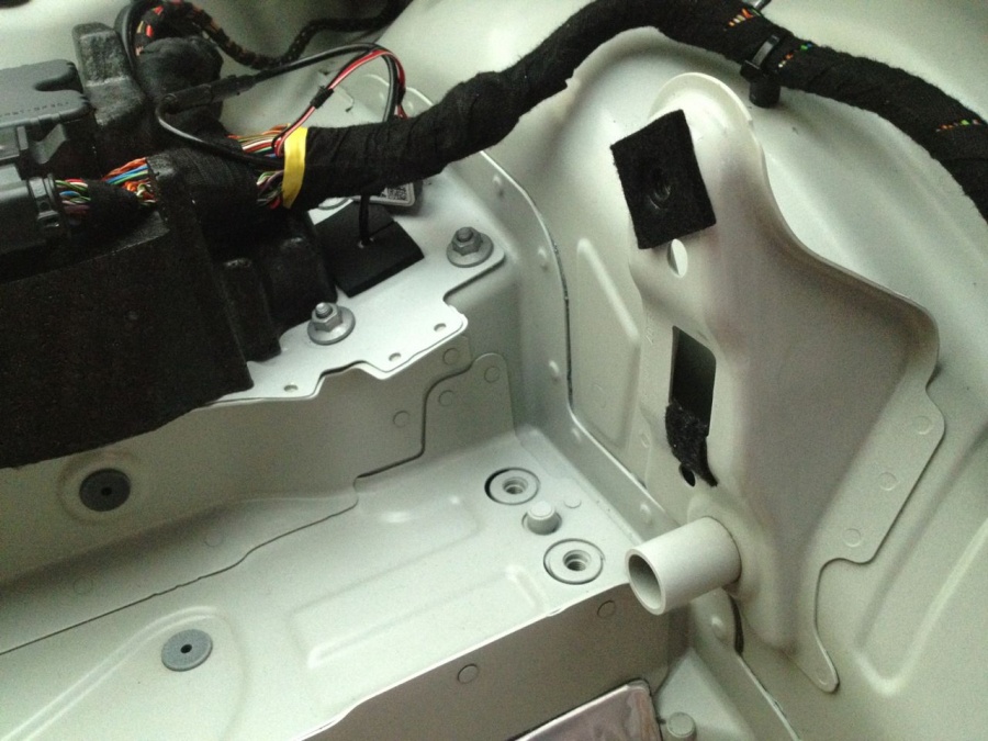

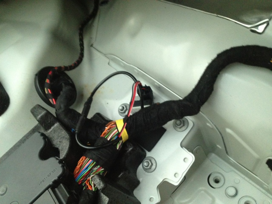

Hi
I am having trouble with rear suspension noise, I visited the dealer a couple of time without success. I already ask my mechanic to re-torque the suspension but still having noise.
Tonight I decided to take out the rear carpet, and retightened the strut mounting screws but the noise still persist.
So, I decided to take video to show your guys, I ran a car back and firward over bumps at my house and Hope you can hear the noise.
Check out this video on YouTube:
http://www.youtube.com/watch?v=sM-di0RAokg&feature=youtube_gdata_player
- it happen 60% of the time when I hit the sharp bumps ???
- some times it happen during the turning or braking even on smooth road ???
Your input is gravely appreciated.
Ps. I live in Thailsnd and no Porsche suspension expert to deal with so please help.

A nasty noise still does not come back yet! I also forget to mention that when i visited the dealer to ask them to check PDCC, I did ask them to re-torque;
1) Strut mounting to the body (3 nuts), 26 ft-lbs
2) Strut mounting to the piston rod (center nut on the strut), 59 ft-lbs
I do not know if it is the right torque's figures or not, i just search from internet forum for 997 spec.
Now my car is noise/rattles free so happy
