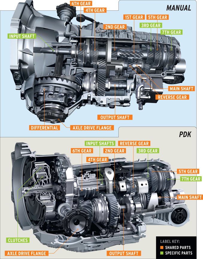

Recently received this message from a Porsche representative.
"Unfortunately, it is not possible to retrofit the rev-matching technology
to an already existing 991 C2 model.
This would require the change of the whole transmission unit as there are
additional sensors integrated in the transmission box."

Looks like it's right in between the manual and the PDK. Maybe the best of both? Hey, what if it's really a modified PDK and the clutch pedal isn't really connected to anything (or is a fly-by-wire clutch pedal). Just saying.....

Sounds like 'rev-matching' is a better term. I doubt it is truly doing a double-declutch like in the days of yore before synchros. (i.e. clutch in, shift to neutral, clutch out, clutch in, shift to next gear, blip throttle, clutch out)
So, basically they are making a PDK with a superfluous clutch pedal?

I thought that the 7 speed is basically a PDK unit with a clutch... no?
If it's a true manual, then it should be quite different from the PDK -- eg mechanically simpler, only one clutch, etc. I was jus joking that they might get to the point where the manual version is really just a PDK with a somewhat superfluous third pedal.

Here ya go guys.

Sid:
You are amazing in that you consistently come up with such great new and technical images!
