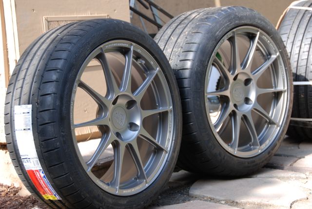

After my 2-day DE with PCA-GGR at Thunder Hill, I feel that the stock tires probably won't last too long with a couple of more DE events. I measured the tire depth with a gauge, and both front and rear shows 6/32 inch, with 5.5K miles. So I decided to get a set of 19" wheels since tires will be cheaper for the smaller size, and should be lighter too.
Checking prices on Tirerack, I see the prices for OE Pirelli P Zero as
Front 245/35/20: $365 each
Rear 295/30/20: $525 each
Since I want to keep the same overall tire height, I went with 245/40/19 Michelin Pilot Super Sport for the front, 295/35/19 PSS for the rear. They are $287 front, $452 rear.
Now, for wheels I narrowed my search to OZ Superforgiata and HRE P43S, and decided to go with OZ since they are cheaper on Tirerack and are amazingly light. According to Tirerack's web site, front is only 16.5lbs, and rear 19lbs. So I pulled the trigger and have Tirerack mounted and balanced the wheels with TMPS installed too. Jonas at Tirerack is very professional and helpful, and two days later the whole set arrived. That's really fast!
I spent this Sunday morning swapping the wheels, and also use my bathroom weight scale to check the actual weight of OZ wheels vs OEM Sports Design wheels. Here's the result:
OEM Sports Design front: 48.2 lbs
OEM Sports Design rear: 62.5 lbs
OZ Superforgiata front: 41.8 lbs
OZ Superforgiata rear: 50.2 lbs
Needless to say, I am pleasantly surprised. 6.4 lbs lighter in each corner of left & right front, and a whopping 12.3 lbs lighter in each corner of left & right rear!

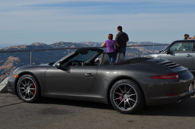

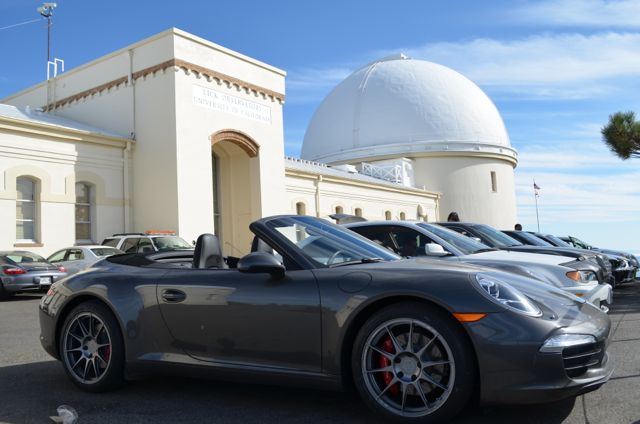

After tightening the wheels to Porsche's torque specification of 118 ft-lbs, I was eager to try it out. I decided to go for a back road drive up the mountain to the Lick Observatory in the south bay area. The drive up to the mountain is very twisty and narrow, and average speed is about 35MPH, so I won't be going too fast. It should also give me an idea how the new wheels and tires handle.
On the freeway I did not feel much difference. But once I was on the mountain road and started to take these corners, I immediately felt a difference. The car seems more nimble, and turn-in is sharper. Compliance is excellent, never harsh, and grip is phenomenal. The onboard G meter said I hit 1.0G turning left, don't know how accurate it is, but that's amazing. Usually new tires are greasy, but I didn't feel it at all. PASM & PDCC kept the car flat, and I had a blast. I have to restraint myself from pushing faster since this is not a track, but my confidence on these tires is very high.
Compared to my last 997.2 with 19" HRE P43/Michelen PS2, the new 991 does not push as much, and i have higher confidence pushing it to the 7/10 limit. The 6 piston front brakes are amazing too. Overall I am very satisfied with the OZs and Michelens. Next weekend I am going to Thunder Hill again for the Hooked on Driving event, and will see how these hold up on the track.
I took some pictures, see below:
1. Front & rear (left to right)

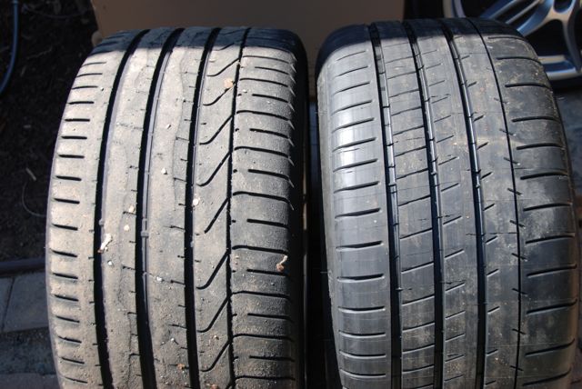

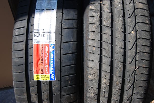

2. Front tires comparison. Left is Michelen PSS, right is P Zero. P Zero seems to have picked up "marbles" from the track, although wear seems to be uniform.
3. Rear tires comparison. Left is P Zero, right is PSS. Again, "marbles" and wear seems uniform. Maybe PDCC is helping the tire stay flat during cornering?
4 & 5: How the OZ wheels look on the car. The color is sort of muted gunmetal, compared to stock's bright silver, and seems to make the whole a bit understated.
Now I wonder if there are lighter aftermarket brake rotors...

I just finished a 3 day track event at Pocono. My rears have worn better than expected (I think they have at least a few more track days in them) but the front left started to shred on Day 1 and now needs to be replaced. I blame this more on this track, which I'm told is known to be v abrasive, than the tires. In fact, 3 drivers corded their tires in the first session on the first day (it's a newly paved NASCAR track).
Anyway, re PDCC and tire wear, absolutely IMO I think it makes the tires wear more evenly. Even on my ruined front tire, it was away from the edge (in the outboard) and no cording -- I still ran days 2 and 3 on it with no issues.
