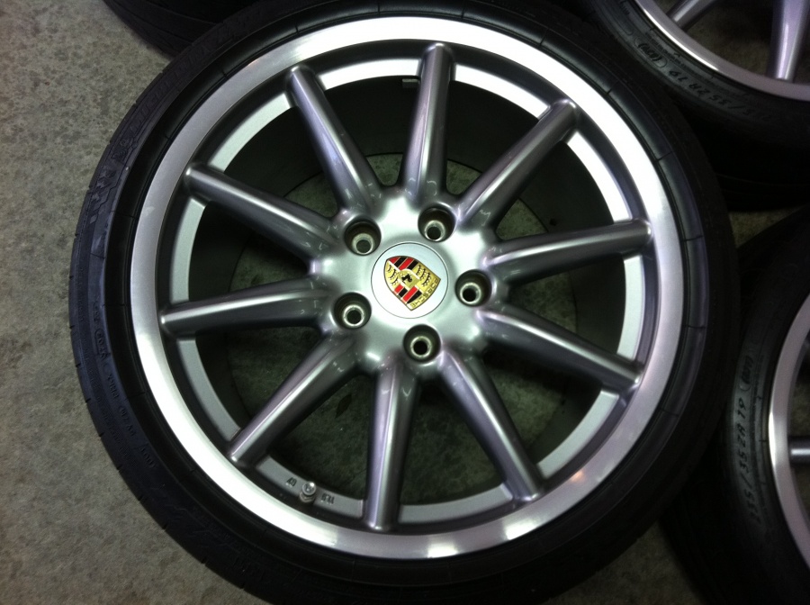

997 C4S Rims on 991 C4
I have every intention of adding a 991 C4. Before I make a big mistake and sell my C4S winter package at 25cents to the dollar I was wondering if anyone has any experience on whether they will fit the 991?

Ok finally got the answer for this and will share . So yes the fronts will fit fine with a slight difference in offset (marginal) but the backs will need a spacer 15mm or so to fit. So I don't need to sell them

Hi Jo!
Listen the circumference on the 997 tires are about 1" smaller than that of the 991.
This means your ABS, speedo etc will be off, if it's more than 4% than the whole ecu will go crazy and give you mayor problems... now if your planing to put them on a C4/S it will damage your awd coupling system as well... not to mention void your warranty!
Then there's the fact that anything smaller than a 19" rim will physically not fit over the suspension components.
Sorry buddy, but the offset is the least of your problems.

Ok so help me understand this more. Here are my wheel specs
Dimensions (997 Carrera 4):
Front - Rims: 8.5 x 19 55mm - Tires: 235/35 ZR19
Rear - Rims: 11.5 x 19 50mm - Tires: 305/30 ZR19
Here are the 991 Specs (Base Carrera 4)
Front - Rims: 8.5 x 19 54mm - Tires: 235/40 ZR19
Rear - Rims: 11 x 19 48mm - Tires: 295/35 ZR19
I believe I can I atleast keep the Rims and sell the rubber? The reason I ask is that the RIMS come with separate rubber for summer that I could sell as a packagel. My only question is will the TPMS work?
