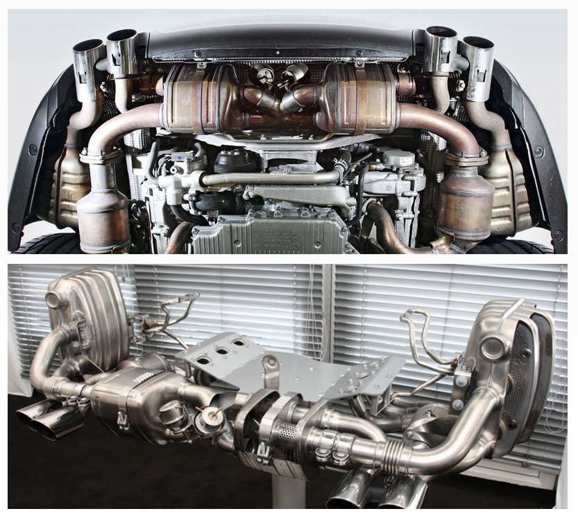

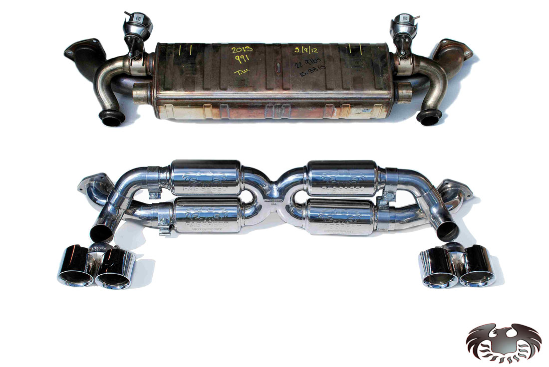

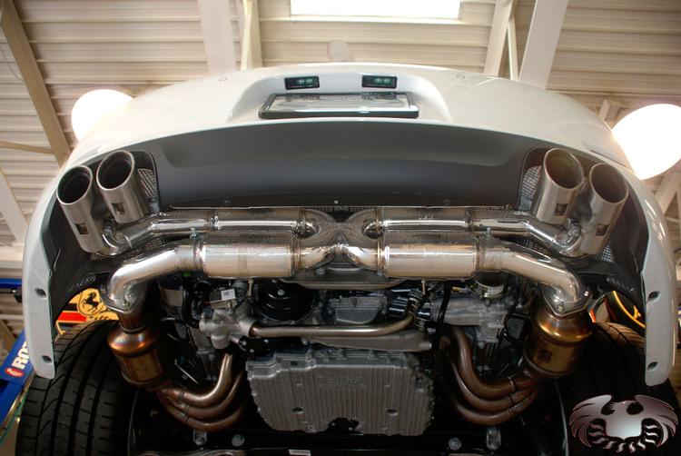

The X-pipe basically replace every exhaust component from the 991 (from the cats back), whether it be PSE or just stock exhaust.
You can also get 200 cell cats (which are less restrictive, more dB + some torque) but be forewarned replacing the cats will void your Porsche warranty, if you replace the whole cat back system there's no issues with that (X-pipe).
There's is no valve on this system, perhaps they'll come out with one in time but currently they don't.
Hope that helped.
Cheers!
Stock PSE exhaust for C2/4 S
Fabspeed X-pipe (eliminating side mufflers).
Stock C2/4 S with Fabspeed X-pipe... the bottom one would replace the top one.
