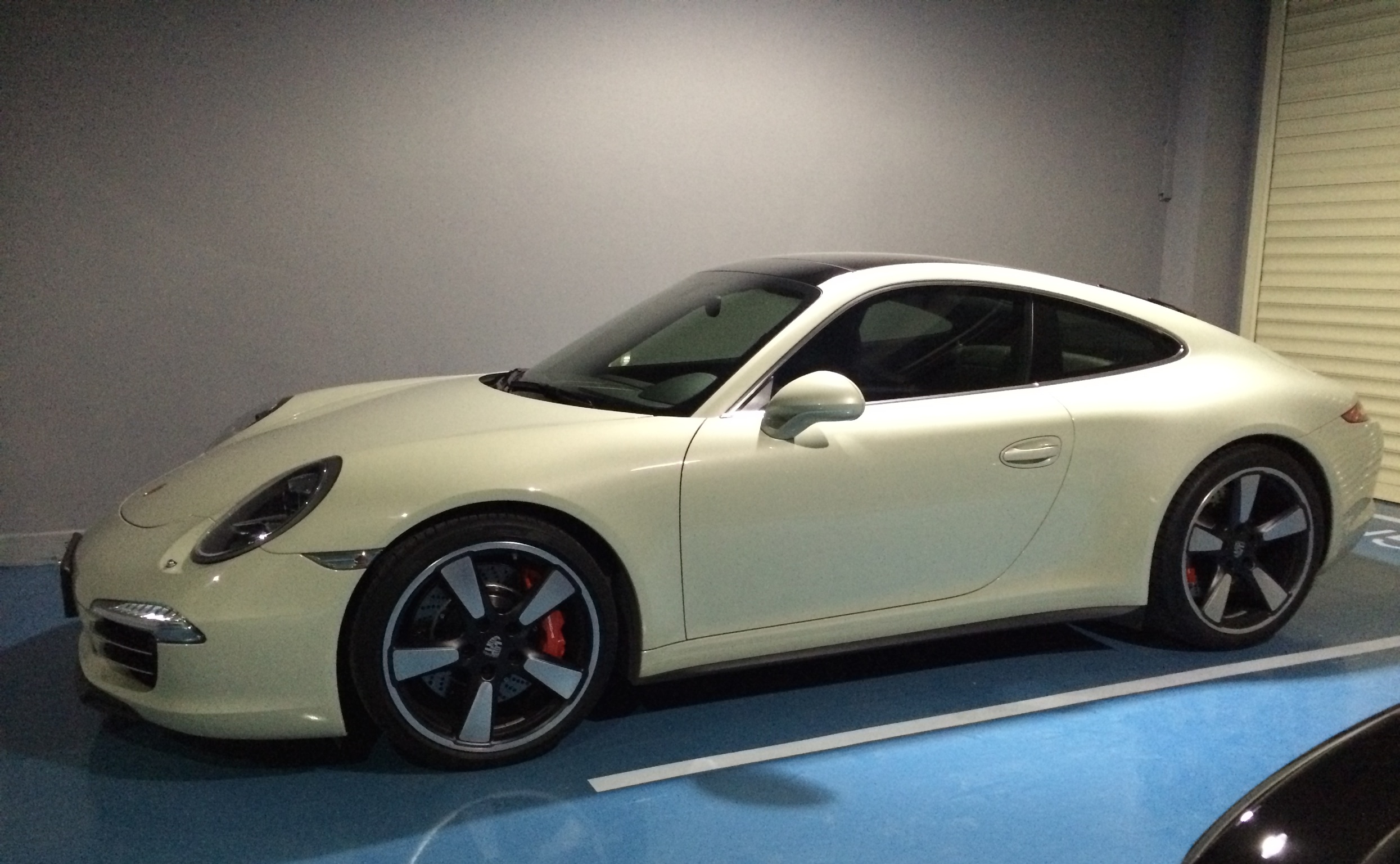

Originally Posted by MMK110464
Please let us know what year/model you are driving.
MY 2013 911/50 3.8ltr (w/o power kit)
