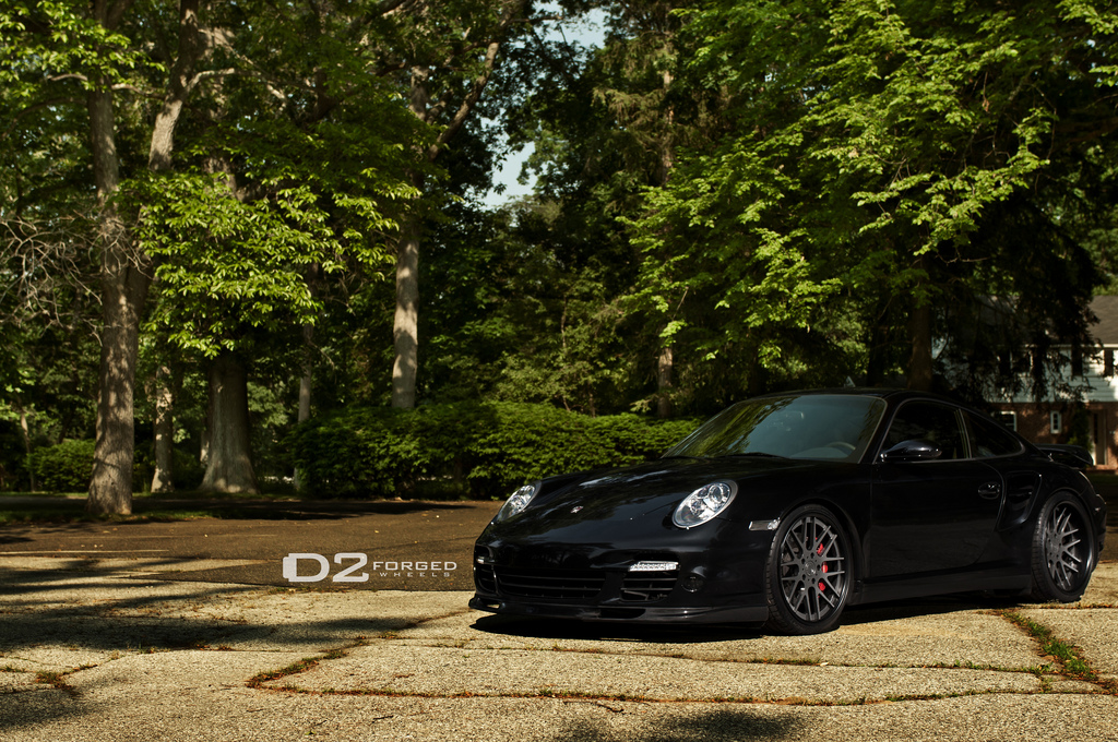

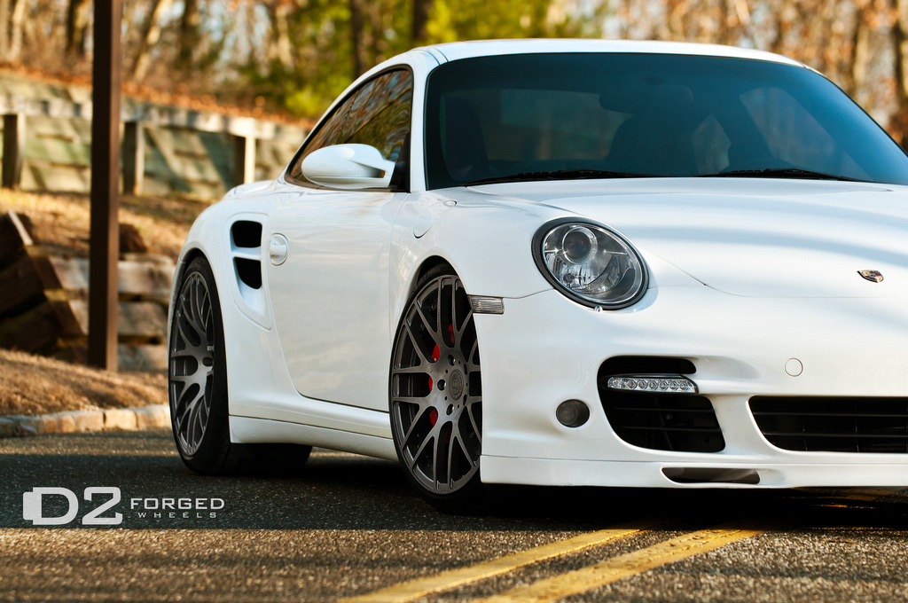

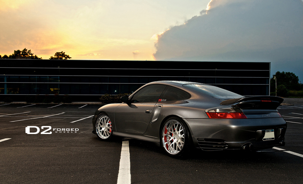

Hello. Just to chime in, we make monoblock and three piece forged wheels. Here's an example of our design done in MB1 (monoblock), CV1 (three piece concave) and FMS01 (three piece entry level forged wheels).
