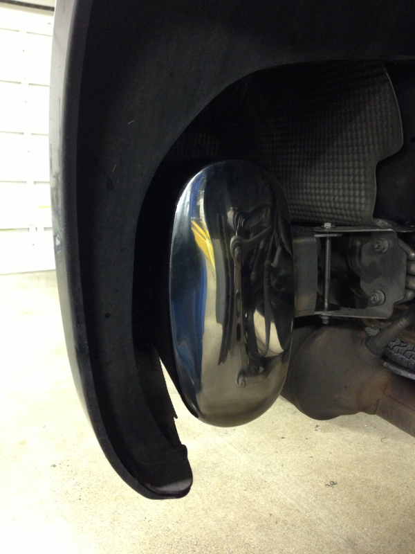

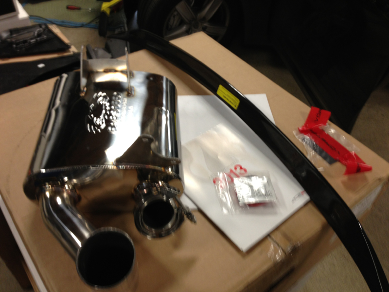

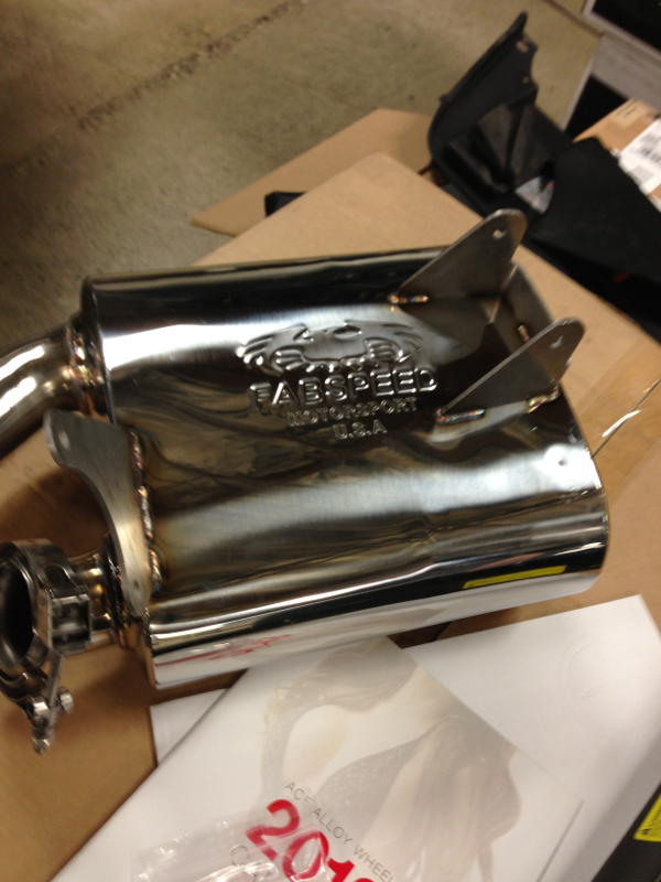

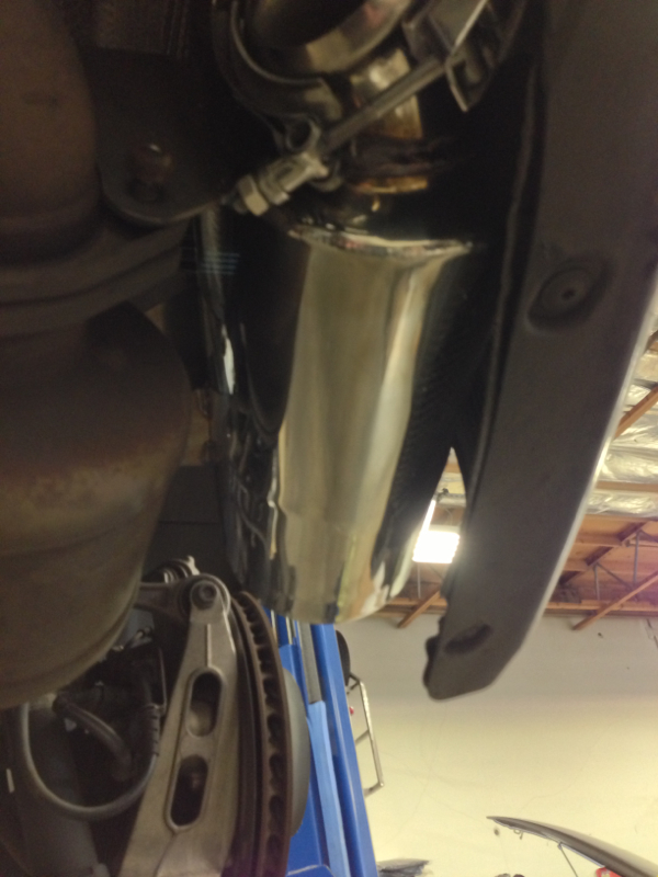

Yes- side mufflers don't need rear taken off. Don't know about center main as leaving it on (factory PSE). Might do headers/cats later (keeping factory PSE ETC)
At install now. Apparently the pipe connections are not correct from Fabspeed and we have to shorten the pipe to fit the tips. Sigh. Benchmark is doing everything they can though with contacting Fabspeed and trying to resolve this.
Update: car driven with mufflers installed to nearby muffler shop for adjustment of pipe leading to tips. Live blogging from the waiting room, lol.
Update2: Fabspeed's piping to the exhaust tips from the mufflers that we ordered only currently fits cars without factory PSE. We had to fix our own pipes, but got it done. Fabspeed needs to make piping for cars with PSE *and* without. This was a whole-day-long hassle and I'm a little frazzled by the whole thing, but thankfully Justin Karis at Benchmark was on it and got things handled. Thanks Justin. Everything is on and works. There is more rumble down low and its smoother up high on the revs. Feels a bit extra punch over 6000 rpm even without anything else installed. (but thats my butt-dyno)
Sound is tough to explain - it's very much like the 991 PSE before but has slightly more pronounced crackles and pops and it is more focused, if that makes any sense. It has a pleasant more-exotic (imo) resonance in normal driving that was missing before. It's just a bit louder, not too much with just the side-mufflers..but now I really want to add the headers/cats. hehe. I don't have a good driving sound clip, just a few revs atm.
