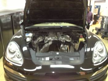

my cayenne s 2012
This was my cayenne 7500 k/m with tik tik engine sound and low coolant level , they changed the engine under warranty
