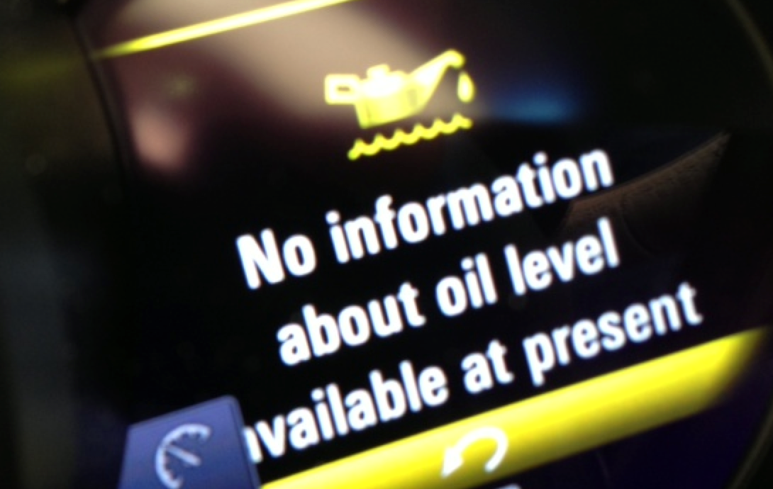

Question Message: "No Information about oil level available at present"...
changed break-in oil at 1500 miles today...(looked pretty dark)
but I am getting this message now and I am unable to measure the oil level!...
followed manual instructions 7.9 qts..pressure look alright..

Info will appear after the oil warms up. Relax. It freaked me out too.

well..ok but I did warm up big time and I kept on getting this message..
will update later..

Had the same thing happen to me a couple of weeks ago at my 2nd oil change, 4,600 miles. I was absolutely postive I had put in just under 8 quarts and there was no leak so I drove it on a fifteen mile trip and kept my eye on the pressure which was OK. It still did not measure the level. But, the next day, after driving a few miles, it started showing the level and has worked ever since.
My first oil change was at 1,600 miles and the guage started measuring immediately after that change so it will be just "wait and see" for the third oil change.
Hope yours starts measuring soon as it does make you worry and have doubts.

Same thing happended to me. I thought I had warmed the engine enough, but guess not. Drove it a little longer, and "low and behold" it started measuring again!

Ok Worked now...no problems...
I took it for a long drive on the highway and it showed up after a while
