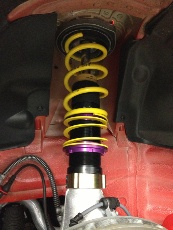

I have the KW's and ditched the 20's for 19's, and it is def low! No issues on normal roads, but I have to take some driveways and bumps in an angle. Also, keep in mind that the 911 tucks it's butt under WOT, and your headers are basically 2 inches of the ground.

I'll attach some iPhone photos as a reference:
