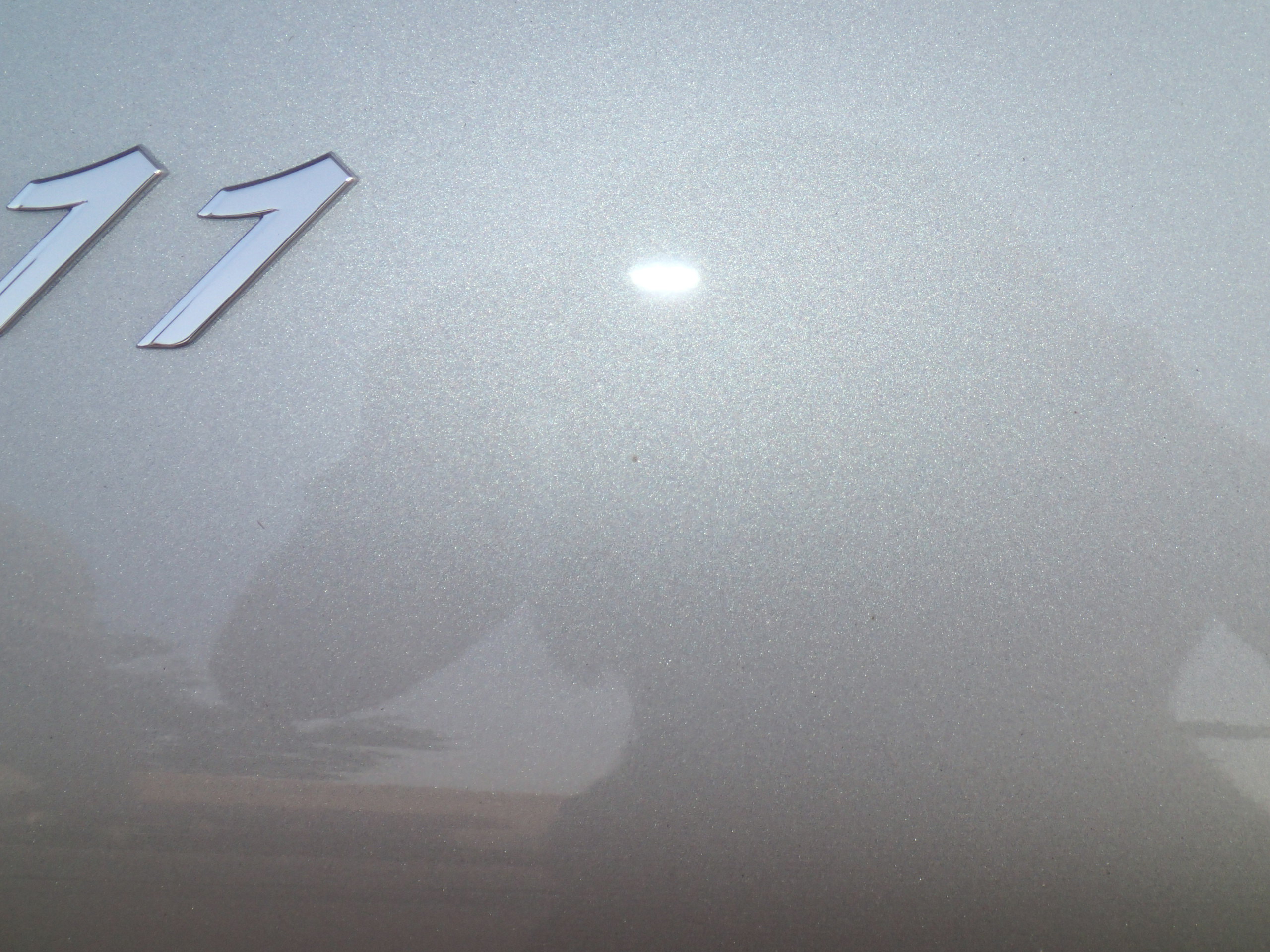

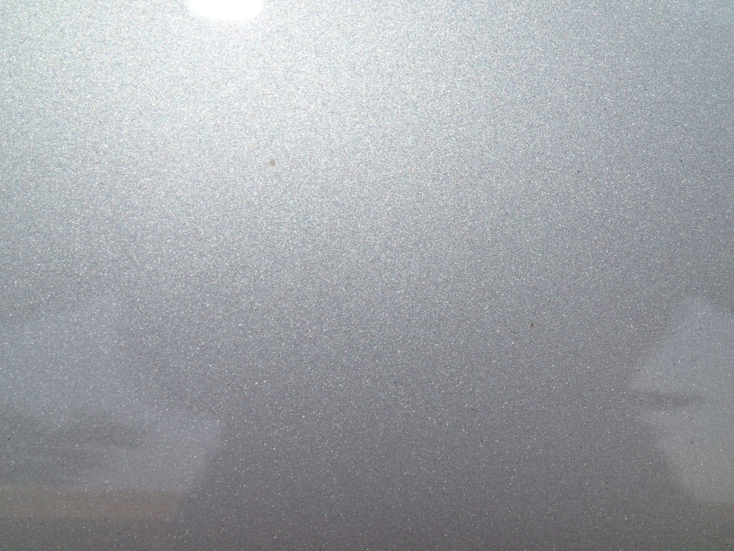

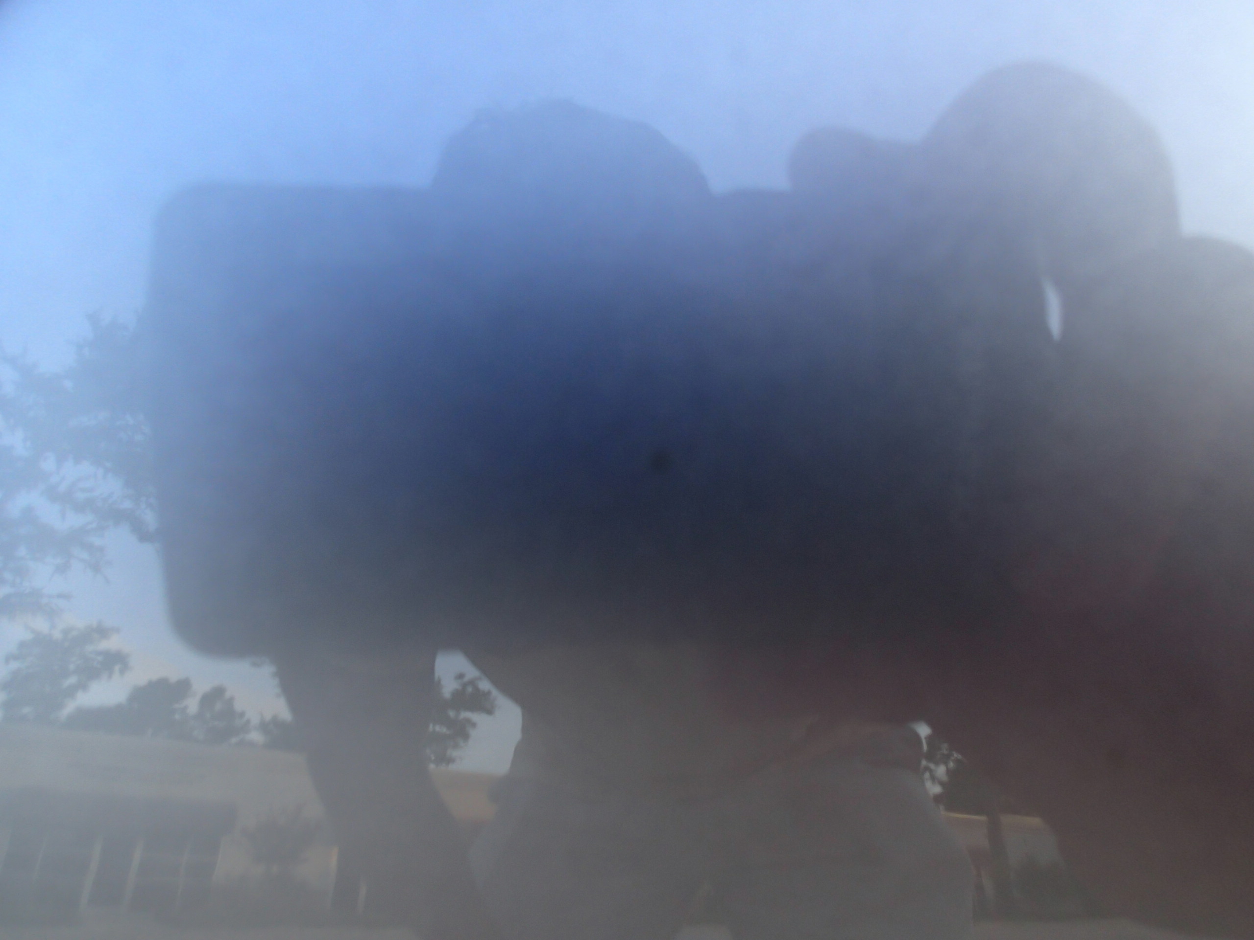

First Attempt At Uploading Pictures.
Not very good pictures, but hopefully clear enough to see.
Like everyone else on this thread, I have 8-9 off these small brown dots ("freckles") randomly on the rear bumper. I can't imagine I could have have missed something like this when I first looked the car over at the dealership.
Perhaps these are bleeding through the paint slowly, or reacting to something environmental (temperature?)

Update:
Hello all,
Went to the dealership early today for official evaluation of the "brown dots".
Service Manager and the Professional from the Porsche Authorized body shop concur that these ARE under the clear coat.
SOURCE...UNKOWN!!!
Service Manager was sympathetic with my obvious disappointment. I am now awaiting follow-up from PCNA and check with Reps. It is a beautiful car. The thought of having to "re-spray" my new car due to a factory defect does not immediately strike me as acceptable for the price paid, much less the additional $3,200.00 Special Color paint option.
Thoughts?
