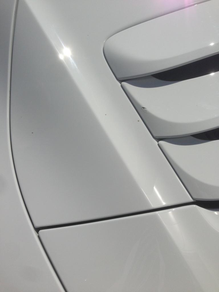

I have very small what look like brown paint "droplets" in clusters (five or six dots in total, almost like a blood splatter) running along the righ-hand side of my brand new Guards Red C2S. The first "cluster" is next to the headlight on the bumper, the second "cluster" is on the roof behind the sunroof panel, and the third is a very faint single dot on the rear fender near the window. From front to back, they run pretty much in the same line. The damage wasn't caught at the dealer because I would not let them detail it. Instead, I took it directly from delivery to my detailer and it was while we were initially washing the car that we found the damage. To be clear, these are not obvious and you have be looking for them. It is clear to me that all the dots are under the clear coat so how it wasn't caught at the factory is just plain unacceptable, period.
The car is currently at the dealership and they, along with PCNA, have been extremely responsive and helpful in getting to a resolution. PCNA has inspected the car and now a Porsche certified body shop is looking at it. I should find out next steps on Friday.
To say I'm pissed is the understatement of the century (just check my BP). I take what little comfort I can from the fact that I caught it after delivery rather than before delivery because at least now I know about the damage and have some input into the resolution. If the dealer had caught it before I took delivery, they would have done whatever and I probably would have never known.
Stay tuned for updates.

Same issue here with the mysterious brown dots under the clear coat plus small dent, but mine was in the engine lid and cover.
My dealer was nice enough to inform me but they wanted to take it to a body shop to fix it. I had a better solution....swap the parts with the one in their show room which was a brand new white C2S anyways.
Unfortunately in your case you can't swap parts, these things do happen and the only thing you can do is take it back to the dealer and have a body shop fix it. You are entitled to getting the car reordered though, that's if you are willing to wait.

Armin, mine look almost identical (trying to post pic)... Did they ever determine what it was? I believe it came from something above the car while it was moving along the assembly, obviously somewhere after the paint was applied but before the clear coat was applied since they all line up if you draw an imaginary line from the front of the car to the back with the worse impact (most dots) on the front bumper, less on the roof, and only one on the rear fender.

If anyone in SoCal has this issue, please stop by our shop. How certain are all you guys that it's under the clear? Have you tried claying and polishing that area?

Claying did not remove them... Detailer tried menzerma (spelling?) which didn't work either... That's when I said I'd take it back to the dealer... Body shop is now trying to wet sand them out...
