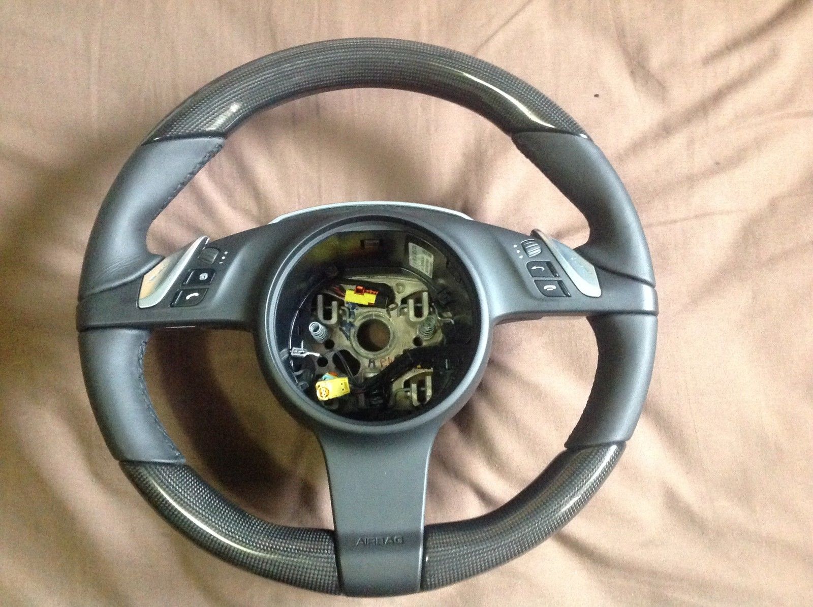

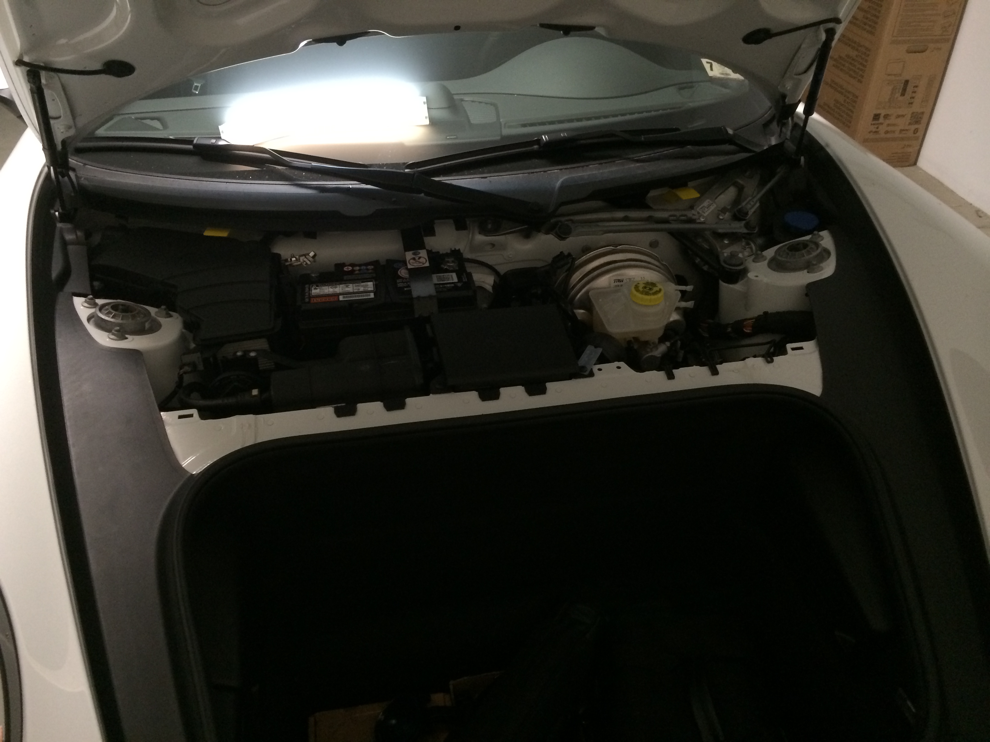

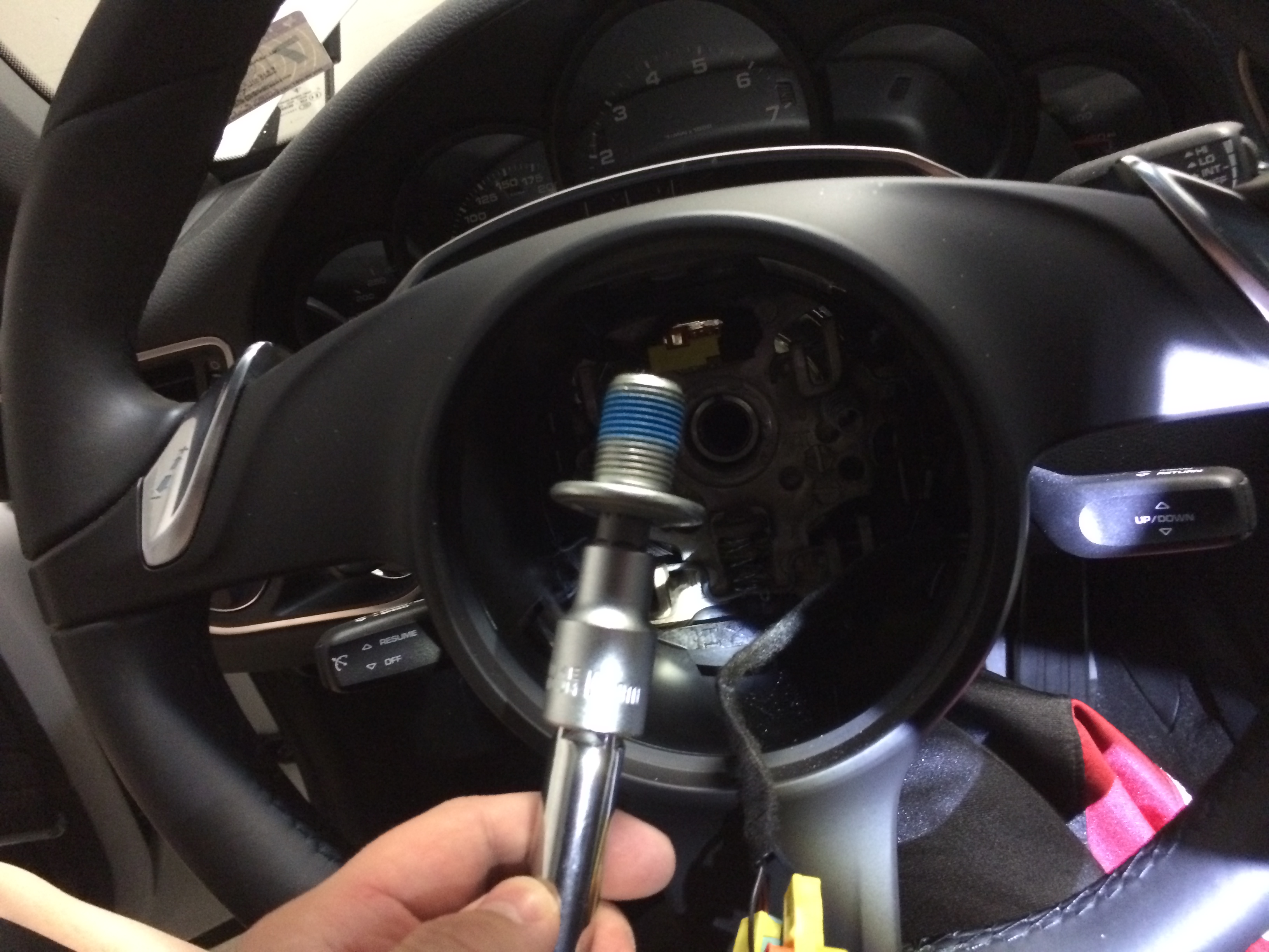

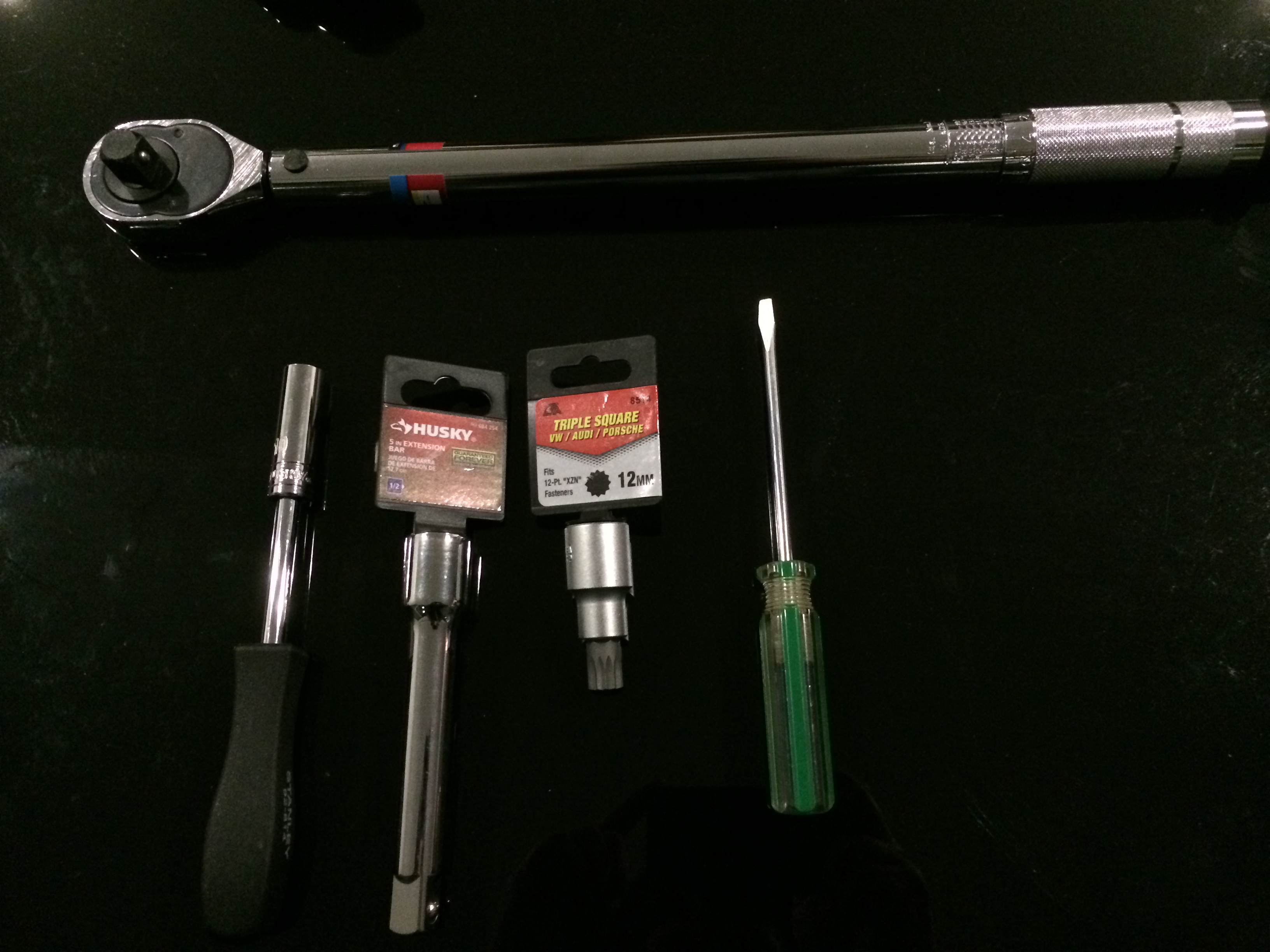

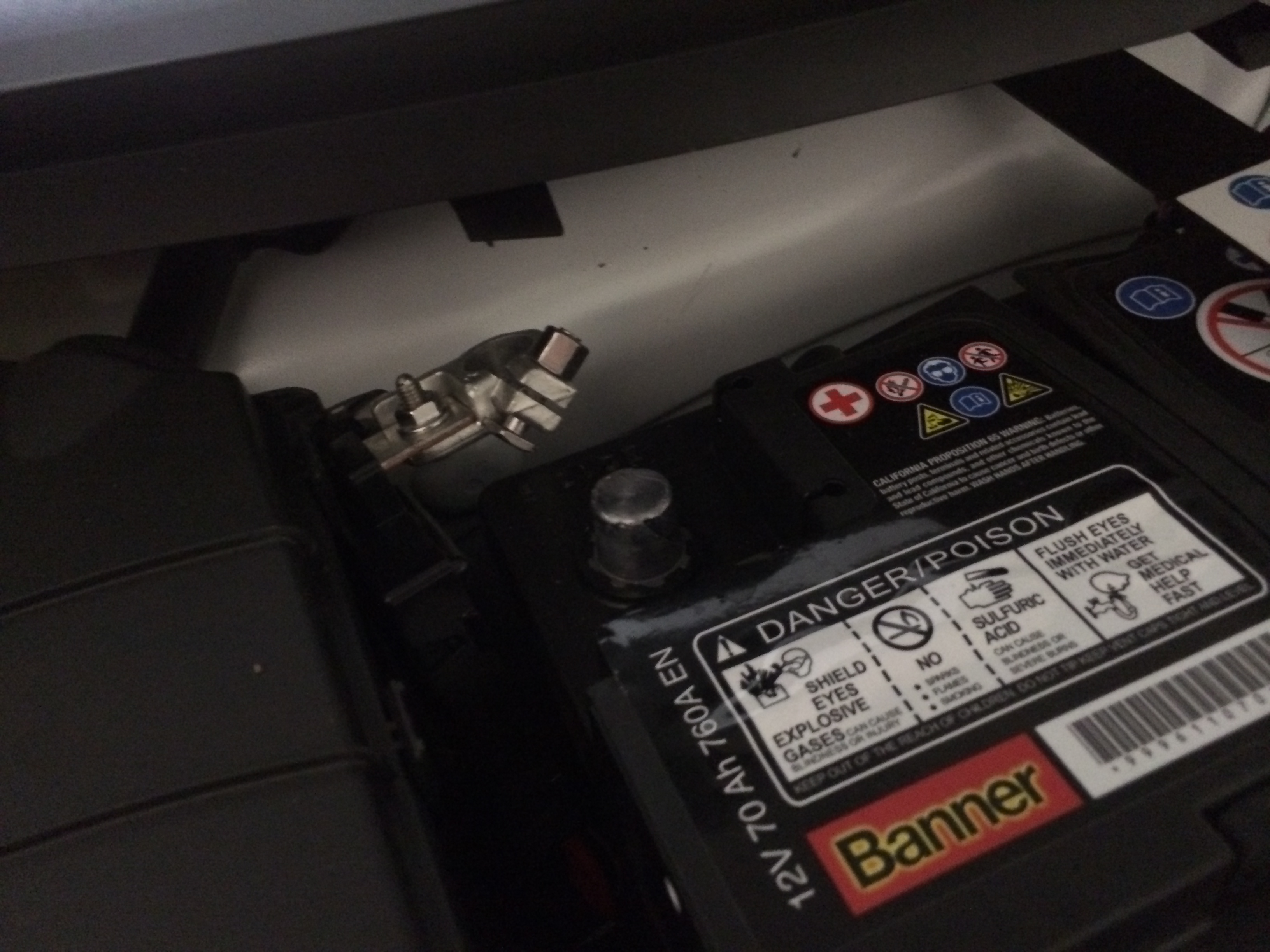

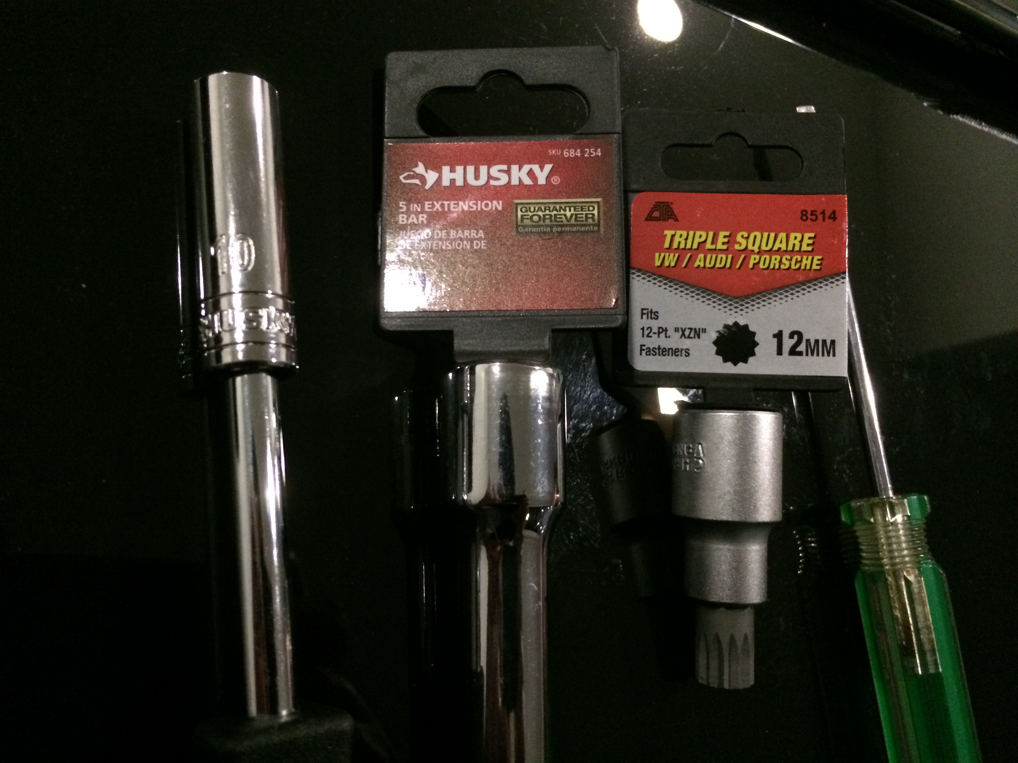

Originally Posted by AoshichanX
Got my steering wheel today.
You will need:
  1. Thin Flathead
  2. 10mm Socket
  3. 12 Point Triple Square Socket Bit 12mm (I got a 1/2" drive)
  4. Drive Ratchet + 5" Extension Bar for Ratchet (mine was 1/2")
Steps:
  1. Pop your frunk.
  2. Remove the frunk liner.
  3. Battery is exposed now.
  4. Use 10mm to disconnect battery.
  5. Pop airbag through hole on the bottom.
  6. Make sure to position to flat head as shown and just push it straight up.
  7. Airbag will pop out very easily.
  8. Disconnect airbag from wheel.
  9. Use 12point 12mm to unscrew bolt.
  10. Pull steering wheel off.
  11. Put new steering wheel on.
done...
Attachment 313052
Attachment 313053
Attachment 313054
Attachment 313055
Attachment 313056

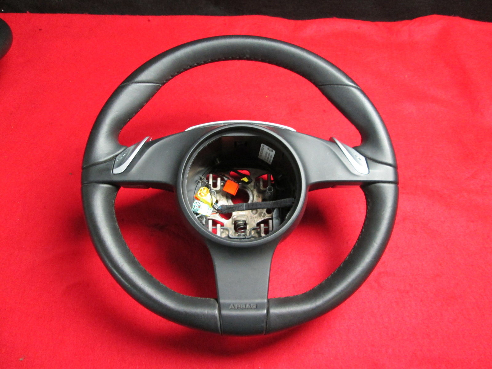

Originally Posted by galion
no need for dealer reprograming?
Hey if you have a multi-function steering wheel (with the buttons and stuff), you will need programming. If you don't have the multi-function steering wheel, and you use the stalk to control the settings then you won't need programming.
Multi Function (needs programming)
Regular PDK (no programming needed)
